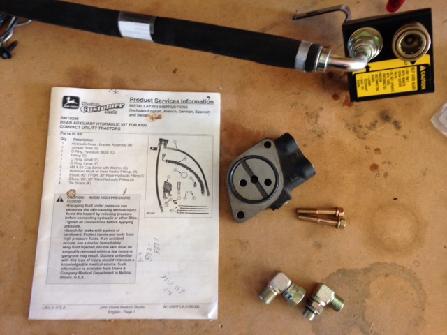

I installed a power beyond kit on my John Deere 4100 and found out while doing so that the main adaptor plate was already in place. I bought some different hoses so I'm left with most of a factory power beyond kit for a JD 4100 if anyone is interested. Message me if you would want the kit parts and installation instructions.
