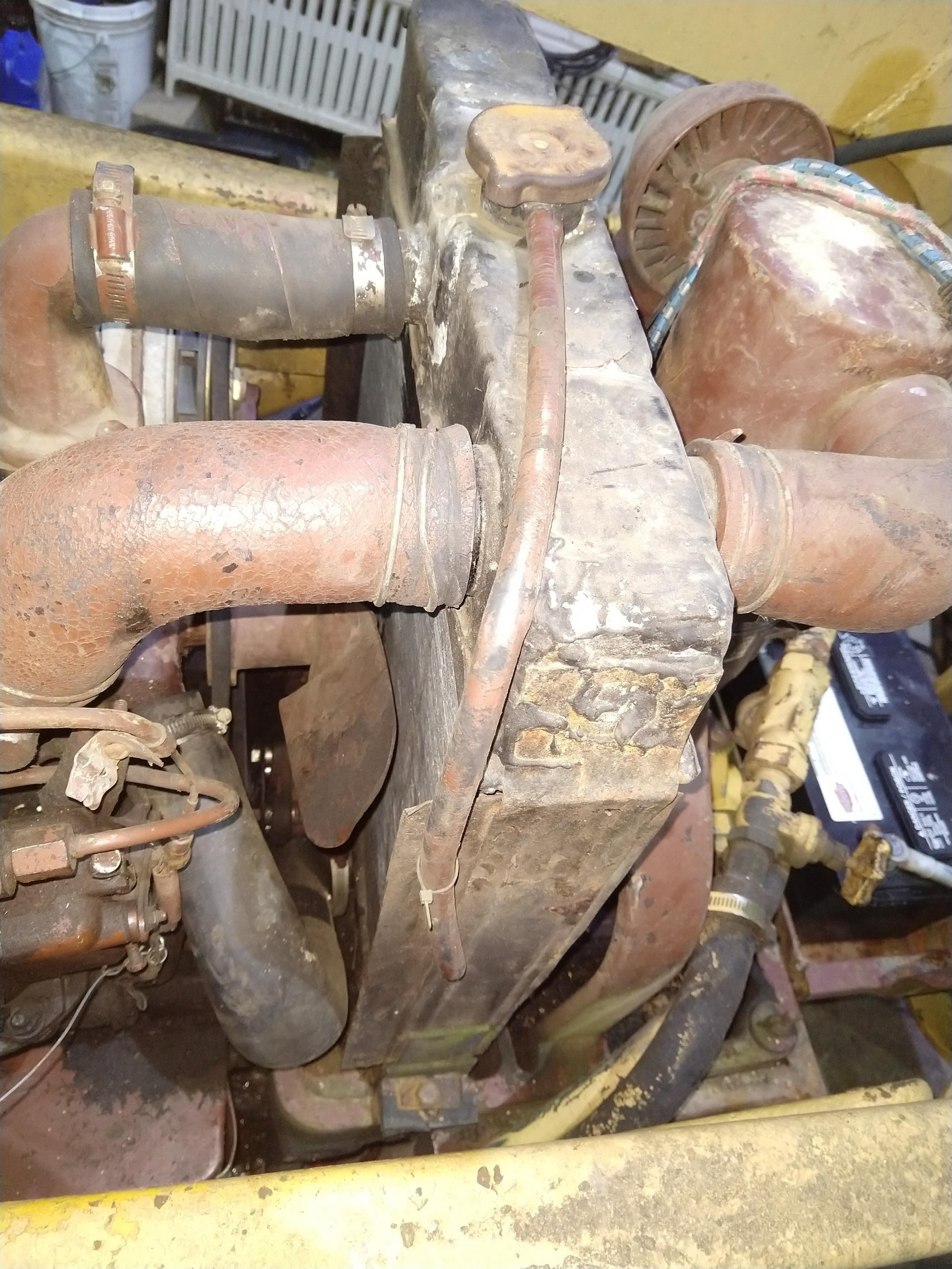

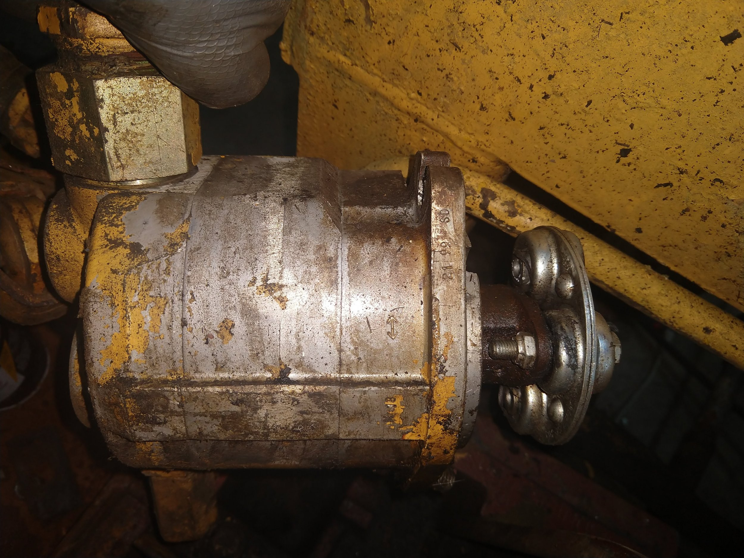

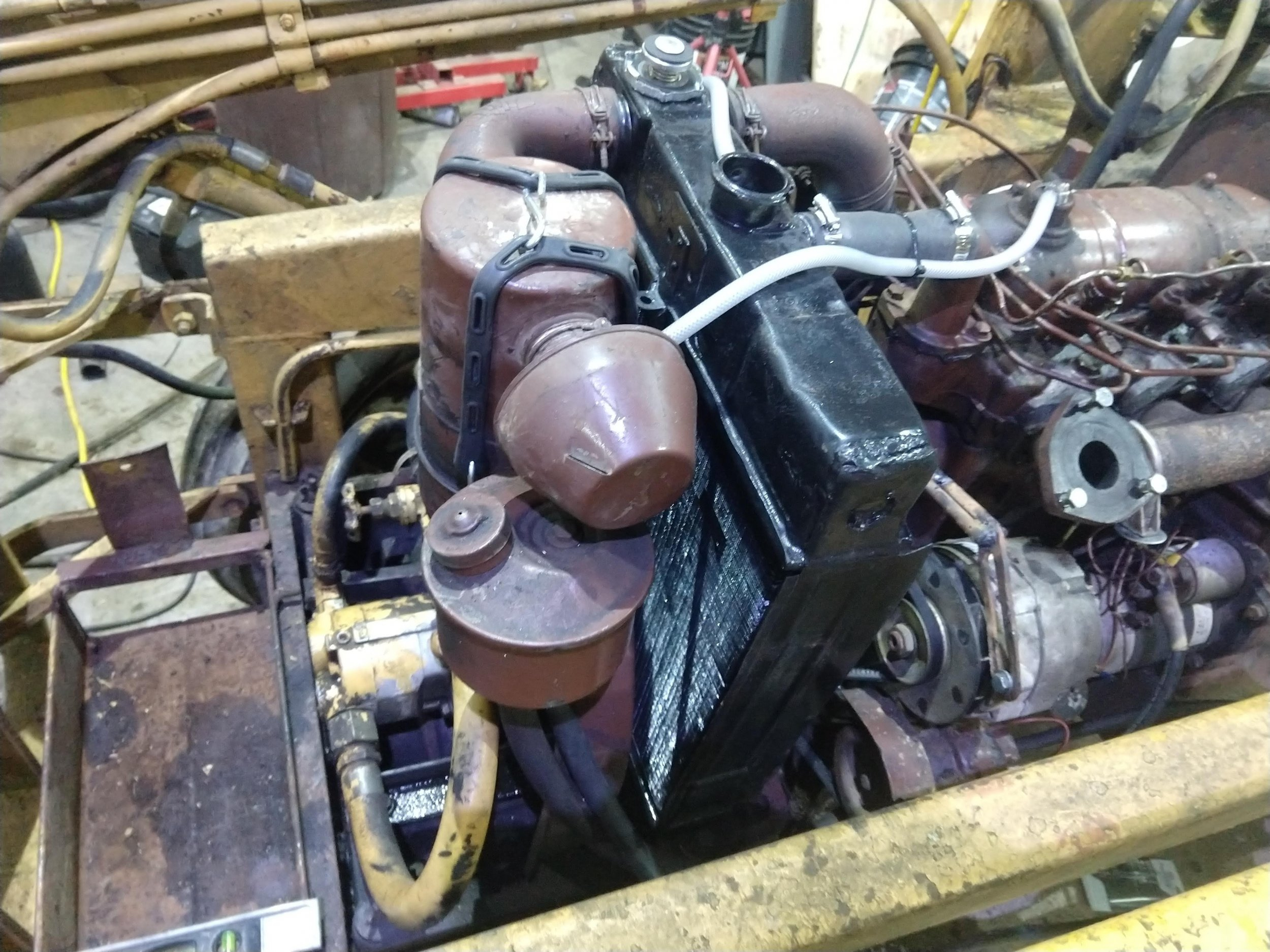

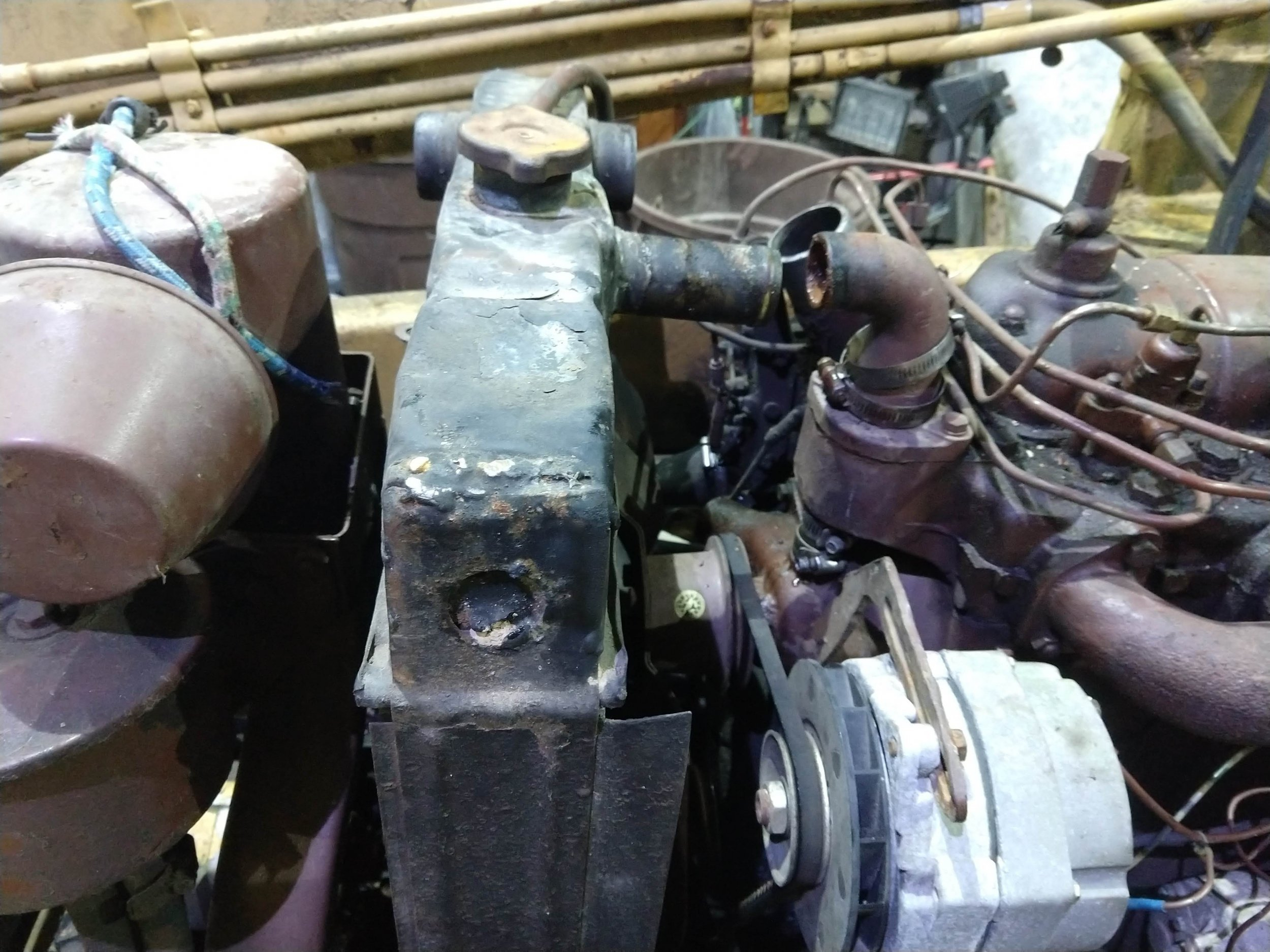

Am I seeing those photos correctly? It looks like the air cleaner is plumbed to run through the radiator!A couple of pictures of how the front pump was setup on a David Brown that I had for a while.
The shiny bolts at the bottom of the radiator in this picture are where the driveshaft was bolted to the crank pulley:
Overall view of the pump in place:
The misalignment coupling on the pump:
Thought I had one of the pump driveshaft, but I dont see it.
