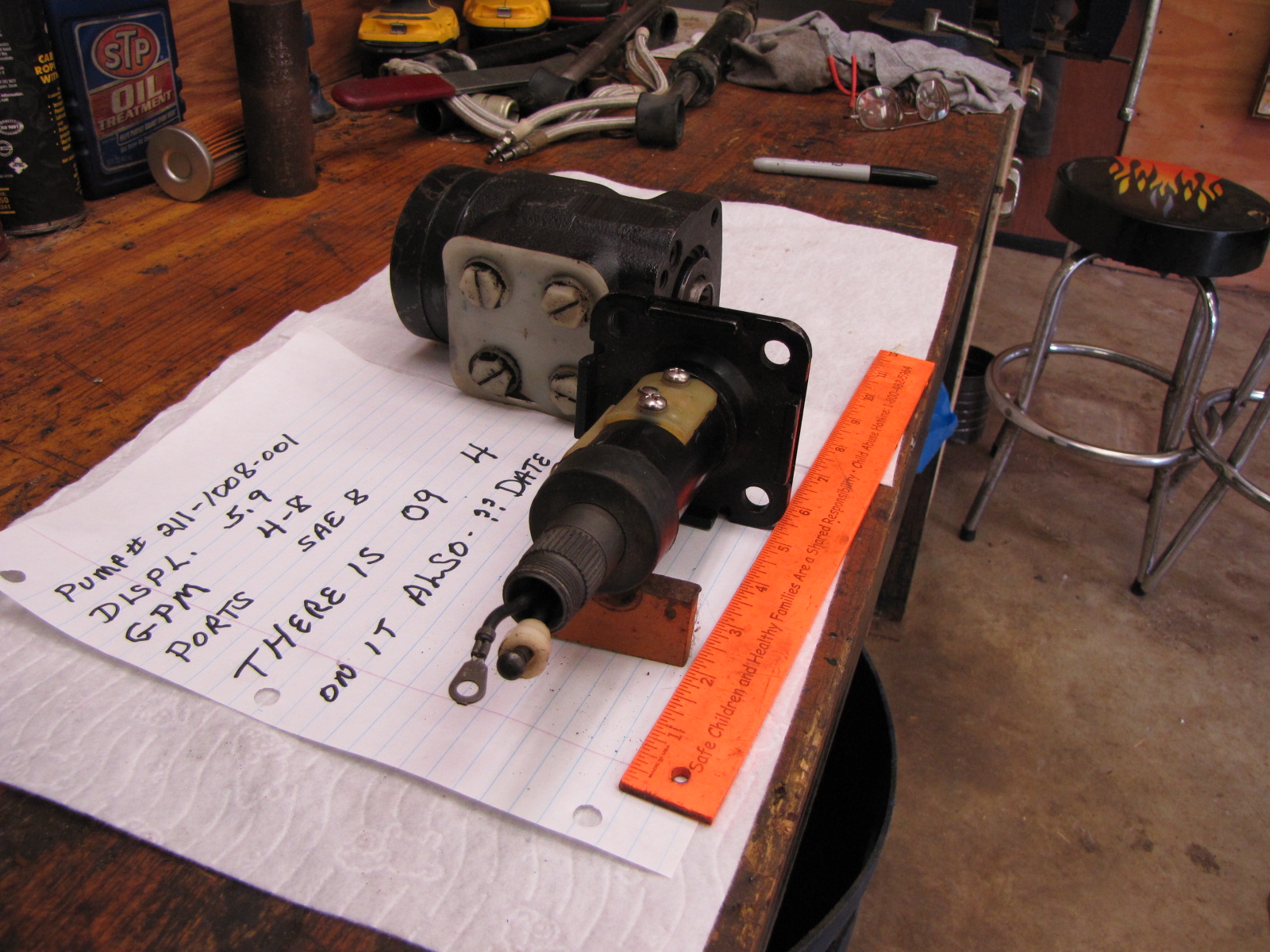

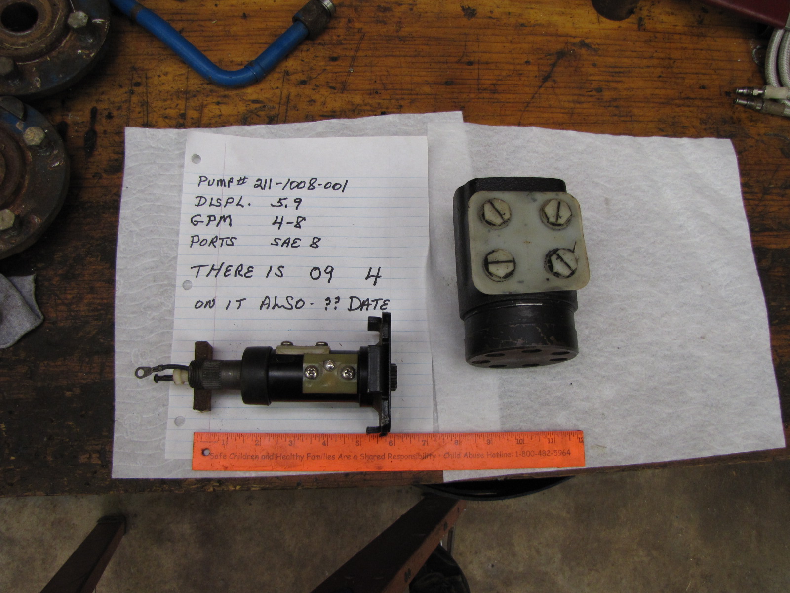

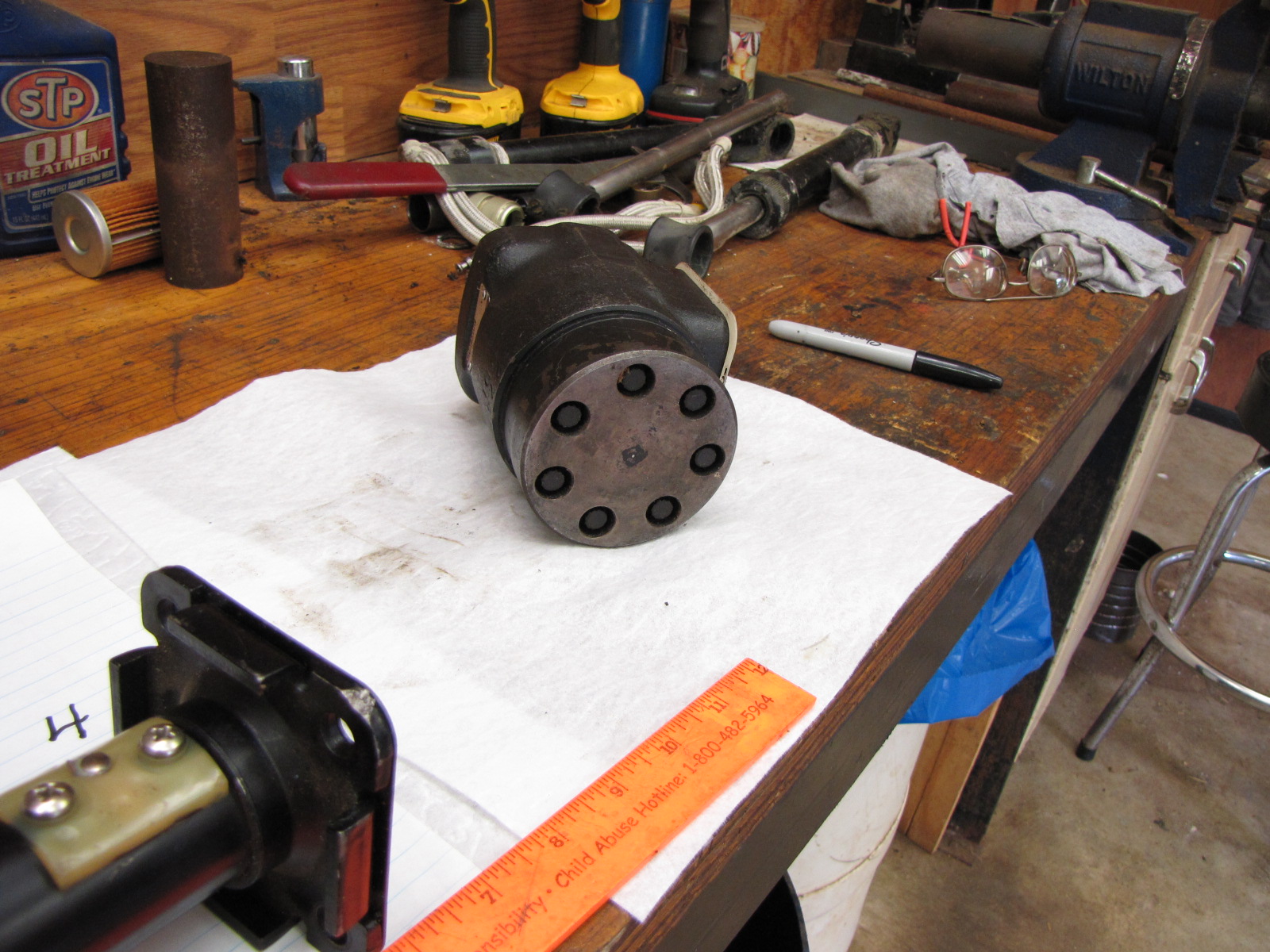

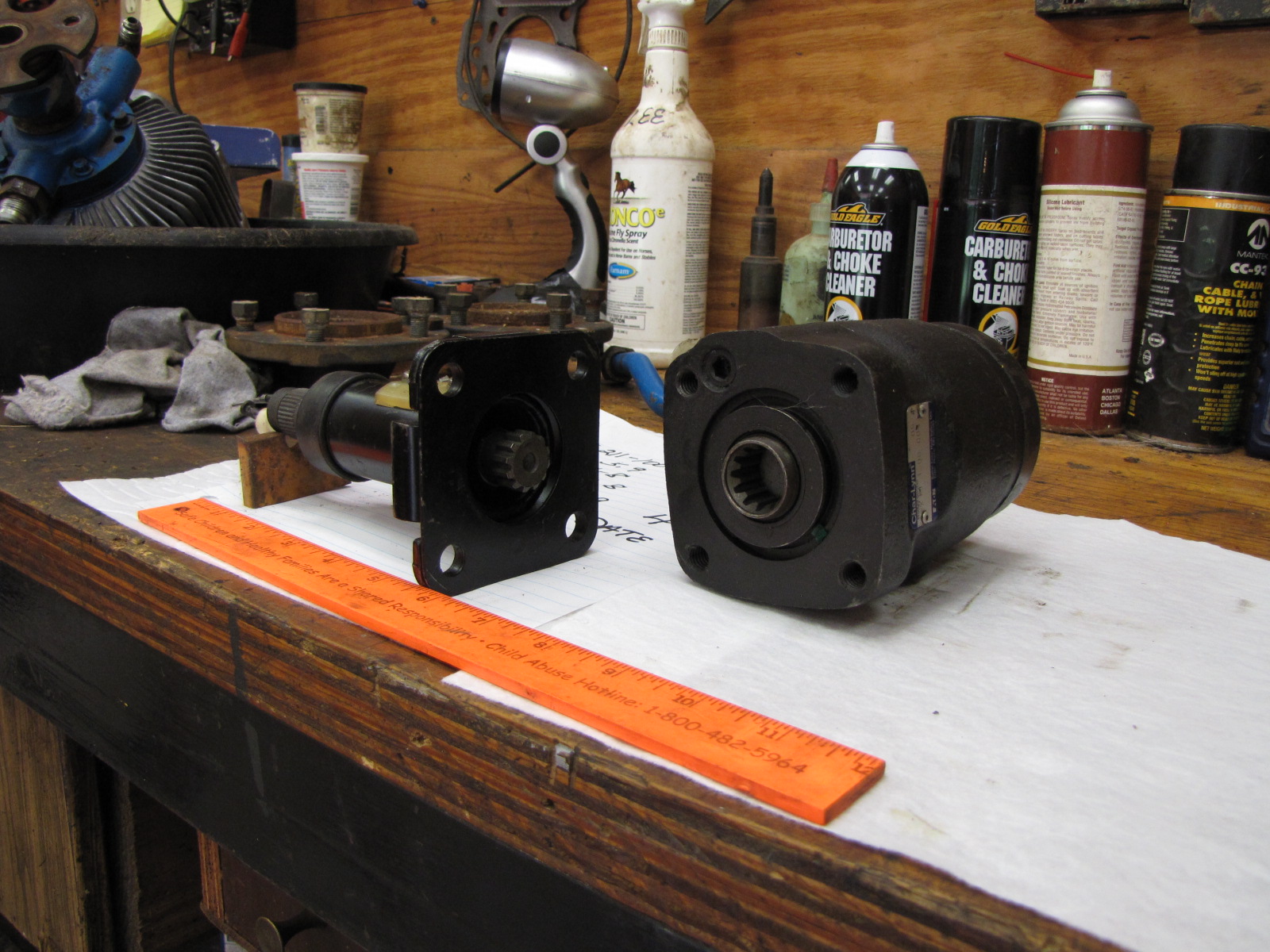

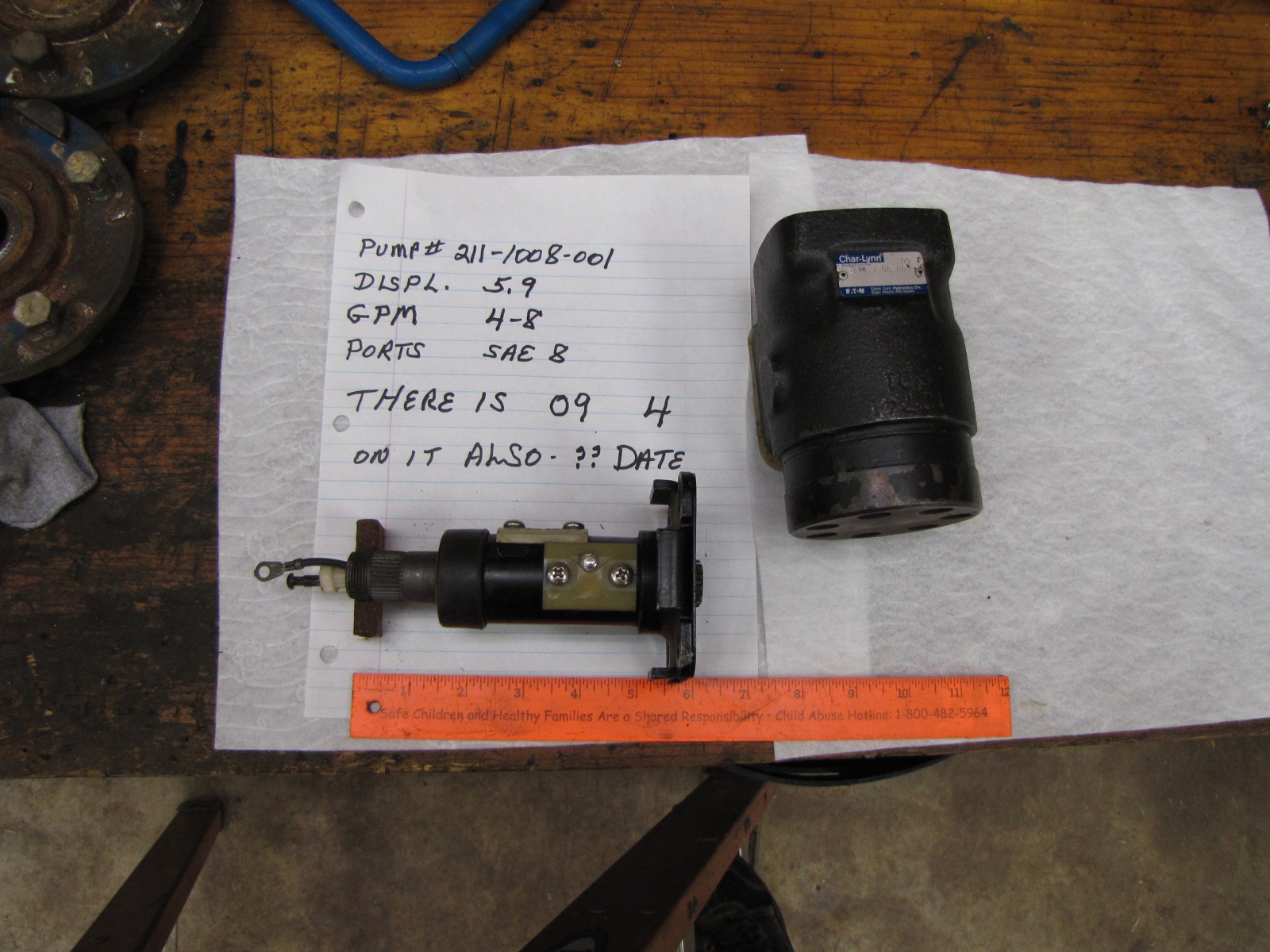

/ Adding power steering #6
This is it, I think the unit is new and the paint is off of the bottom I think thats from being move so much on the shelf. If after you see the pictures and you want ask more ?? I'll email you my phone #.
I looked that number up on that valve, and that's a very good deal on it, and that's not even figuring the the cost of the steering column. I appreciate the offer and I did some more figuring, and I think I am going in a different direction on it. So if anyone else wants a good deal on a steering valve you had better get it, those things are expensive.
