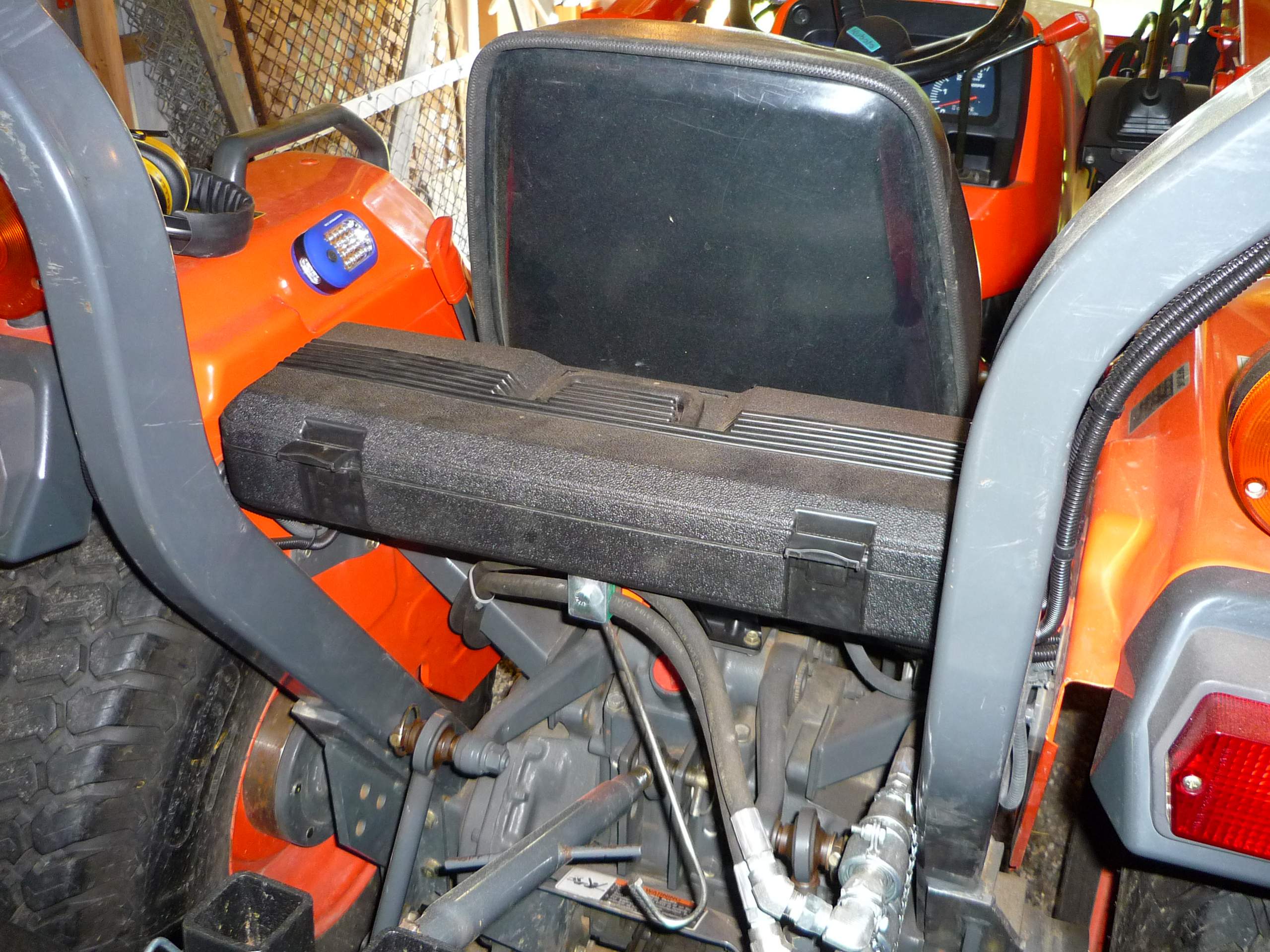

This is an interesting topic, with no clear cut answers, and a lot depends on personal expectations and desires. I don't know how comfortable I would be piecing together a third function system, but I think I could do it. A factory kit would be less stressful, and probably neater? Having the plow control at my side is not an issue, but then, how often do you have to move it?
My L3400 came with a rear remote, and here's how I ran hoses to the front loader arm for my plow cylinder. Surplus Center had everything I needed, for a fair price, including the specific mounting blocks. The photo gives you the concept, anyway- 90's out of the tractor's fittings, with 45's to send the hoses on their way to the front.

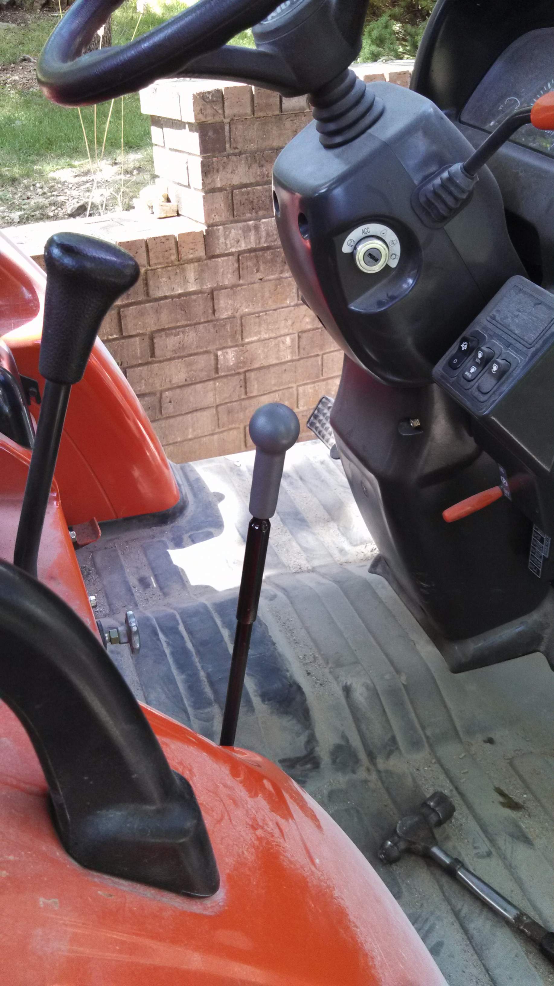

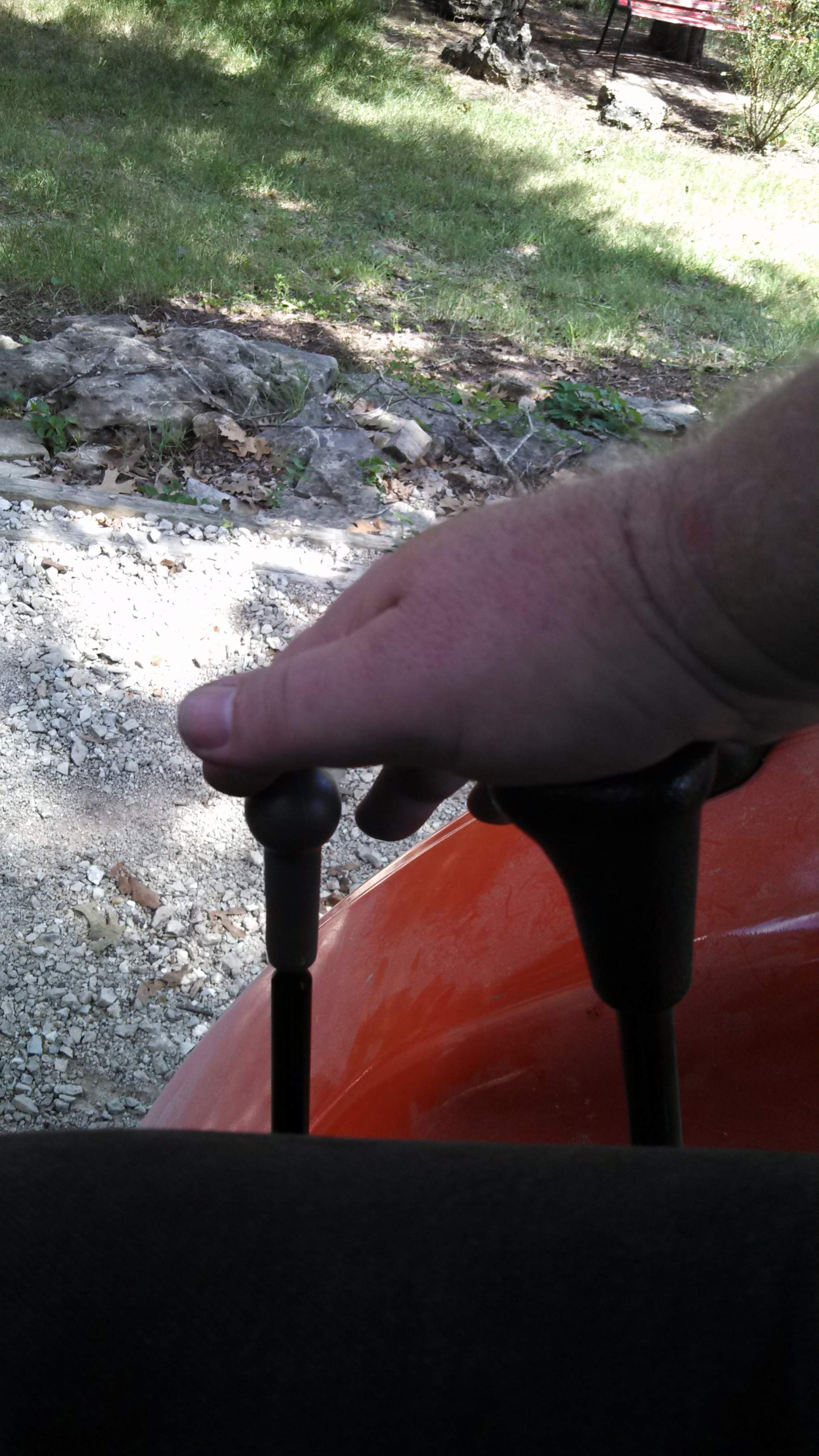

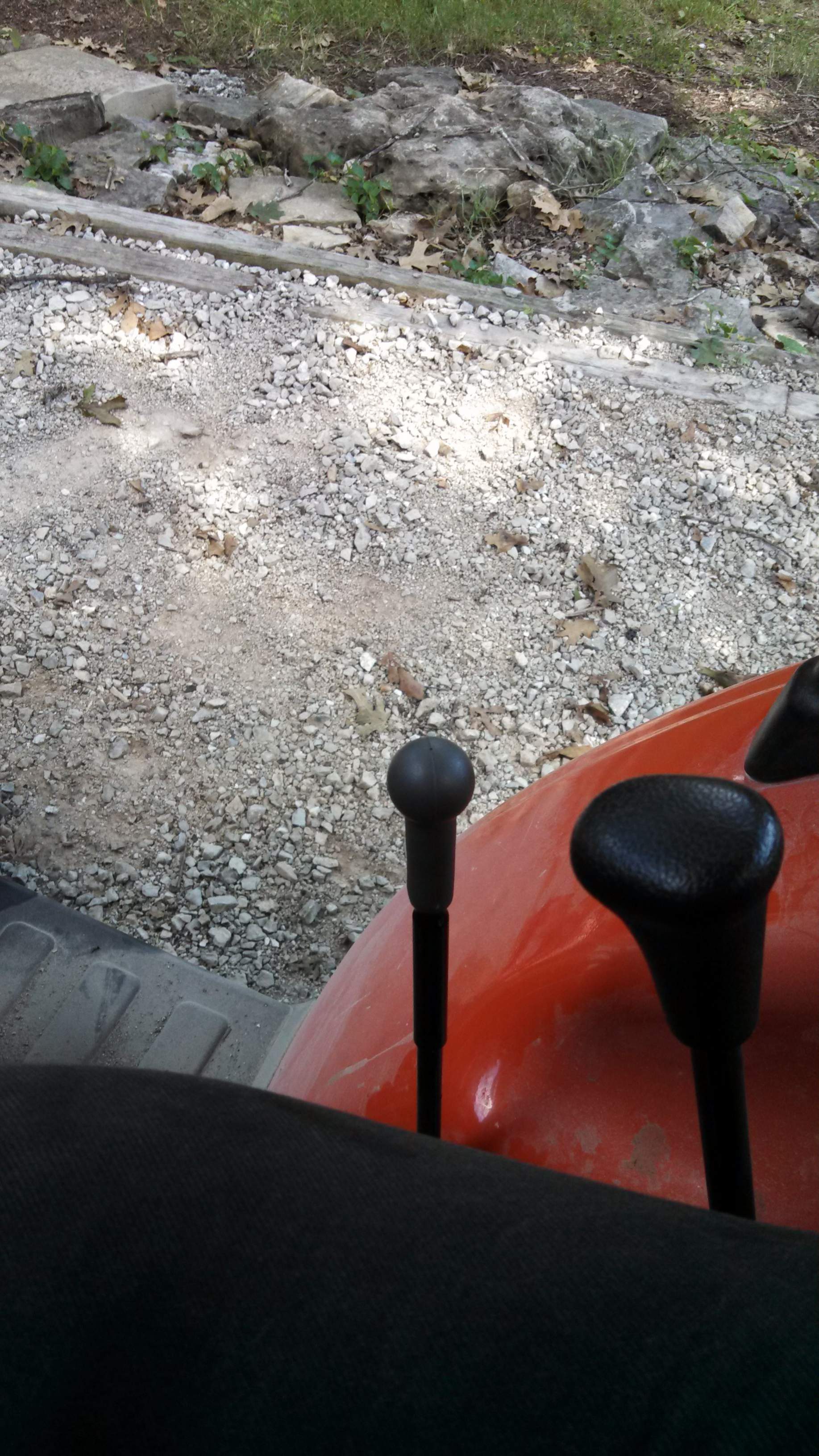

Not that far no. I operate mine on my Kioti all the time, but it is convenient to operate. :) I could be wrong of course about the 18 inch reach being a PITA. But then I think changing gears and clutching is a PITA too. I used to do it all the time, everyday. But anymore, the older I get, I seem to be always looking for convenience and ease. :eek: I lengthened the lever on my rear remote so I did not have to drop my hand down.installed 2.jpginstalled 1.jpgin use.jpg
