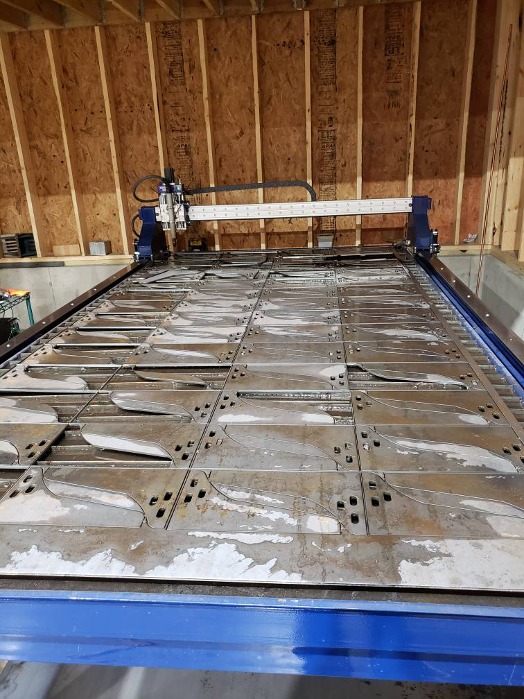

Holy cow. Nice job. I have a plasma table also. Sure makes custom fab easy. I think yours does a better job on bolt holes than mine does though. I usually have to run a drill bit thru afterwards as I get a slight slope on really small holes.
the thicker the metal, the nicer my cuts.
still, with all the parts and hoses, must have cost some $$$$

What plasma table do you have? I'm still getting mine dialed in on holes. There a little taper on the smaller ones but not bad, I just oversize the holes slightly to compensate.
Mine is a Precision Plasma LLC, gantry kit running CandCNC Linux CommandCNC with a Hypertherm PM105

I have a Dynatorch 5x10 table And a hypertherm powermax 1000 torch system.

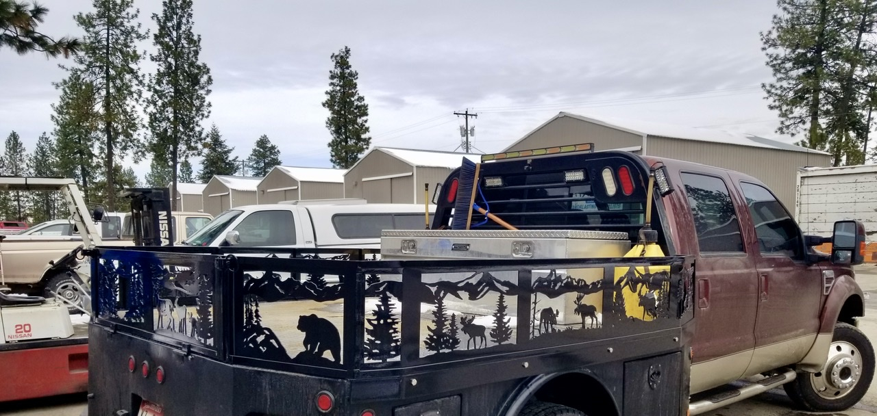

the Last project I did was a side rail system for a flatbed truck. The design work and planning took twice as long as the job. Designing a latching tailgate really took some time.

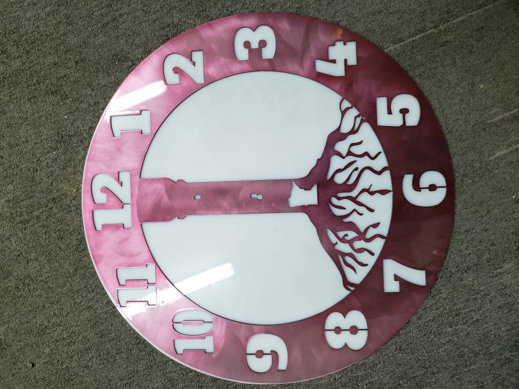

My artistic side isn't really there yet, so far I stick to light production parts, mostly for trash trucks (the reason I have the table).
One day I hope to get better at the artistic drawing stuff.
I cut this out for my friends wife, she drew it up.
Most of the time its boring stuff like brackets

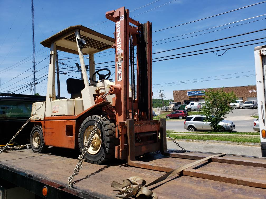

I see your little Nissan 20 in the pictures, I have its bigger brother a 50 diesel.

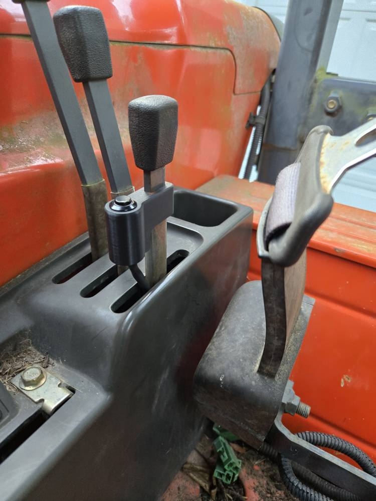

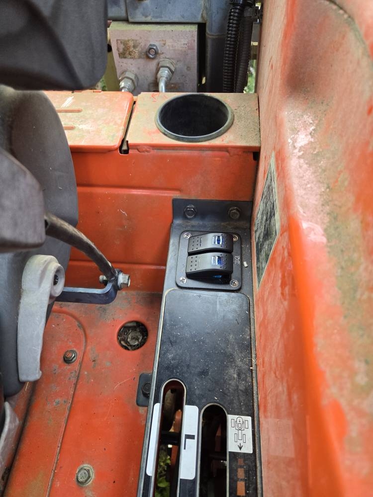

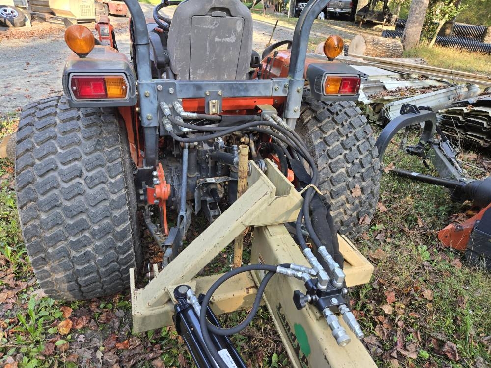

I finally wired up the diverter valve, only took about 3.5years. I was able to design and print a button mount that attaches to the lever. The button is a push to lock/push to unlock and has an indicator that lights up when activated.
I hid the relay and all other wiring under the range selector cover along with the switches/wiring for the work lights.
It'll be nice to be able to fully run my rear blade now, the one remote is always attached to the top link so I have a manual diverter on the blade for the gauge wheel.
