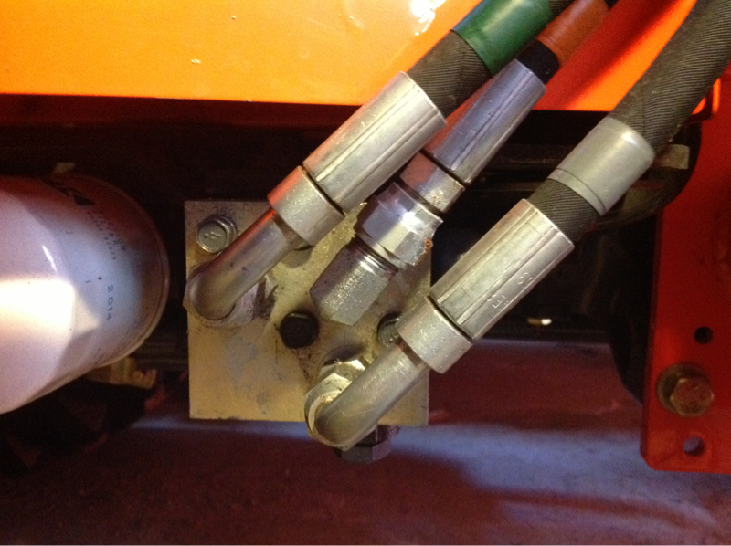

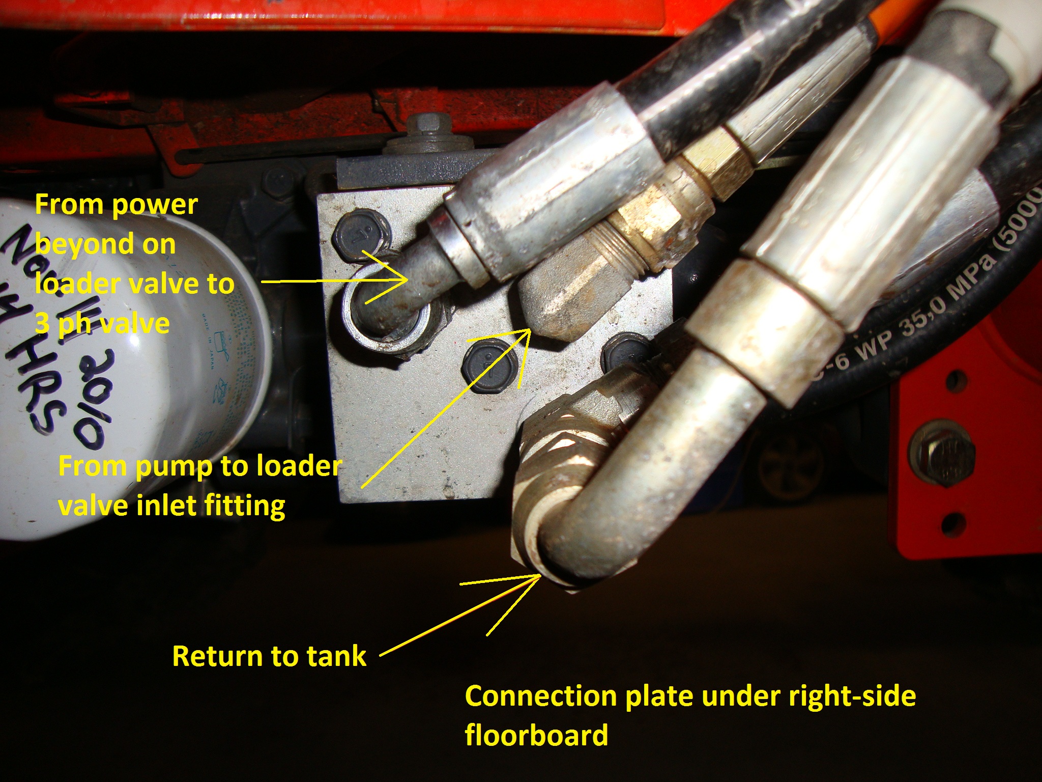

If your hyd block looks similar.
If not, there are ways to connect things up in a logical order.
Show us some pictures of your hyd block.
What type remotes are you wanting to install?
How many spools?
L2800 hyd
Hydraulics:
Type: open center
Capacity: 7.3 gal [27.6 L]
Valves: 0 to 3
Pump flow: 6.8 gpm [25.7 lpm]
Total flow: 11.1 gpm [42.0 lpm]
Steering flow: 4.3 gpm [16.3 lpm]

Yours is the same and well be plumped the same. Real easy to do. The hard part is where you want to mount your valve.
   / Rear remotes #27
Looks like I have the same block. I will be paying attention.
L2800 w/FEL - 72" Land Pride rake
From what I remember the green one is Power beyond, and you take it loose, and put it in the input of your valve stack and the output/PB of you valve stack goes back to where you just took the green fitting off of. and the tank gets "teed" into the gray one. Like I said that is what I remember, but don't quote me:)

Save this picture in your picture folder.
The Kubota tech at Kubota dealership told me that a good many tractors use that configuration.
He said there is also another way to connect additional ports, but I will have to check on that setup.
If only the manufacturers would show a hyd diagram with every tractor, it would be a big help in figuring things out.
