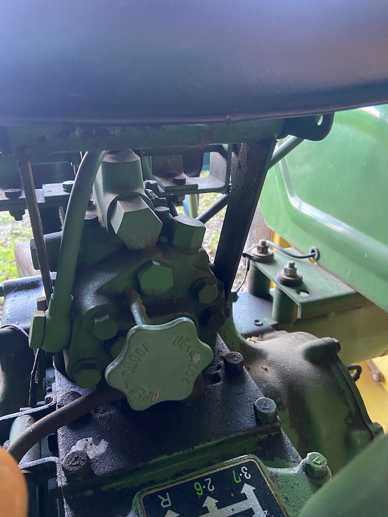

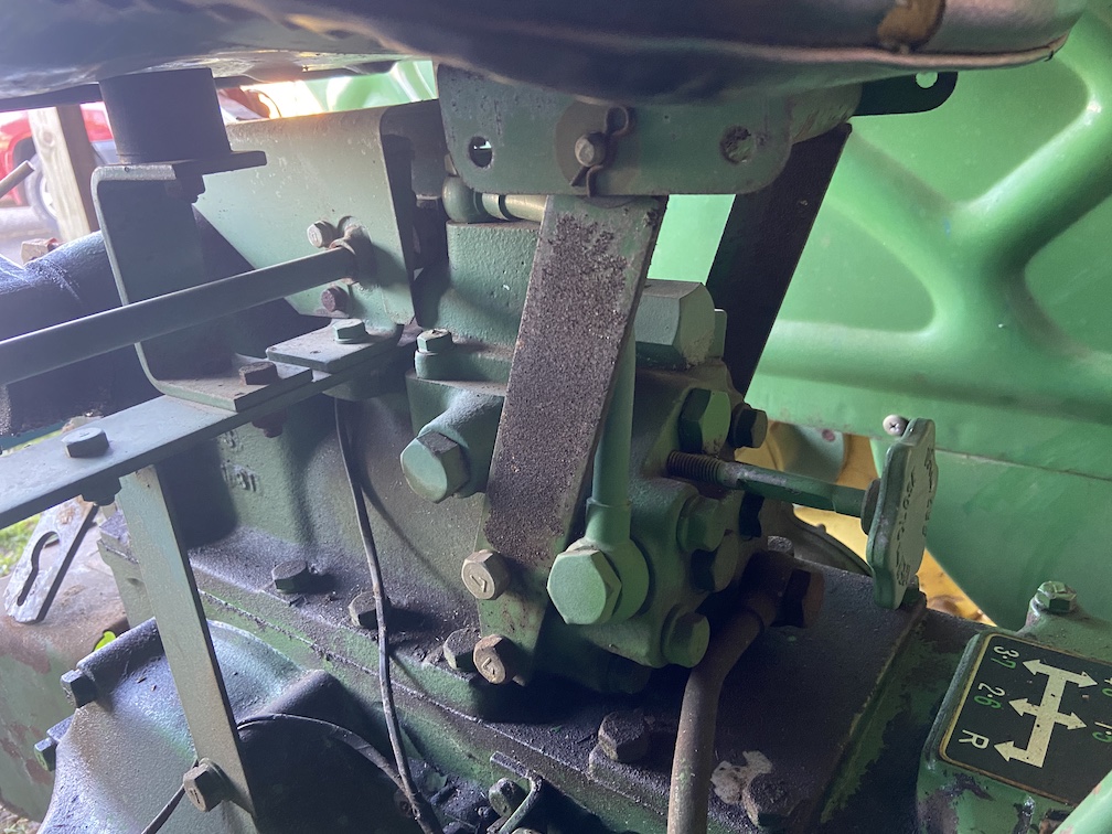

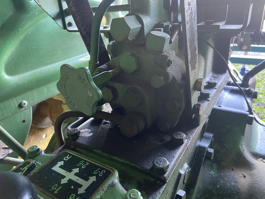

I have a JD950 (Yanmar) without hydraulic remotes, just a 3pt hitch, no loader. What would I need to add two sets of remotes. Here are some images - click on them to enlarge. Thank you

I have attached the instructions for installing the john deere kit, which is not available anymore unfortunately. You may be able to find parts used or you could plumb in a valve of your choosing as long as it is for an open center system. If you have a lower serial number than 12000 you have some differences.

The only practical way to do this is to buy the complete system off a salvage tractor. Probably easier to just buy a different tractor. What are wanting to do with the remotes? If you are wanting to add a loader you may not be happy without power steering and 4WD.

That PDF JD110 sent is a great resource. After looking at the layout it looks like it could pretty easily be done using aftermarket parts. From what I can see you are just removing plugs and replacing with lines. I'm willing to bet if there is a hydraulic shop in your area they could rig you up with something. I know you could get all the parts likely off surplus center it would be a matter of just getting the right style of fitting.
