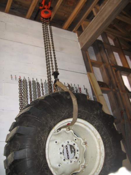

It sounds as though you are headed in a different direction...at least for now.
but wanted to say that we I did get around to installing the 2nd and 3rd remote on my TC48 recently I was extremely glad I had put in an overhead hoist ($70 chain hoist on I beam) earlier. It made the tire moving a non-issue.
