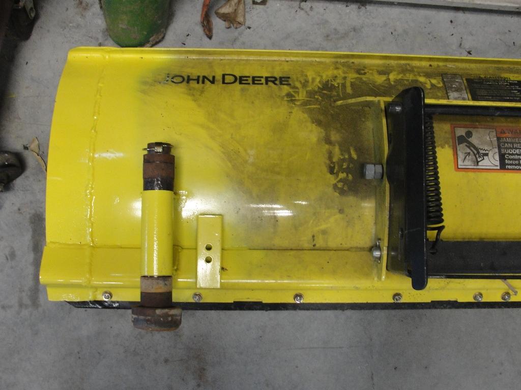

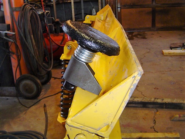

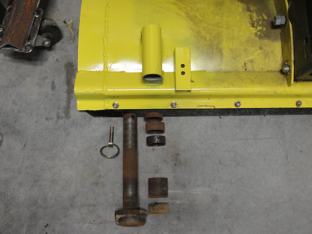

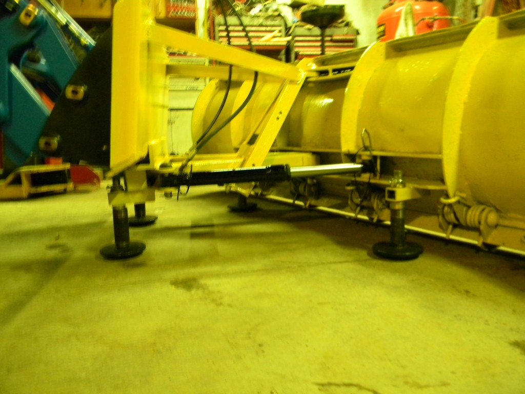

You can order shoes and weld on holder for your plow.
Fisher Snow Plow Shoes
My plow is a Diamond and uses a slanted shoe that mounts into holes in the trip edge. They were too expensive so i added my own mount and std. vertical shoes.

Much smaller scale, but same philosophy applies. You can build your own shoes and brackets. Just hafta think thru it.

I built shoes for a Meyer blade that I adapted to fit FEL or 3pt. They work very well. Probably have a 35 square inch surface. Anything less and they dug in as well. Takes a lot of surface to carry the load of a snow blade on soft ground. Sorry, I can't find any pics of those. They were built on the same philosophy as the ones I posted, only the skid surface was rectangular and the swivel location was offset so they would always turn the right direction. Have a "ramped" front edge to help them stay on top.
