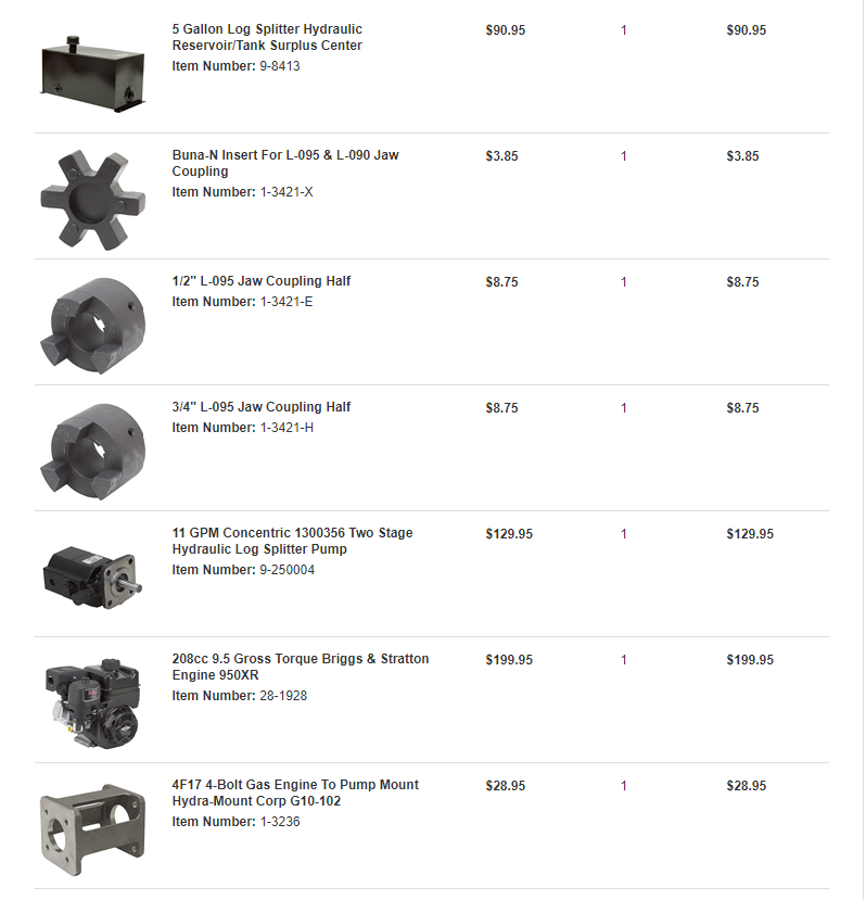

Thats why I junked the electric crap and put a good gas engine on mine with a BIG hydraulic pump and valve! No more screwing around when I go dump a load, and anybody can pull my trailer and dump it with no problems! lol!
This is the answer. I spent a few bucks, but I have a reliable system. Everything came from Surplus Center.

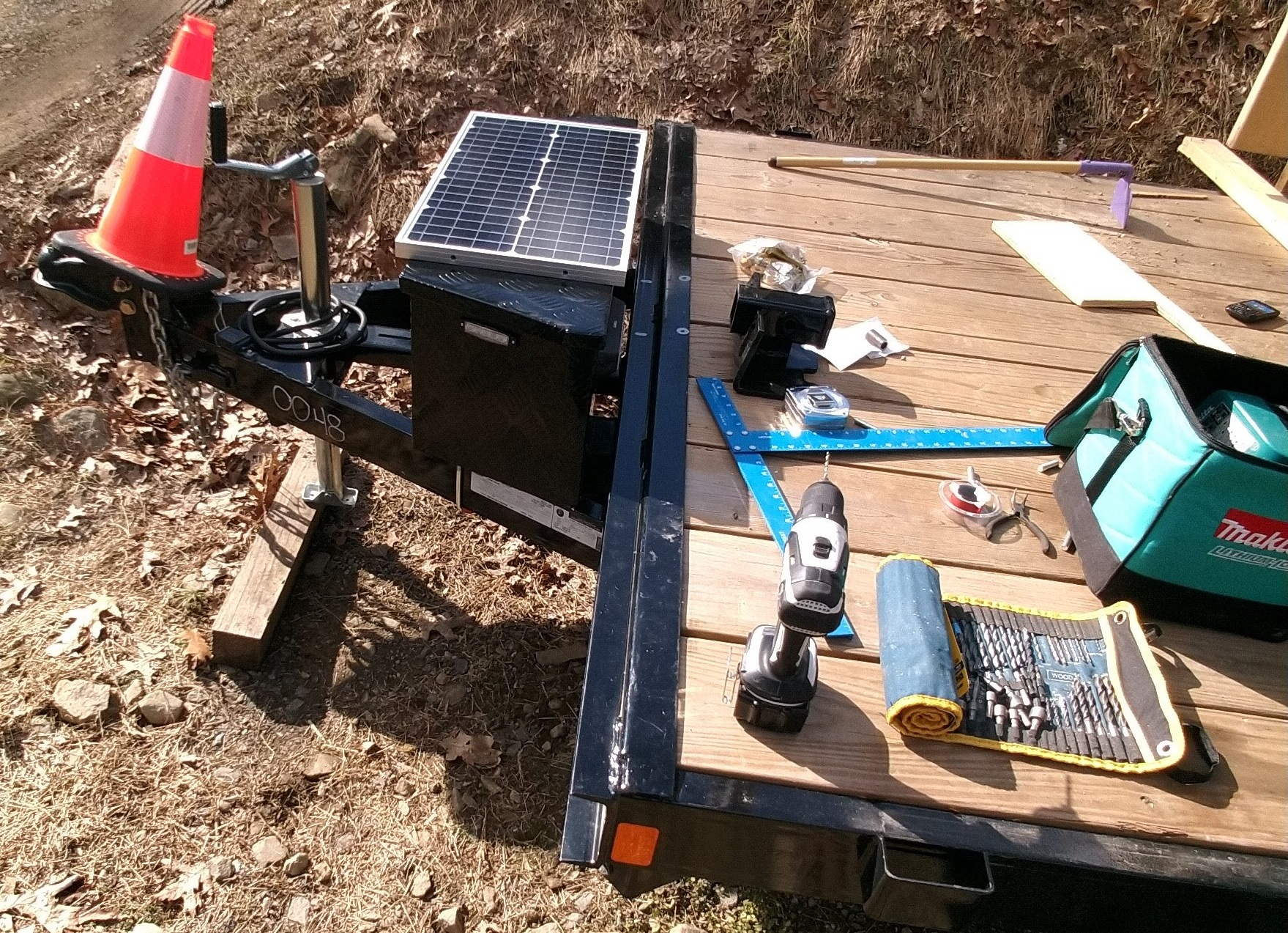

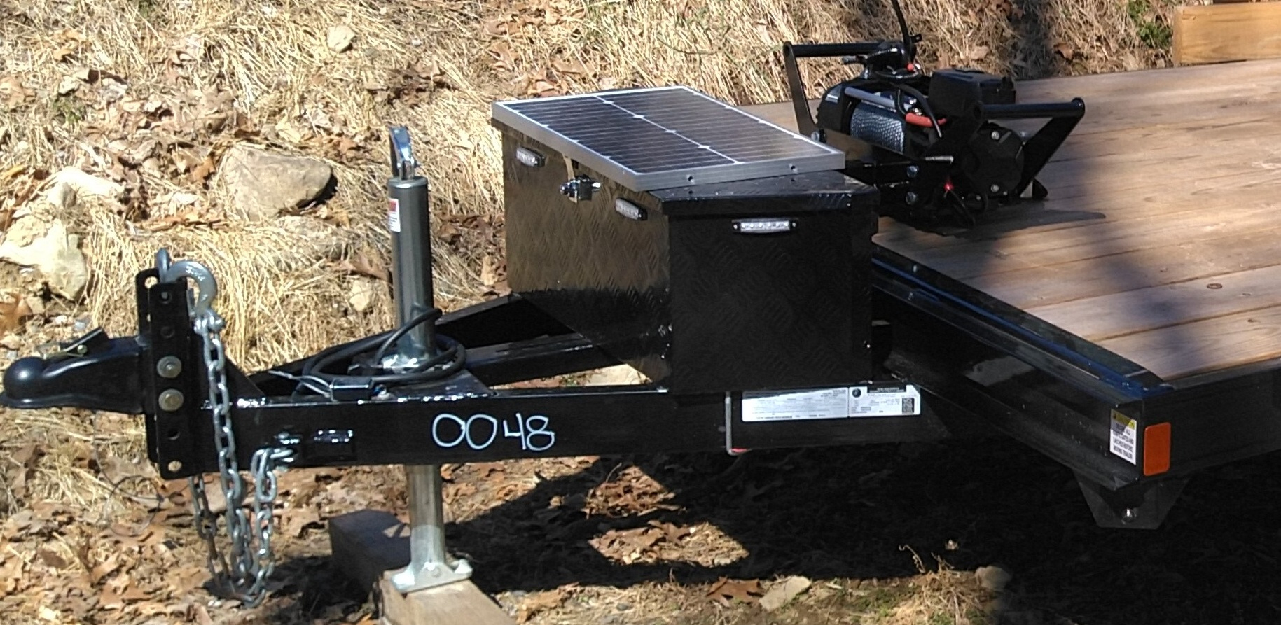

I put a 10 watt panel on the equipment box lid of our 7k dump trailer using a 3 amp controller for the battery connection. It's been about 3 years now, no problems & battery has always done the job. The panel & truck have been the only charge sources since the panel was installed.

I went to "The Large River" online store and bought a bunch of goodies for mine. Solar charger and controller, plugs, 110v receptacle, trickle charger, and even lights! How often do you hook up trailer in dark and need to put a cell phone on the top of the tailgate shining down to make sure everything is connected? Sometimes I pick up my trailer after the day job and this has been very handy. Mine runs a winch but the overall concept is the same. I also added a LED voltmeter gauge on the outside that displays the current battery level without having to open the lid. That way if I am outside and don't happen to have the key for the box, I can look and see if the trailer is ready to go. I can PM you links of the shopping list, I don't want to post here, I think that's frowned upon.
