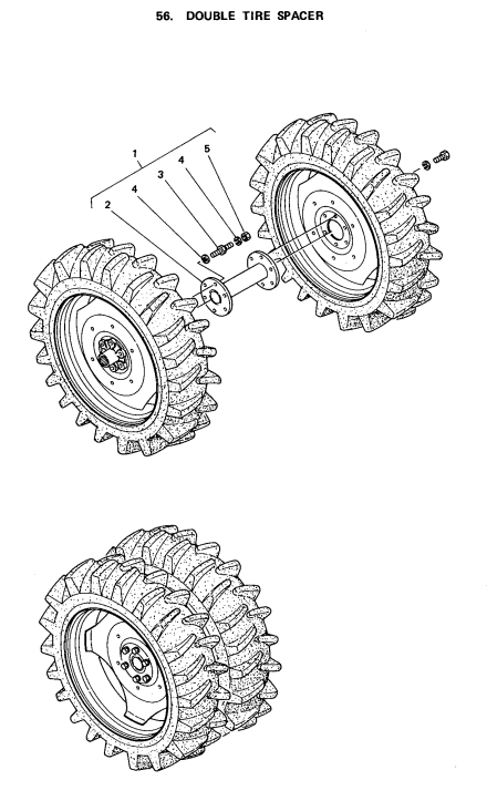

In the Yanmar manuals, the maximum width wheel spacers is 100mm (aka 4-inches) per wheel. Measuring then from wheel to wheel, the tractor gains a maximum of 8-inches of width.
The Yanmar manuals also mention dually rear tires.
/ Adding Some Stability to a Small Yanmar Tractor #6
I think I used 3-inchers.
But it's odd that you could run duals, which should add a crap load of width and be much harder on the axles.
/ Adding Some Stability to a Small Yanmar Tractor #7
In the figure above, it looks like the duals have a slightly different rim, bringing the inner tire in slightly and the outer tire a little bit out. Eyeballing it, I don't think it adds much width. My bet is that was (is?) for floatation in flooded paddies more than anything else. Just my $0.02...
