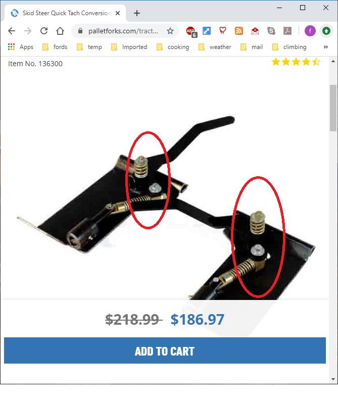

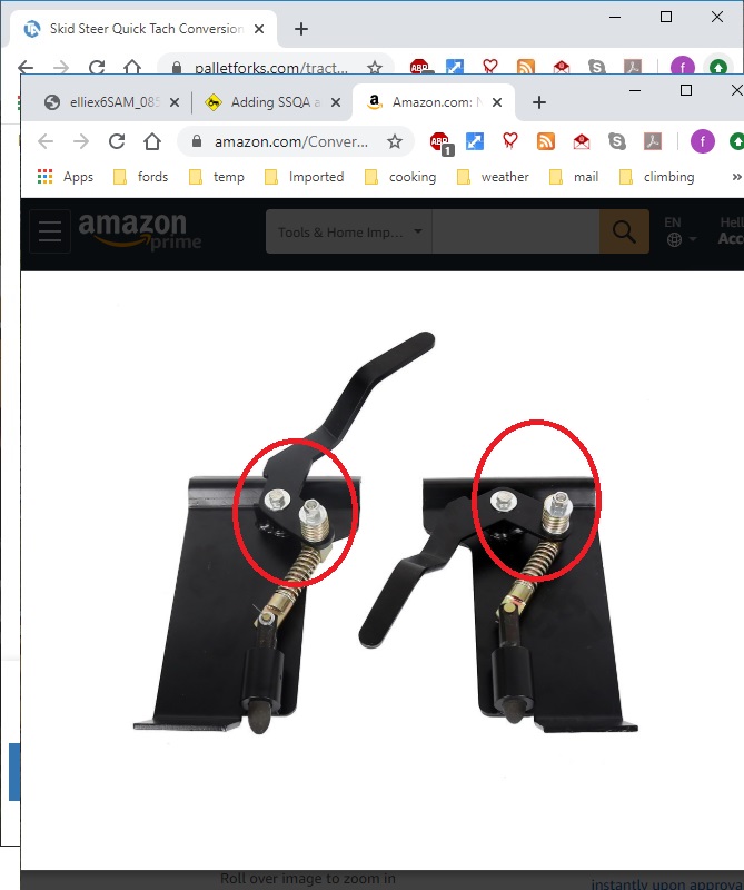

The first link showed
attachment.php
the lever arm being handle-hinge point-latch spring with a spring above where the hinge point is
and when I looked up the similar part at Titan (the second link) it shows
attachment.php
with the additional spring above where the latch spring connects.
Other than the approximate $100 difference in cost which one is better? Or was one just assembled wrong for pictures?

/ Adding SSQA and Grapple to L3130 #10
LD1 - I'm very interested in adding a grapple to my M4700 so I looked up your links -
643281d1582995332-adding-ssqa-grapple-l3130-ssa2-amazon-jpg
643282d1582995449-adding-ssqa-grapple-l3130-ssa1-jpg
I am assuming one was assembled wrong for pics.
The spring is supposed to provide resistance/friction so when the levers are up, and you are detaching, the handles dont fall down and re-latch under their own weight.
Those are not the ones I specifically ordered, I actually ordered the plate and latch boxes off ebay for similar cost. But it was just to illustrate what was needed and an approximate cost. Alot of people simply dont know what they are called and had a hard time searching/finding anything.
Simply google SSQA latch boxes and take your pic. I am not advocating one brand over another. And have no idea of quality differences, as I have only been down this road once

/ Adding SSQA and Grapple to L3130 #14
Sort of a lame reply, but the more costly SSQA lever set has grease nipples, for one thing. The springs look to be assembled wrong, as was noted. I think you'll be fine with your L3130. I had one for a couple of years (it was just too big and heavy for our needs) but although it wasn't fast, it had plenty of grunt- the trade off for only 31 HP was speed. It's a good machine. Mine had no third function- just used the tilt circuit for swinging my SSQA snow plow. Now I have a rear remote which I use, and I think it works just as well as a third function for most things. Maybe not as handy, but much lower cost. Just some 12' hoses and mounting blocks.
#15
Varmint,
not lame at all, I definitely would want a way to grease things, and I anticipate the Kubota part will have that integrated.
If I had rear remotes I would have just got longer hoses to run up front for the thrid function, but this will have to suffice.
To the tractor - grunt to get things done was the goal - my property wont have more than a couple of cleared acres, and a lot of woods, and the other spot it will be used is only about 5 acres cleared, with a small garden plot and mowing being handled by a commercial zero turn for the most part. The tractor is just a work horse, so it should be great.
Thanks!
/ Adding SSQA and Grapple to L3130 #16
Mine were cheap and had grease fittings.
Being assembled wrong for pictures is no issue for me.
Spend $100 or spend $900. Your call, not mine!
