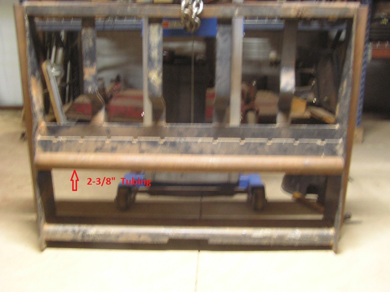

I have this old fork frame that never had forks on it:
I used it about 12 years ago to put a three point cedar tree cutter on the V417:

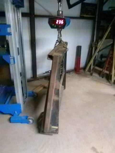

I do not have the tree shear now so I removed the 3 point hardware:
The frame now weighs 236 pounds:
Will be using 4 of the holes to bolt on a piece of 2-3/8" tubing:

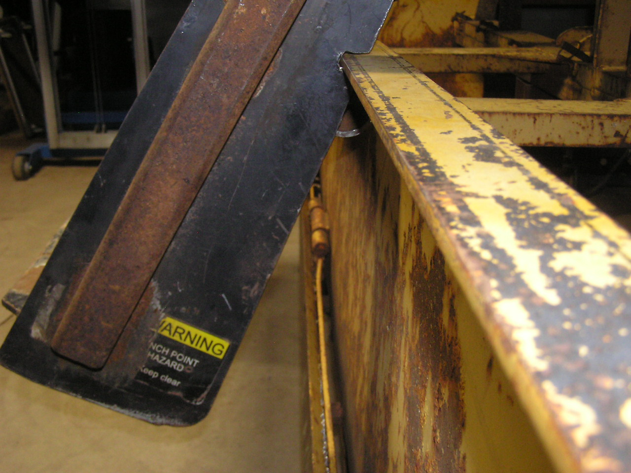

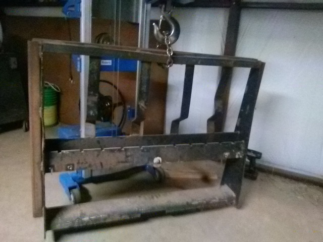

Long story, here is more. Drilled the tubing and bolted to the SSQA frame.
Sorry for the blurry cell phone pictures:
Had to notch the side frame above the tubing to fit the back of the box blade:
Here it is in place with the tube against the back of the box blade:
Next step is marking and drilling bolt holes in the back of the box blade and the tubing.
/ Adding SSQA to a Box Blade #4
I know your not done and skilled in making things heavy duty. Would think you need a lot more frame and gussets to transfer forces to the box blade?Using bolts instead to welding to make it easier to change? Holes thru tubing unless you use bushings tend to invite deformation and cracks.
Always enjoy your projects.
I Build using the TLAR method. (That Looks About Right)
In the picture above you can see the two channel iron braces from the back where the tubing is pushing from, to the front where the 3 point arms hook on.
That may need some gussets up to the top. The tubing is above it a little and on the back.
Yep, and to remove if TLAR fails :D .
Thanks.

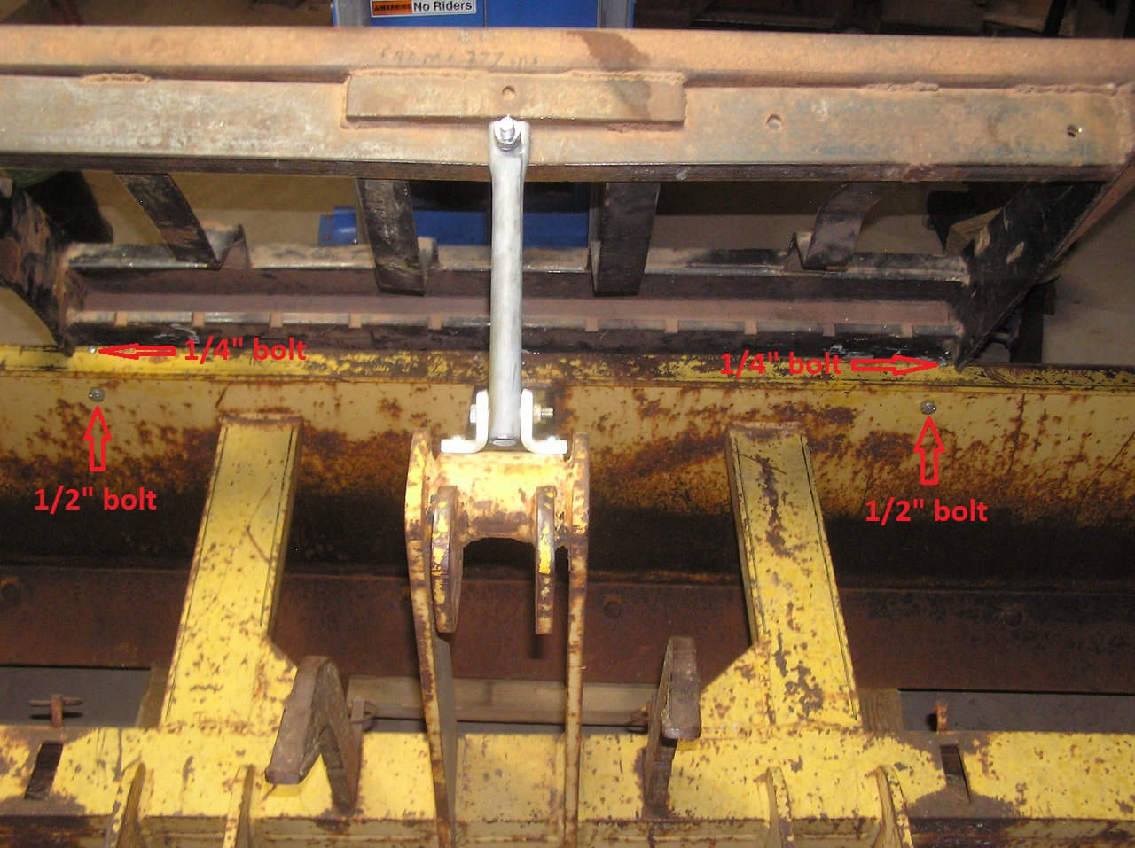

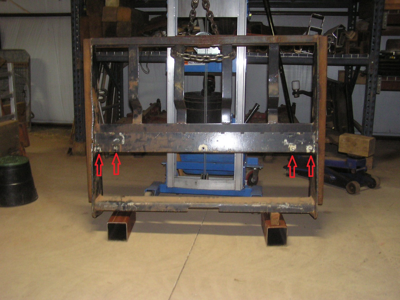

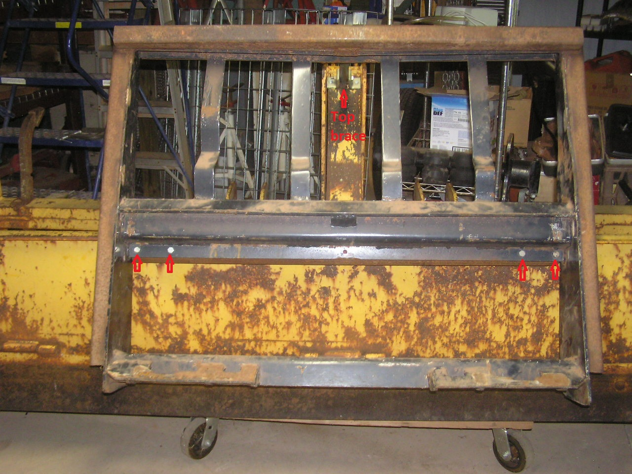

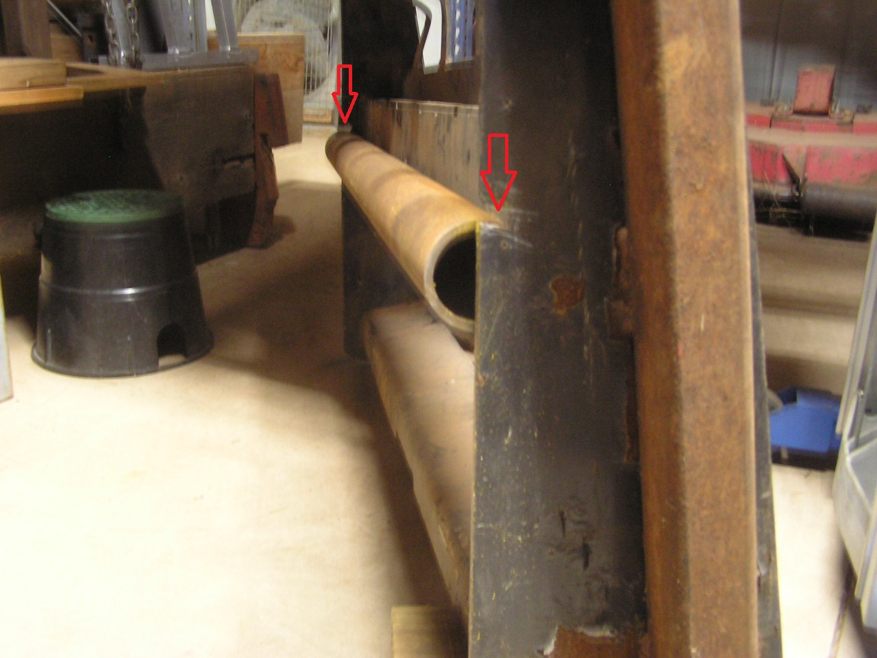

Got the holes drilled in the box blade and tubing.
Here it is removed from the frame and bolted to the box blade:
The arrows point to the bolt holes for the frame.

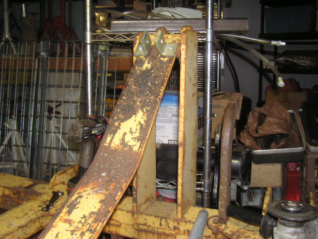

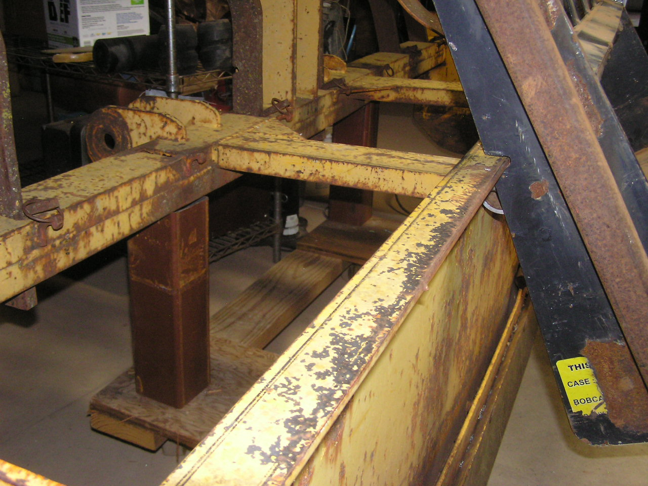

Got the brackets mounted for the top brace:
The frame is bolted on:
The top brace is using a hole that was already in the frame:

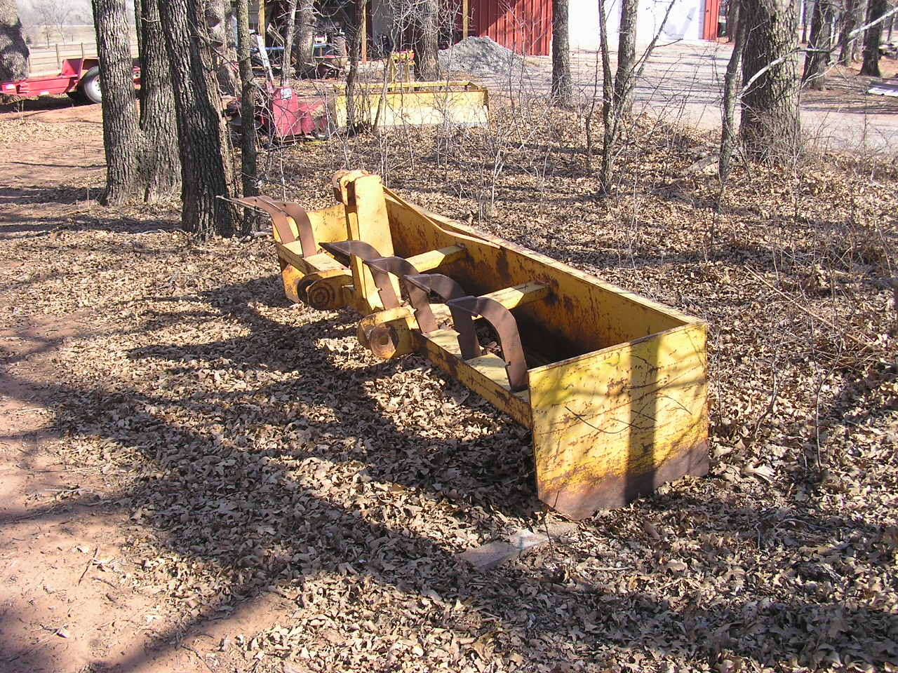

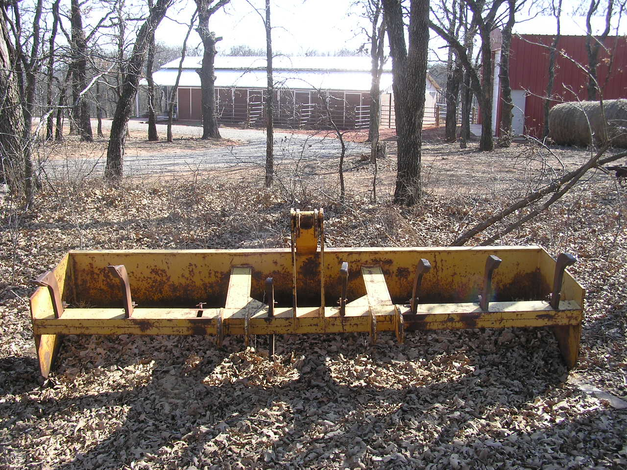

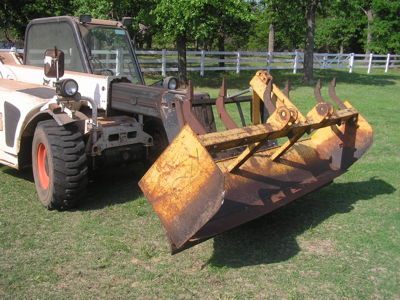

Probably should have shown some pictures of the 8' box blade at the beginning of this thread. :unsure:
Better late than never:
On the crane scale:
On the Toolcat:

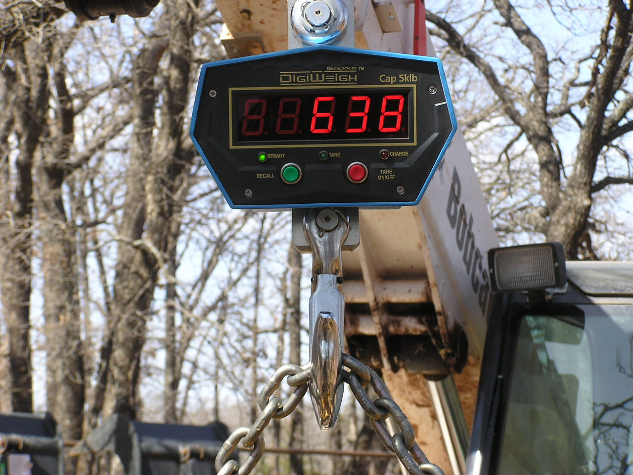

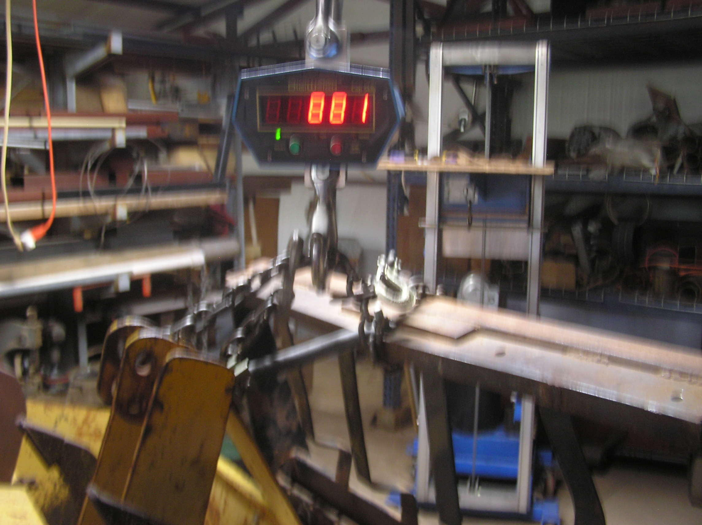

Showing the bolts from the box blade to the tubing. 1/4" in the top flange and 1/2" through the back:
Blurry pictures from the camera this time. Picked it up with the shop crane to weigh it:
881 pounds

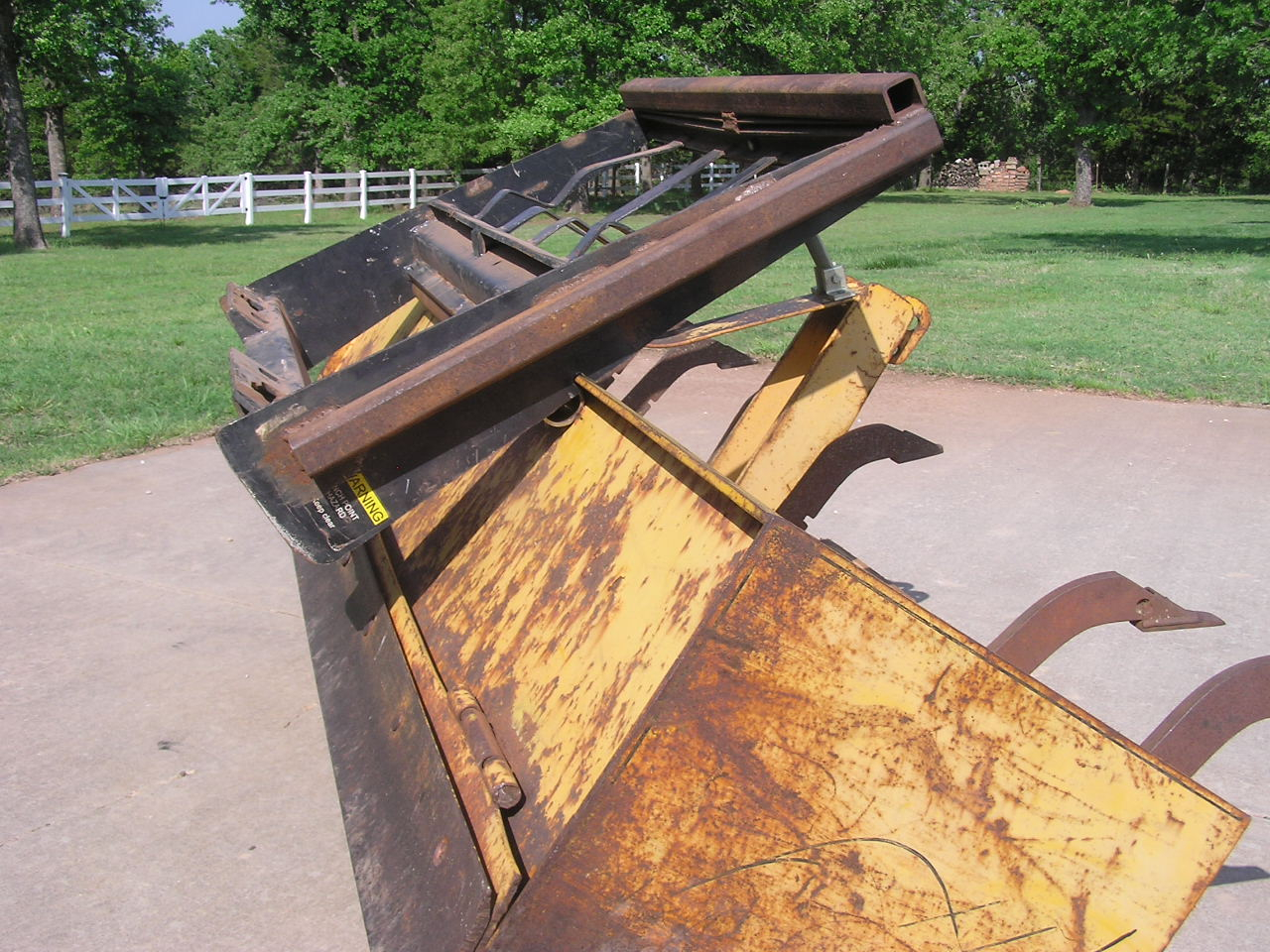

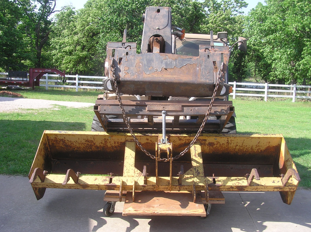

#9

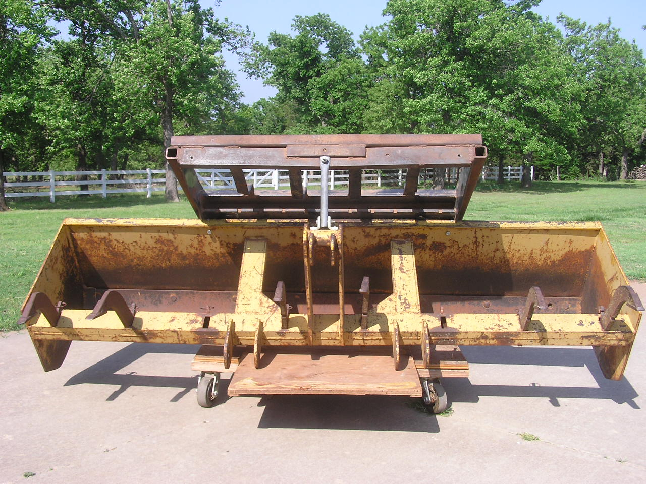

Set it down on the dolly and rolled it out of the shop:

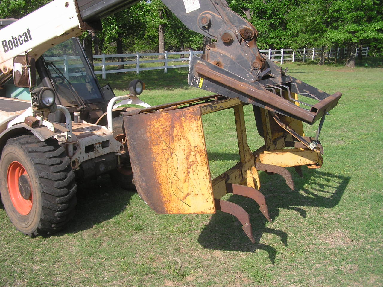

Did not want to put pressure down on the dolly when connecting the SSQA, so ran a chain to it and picked it up:
It is off of the dolly:
Backed up and set it down on the grass:
Connected the SSQA and this is maximum rollback or curl up:
Maximum dump or curl down:
Next I get to try it out. :D
/ Adding SSQA to a Box Blade #11
I suspect that single bolted brace at the top will be under a LOT of tension and compression when actually using the box blade and will probably bend the tube or rip the single bolt out of the end of the tube when you snag something. It is nowhere near the strength of a top link. I think you will have to either implement something of similar strength to a top link there using the original pin hole on the box blade, or build braces from the bottom rear of the box blade to the bottom of the fork frame. It looks to me like you could drill straight down through the that 1.5 or 2" square tube on the top rear of the fork frame and run one end of a top link with the pin vertical there, and other end in the original top link hole on the box blade in the usual way. But I can't see how resistant that tube would be to rotation/torsion in the middle because i can't see if it it welded anywhere but at the ends.
But, i'm curious to see how my theory holds up to your real life testing!!
#12
I agree it doesn't look as strong as a top link, but the wall thickness is more than twice as thick as the tube part of a top link.
For it to bend or get ripped out the other attachment points would have to fail. And that could happen with enough force.
That was my original plan, but this was easier and TLAR.
It is welded in the middle..
I added the 2" square tubing many years ago after straightening the fork frame after getting bent from trying to use the tree shear as a tree puller.
Me too!!

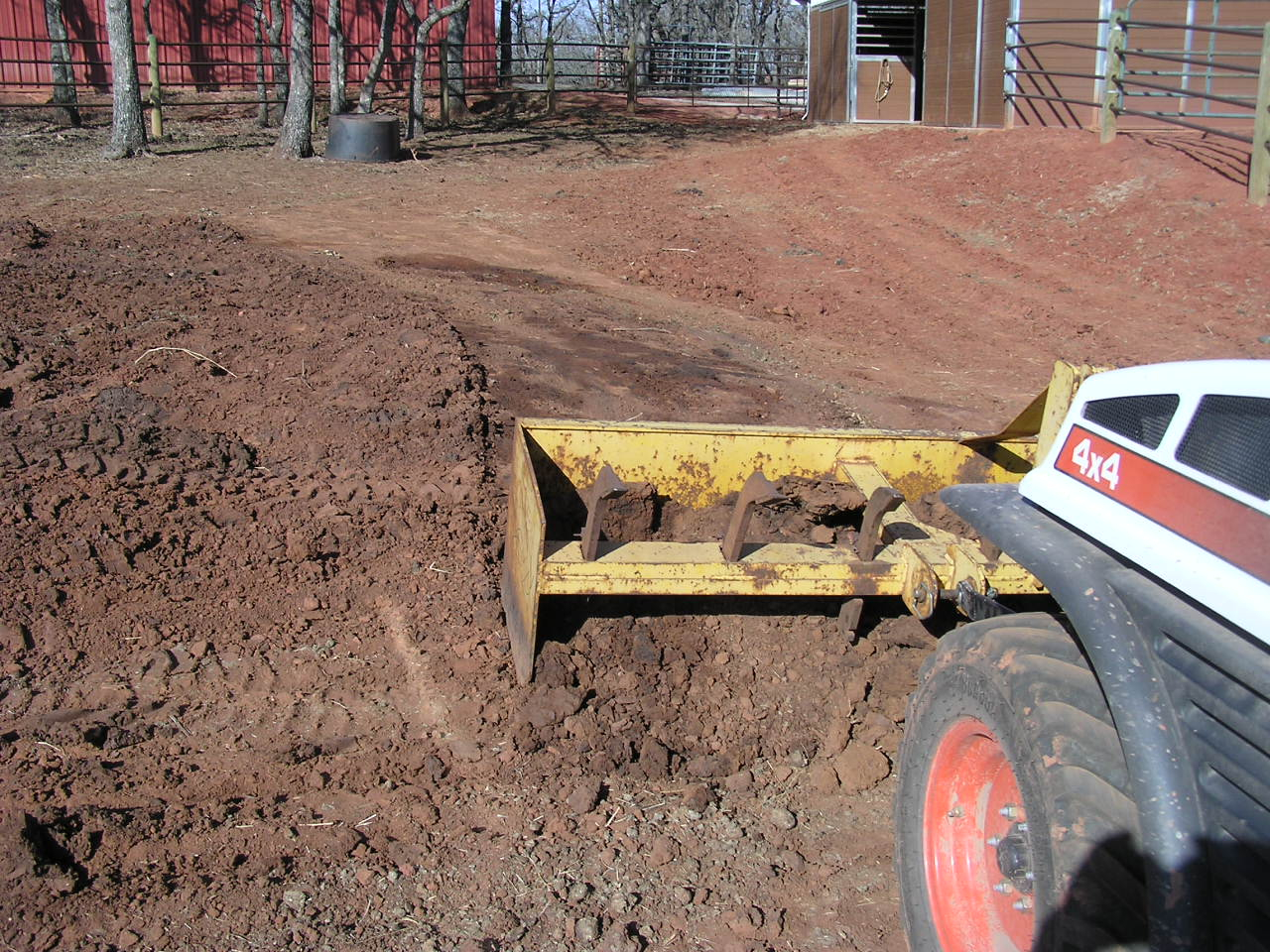

First real life test. This is the top of a terrace that I have been removing dirt from:
Raised it after the first short push:
And after a longer hard push:
So far so good, nothing bent or broke. (y)

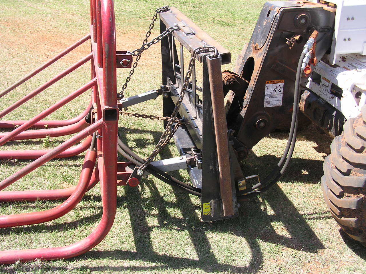

No, but have a hydraulic Tilt-Tach for the SSQA. here it is with the 6' box blade:
Here is the Tilt-Tach on the Toolcat:

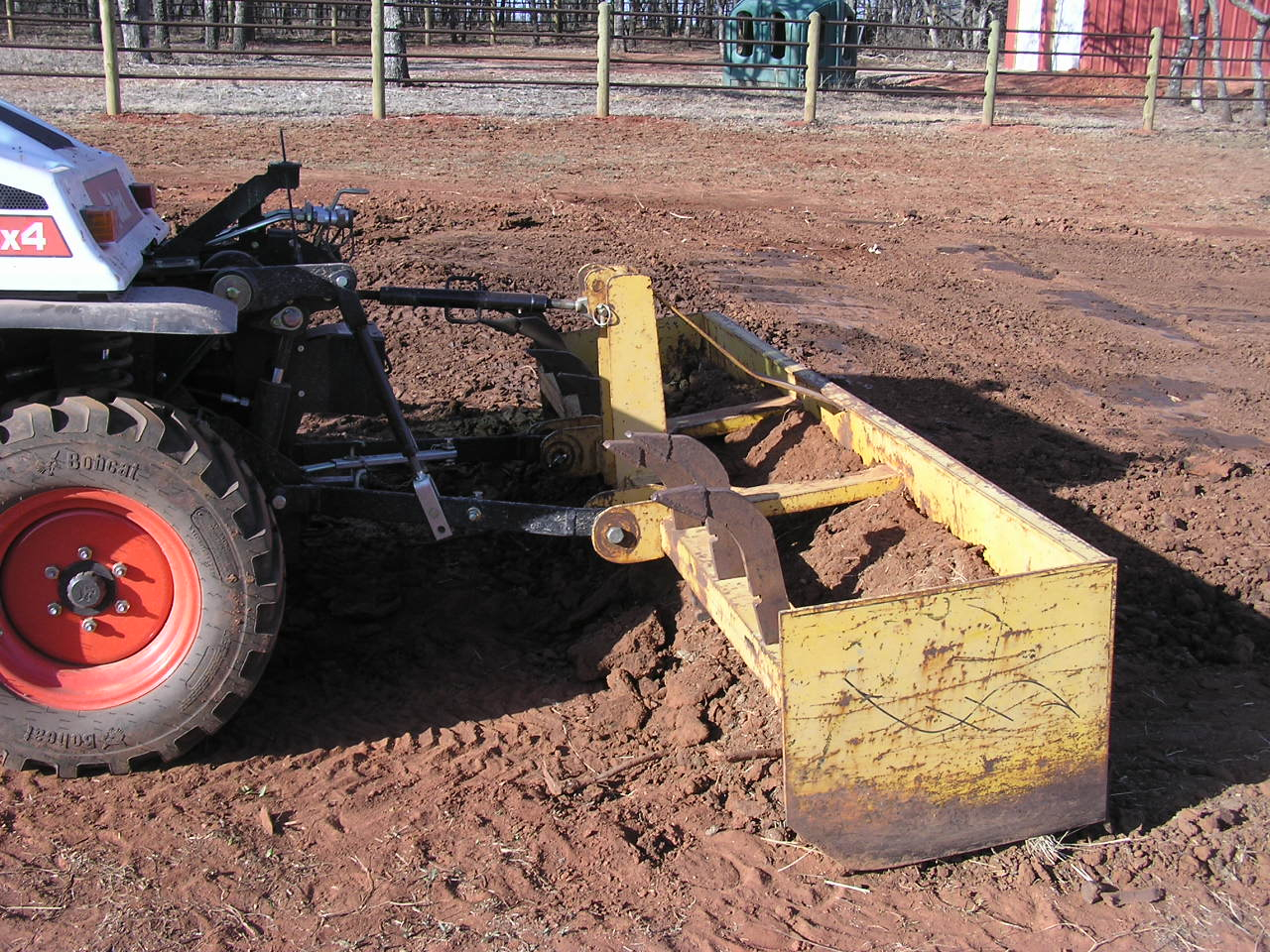

Found some pictures from 2014 that show the SSQA fork frame after the cedar tree shear was removed:
And even had the 3 point linkage hooked to the box blade:
