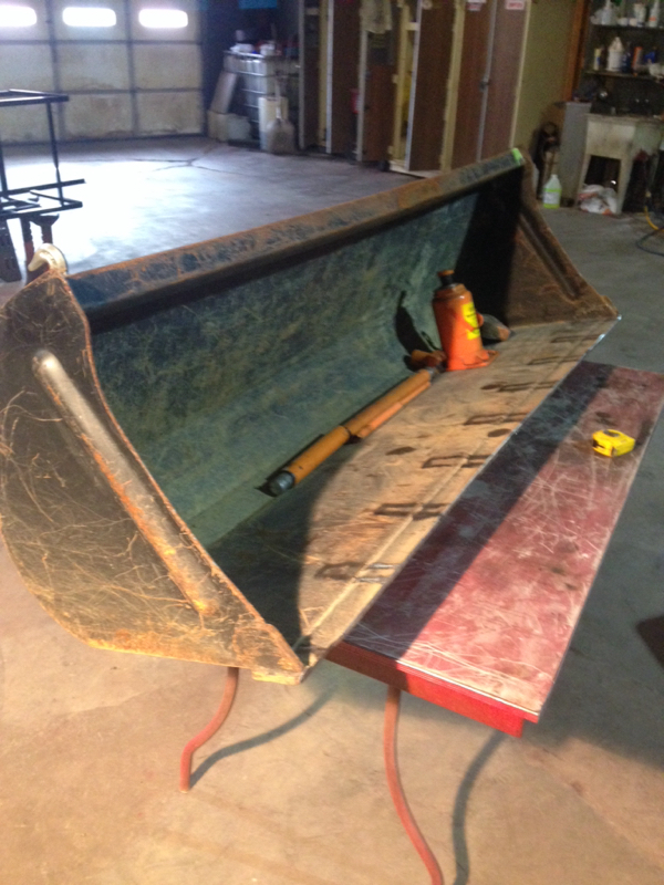

Decided it was time for a tooth bucket, instead of doing a bolt on tooth bar, I found another bucket and added teeth to it. The bucket had some wear on the original welded on cutting edge, so I added a heavier weld on edge and weld on teeth mounts, went with 9 teeth on a 6 foot bucket.

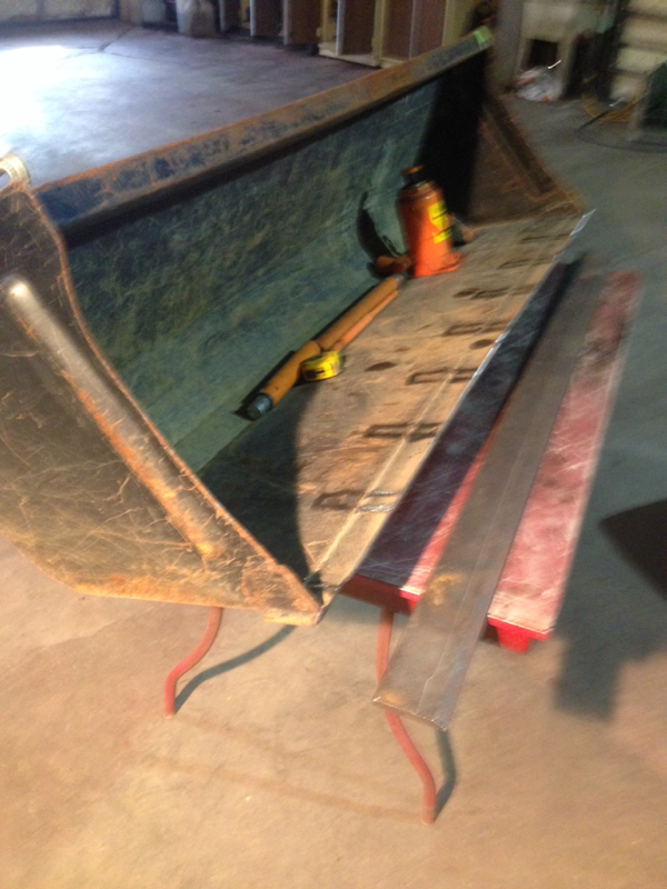

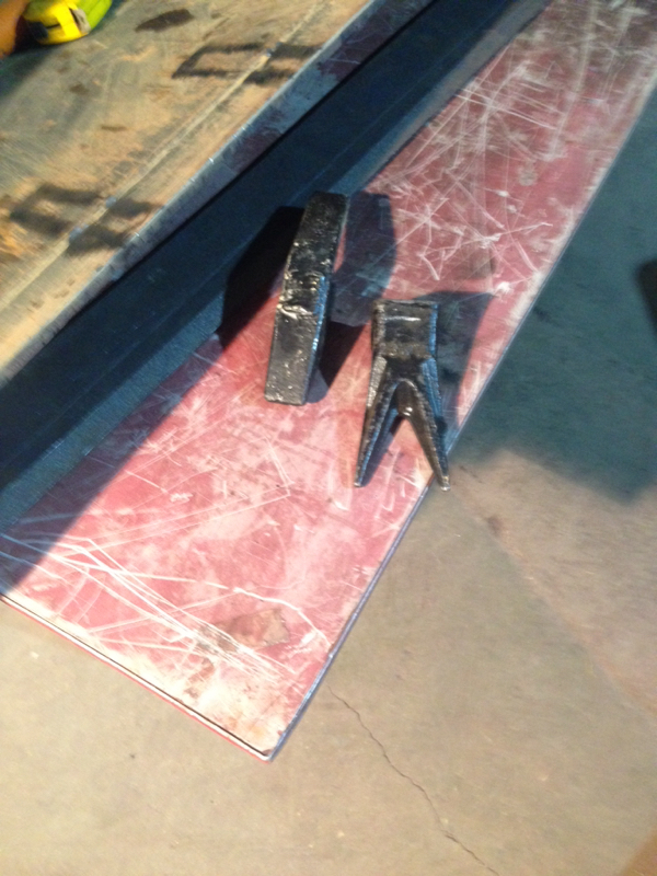

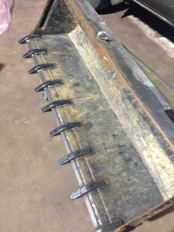

Got the new cutting edge and teeth mounts on and all welded up, also added three hooks to it just in case I needed them later. Just have to clean it up and spray a coat of paint on it , then put it to work.

Thanks, looking forward to trying it on a few projects, I do have some concerns, that the teeth I have are a bit to aggressive , but I can always change them out for a standard tooth.

My teeth are installed with 2 bolts,, a 10 minute job,,
(most of that time is finding the right size wrench,,, :laughing:)
It seems the teeth stay on the bucket the 8 warmer months of the year,,
then the teeth come off for winter. :thumbsup:
If I were to design a toothbar,, after having this one,,
the teeth would be three inches wide, spaced 1" further apart than this toothbar.
I would want the wide teeth because of the wear that resulted from the first couple hours of use.
I needed to hard surface weld the teeth within 3 hours of installation.
The wider teeth would work the same, but, not wear as quickly.
