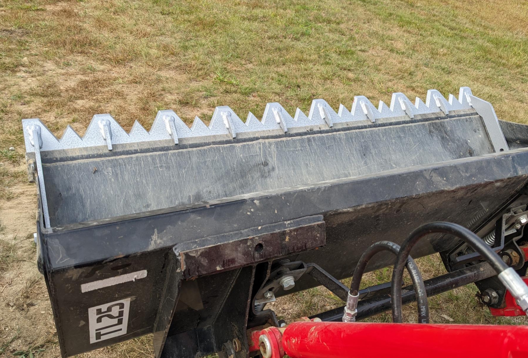

I have a Piranha tooth bar from BX EXpanded on my Kubota BX25D. It is Very well built and cuts and back drags great. If they don't have one for your tractor, I think they will custom make one for you. Their customer service is excellent!!
/ adding teeth to a dirt bucket #16
Another vote for the bolt-on tooth bar like Redbug mentioned. I bought one. It has replaceable teeth and a drilled a hole in each side of my bucket to hold it in place.
That being said, I am glad it is easily removable because it is off the bucket way more than it is on. While it is useful, my 39hp Kubota doesn't have enough power to really use it hard, in my opinion. That, and I use the bucket edge for back-dragging to smooth things often.

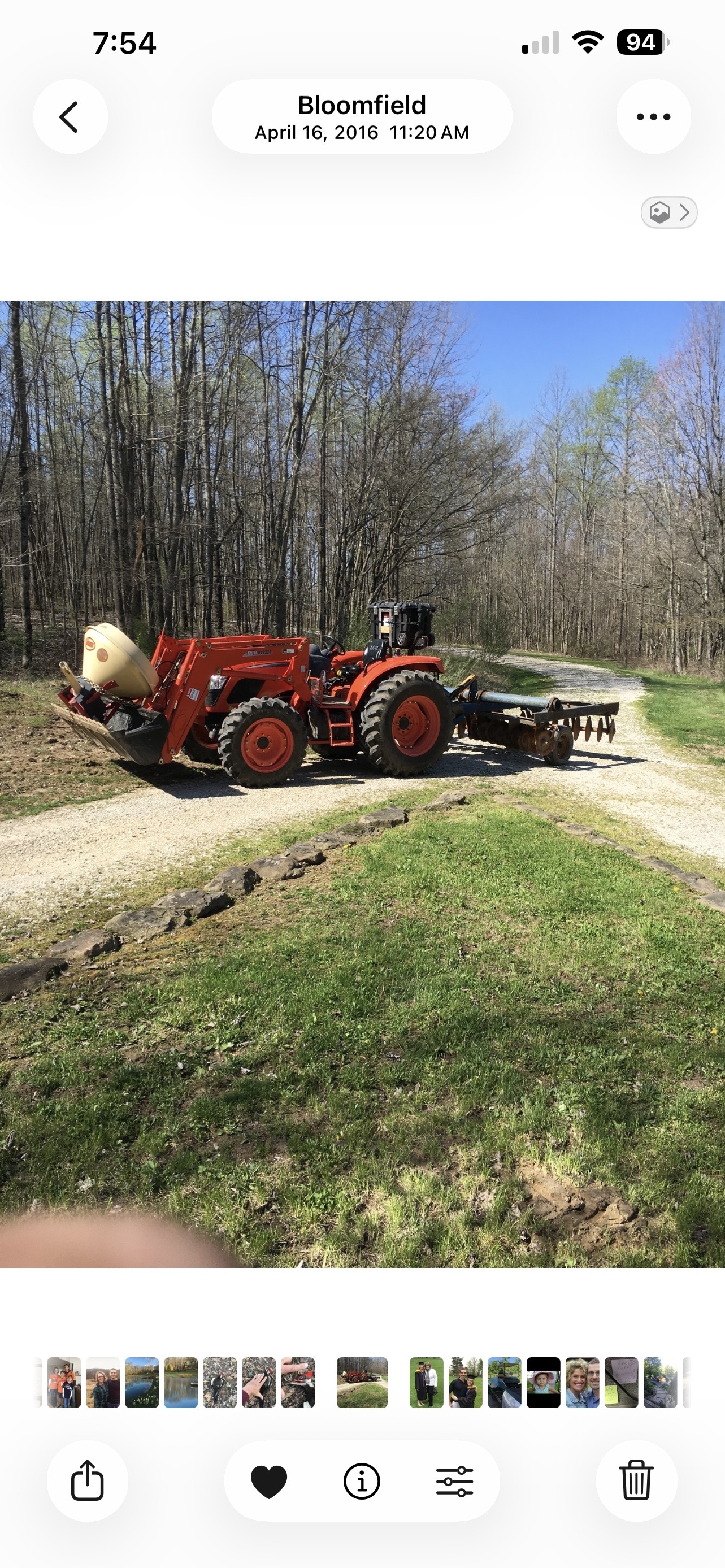

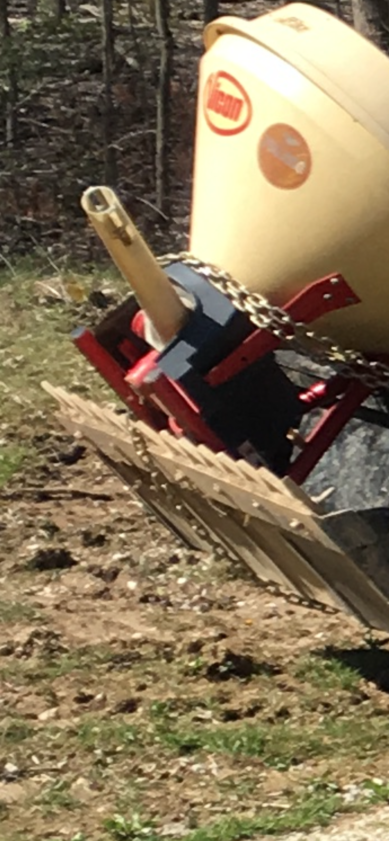

Have the same tractor. I took a half inch plate and made one. As someone else mentioned then drilled holes to match the existing holes. Used one hole for the edges and one in the middle so 3 total. Used eye bolts which has come in handy at times when chaining stuff up and carry with the bucket. I’d have to get a better pic when I get home but heres a bad pic lol

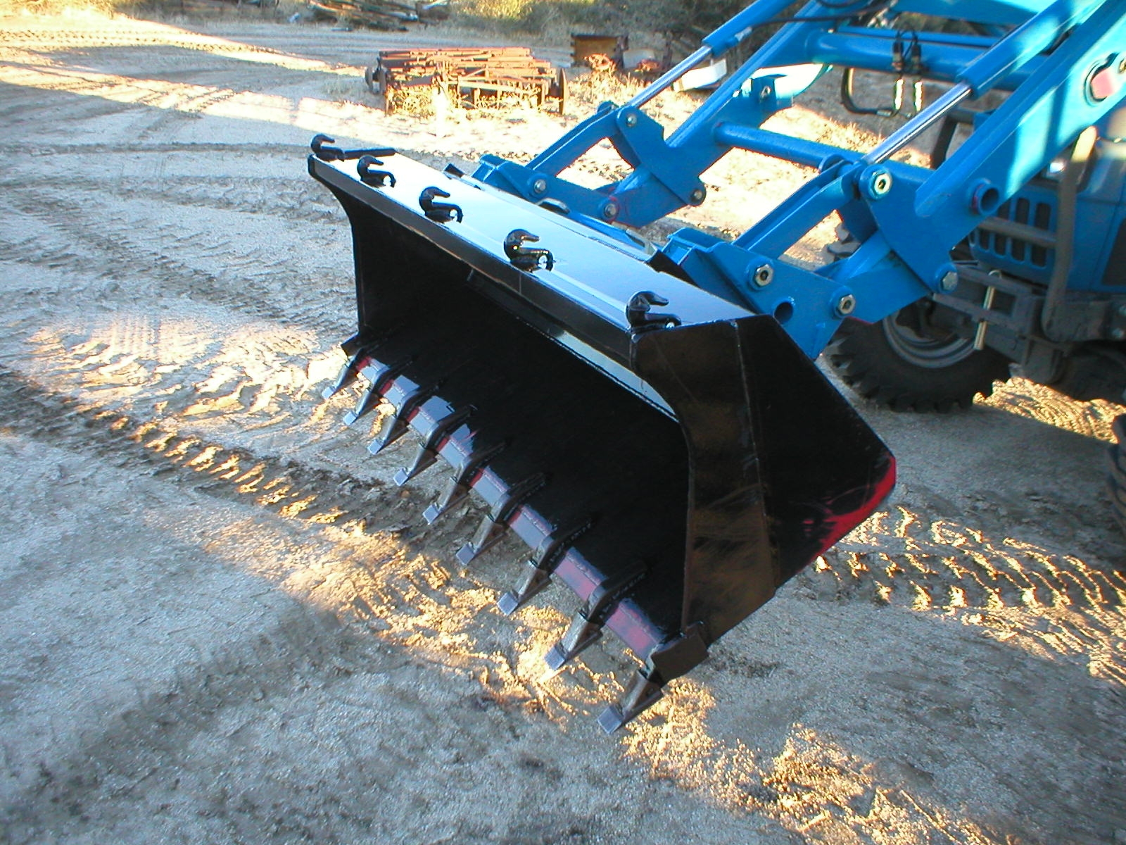

When I purchased my tractor, I got a 78" and 84" bucket. I made the 78" bucket into a digging bucket. Individual teeth, 3/8"flat stock side plate reinforcement and 3/8" x 2 1/2" top angle with chain hooks.
This has worked well for me over the years with zero damage to the bucket. (y) (y)
