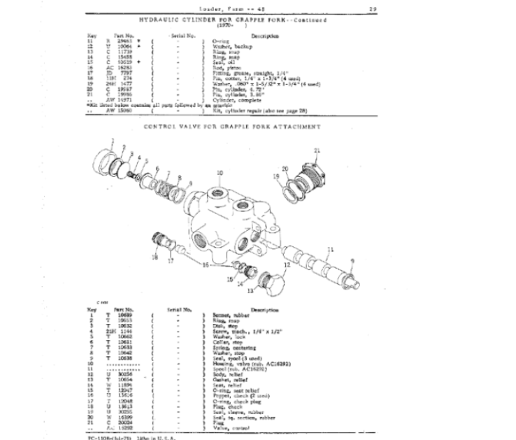

The CC valve would stop the flow through the OC valve except when any valve spool was stroked.
First valve will have a PB plug feeding the second valve. The second valve will then have a Closed center plug, therefore making both valves closed center. The pressure side will be blocked no matter how many valves are behind (ahead of?)the last one (fitted with a CC plug).

I'm just attempting to determine how it's designed to work. I'm still attempting to understand how CC valve can block oil to the added OC valve. I suppose from what you stated that you have actually seen this type of setup utilized on a JD CC hyd system.
Thanks,Jim
A Open Center Power Beyond valve sends all high pressure flow that is not used by the A and B work ports out the PB port. In the schematic I drew, that flow then goes on to the Closed Center valve which stops it unless it needs the flow for it's A and B work ports.
Where you run into trouble is when you use a Open Center valve that does NOT have Power Beyond on a Closed Center system as the Open Center valve will send all flow not used by the A or B ports to the tank.

Please explain this part of schematic because I can't determine how a CC valve is blocking the OC valve.
Normal flow for a Open Center Power Beyond valve in neutral position (handle at rest) is high pressure fluid into the P port and out the PB port. The Tank and A/B ports are closed.
As such, the high pressure fluid flows out the PB port, if you feed it into the P port on a Closed Center valve, the Closed Center valve will block the flow.

Thank you for your reply BUT IMHO once closed center plug is installed in the open center valve then open center valve ceased actually being open center & becomes a closed center valve. JD utilized the same CC plug(key 21) on FEL such as the model 48 in the late 1960's. I learned back in the 70's on a valve similar in photo how JD CC hyd system will act(cavitation) if seal(key 19) has failed. Valve from schematic with orifice with green line(arrow) concerns me as to what keeps oil from continuously returning oil while pump is pumping.

The green line calls out the return from the work ports. If the spool is not stroked, there is no flow. Which I previously stated.
