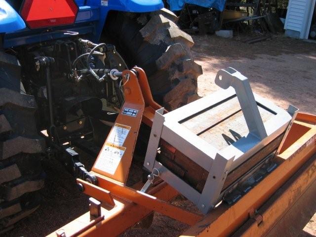

/ Adding weight to a box blade. #14
Bspring: Here is a pic. Ignore the added curved plates on the sides, they are for forming half-pipe shapes in deep snow conditions for the "kids" to slide downhill in. The added plate steel is about three inches thick. There are actually two layers totalling 3 inches thickness, and the dimensions fit the boxblade well. I was fortunate to find this steel in the local scrapyard, so it cost me 20 cents a pound. It does cause one problem. If I am using the boxblade backing up grading, dirt and sod get caught in between the cutting edge and the bottom edge of the steel plate. If I could I would raise it. Other than that, it makes a great boxblade out of a KingKlutter boxblade, and also greatly improves its value as a loader counterweight.
#15
Jim, thanks for posting the pic. You guys have given me a lot of great ideas. I may have to make a trip to my scrap yard to see what they have available.
