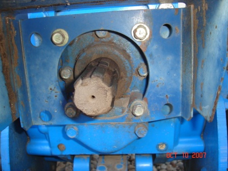

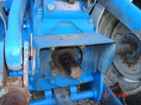

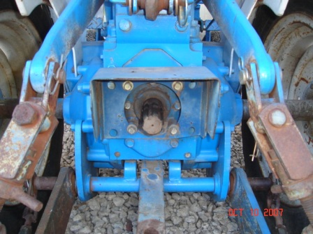

Wushaw- mine is a built for the U.S. tractor, too, but it and lots of others of the same model, Does not have the standard pto. I still would like to see the pto end of your tractor, if you get the chance to get a picture of it! Thanks, Dave

Ok I will get ya pic in the morning. I thought if it was built for U.S. then it wouldn't need any adapters, turn the U.S. standard way and would come with a PTO cover.
   / Adding weight to a tractor with a twist.
#13
Here is the Picts Dave:)

Thanks, Wushaw. That's the angle that I wanted to see. Mine has a metric shaft with a fine spline, about 1" in diameter, between the bottom 2 bolts of the gearcase. If you ever kill the tractor, that gearbox is worth about 600 bucks, if you can find them! Thanks, Dave:cool:

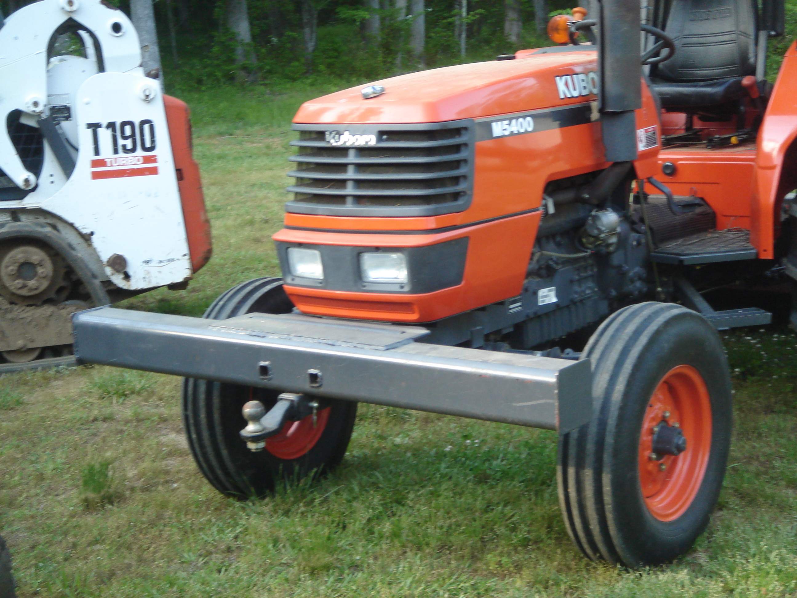

I did something very similar for my Kubota M5400. I use a dual spindle 8 ft bush hog on it that causes the front end of the tractor to get really light. Instead of buying the expensive weights I made one the same way you did. I didn't use lead, mine is full of scrap metal and concrete. I decided to make a bumper/bull bar, counter weight and trailer mover all in one. It comes in right at 450 lbs. I have about $100.00 invested in it.
