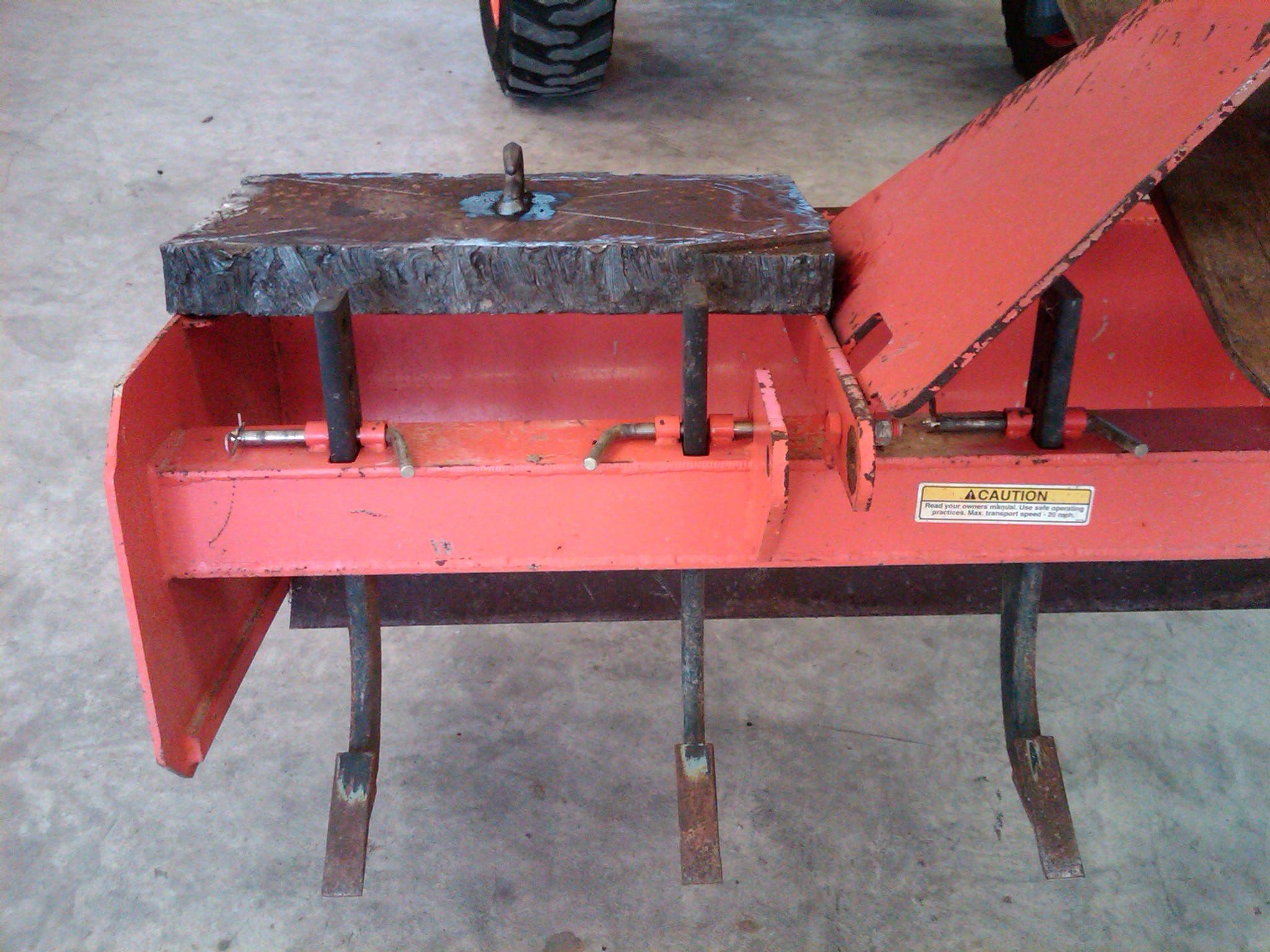

While trying to dress a rough gravel/crushed concrete driveway, I was disappointed how bad the medium duty box blade skipped an bounced and was pretty ineffective. I looked a suite case weights but could not figure a way to attacht them.
I aquired some really heavy plate, 10' dia. 2-3/4" plate and made some weights.. And for those of you who work big steel.. well hats off to youi.. this stuff is a pain in arse to work with..

RKJ 2-3/4" plate weighs approx. 112# PSF, so it should have added about 448#. I did have concerns if I did not like the additional weight so I only welded a heavy small tack in 4 places.
I also welded chain hooks to the center of each one if I decided to keep the weight I will finish welding it out and use the chain hooks for pulling my drag.

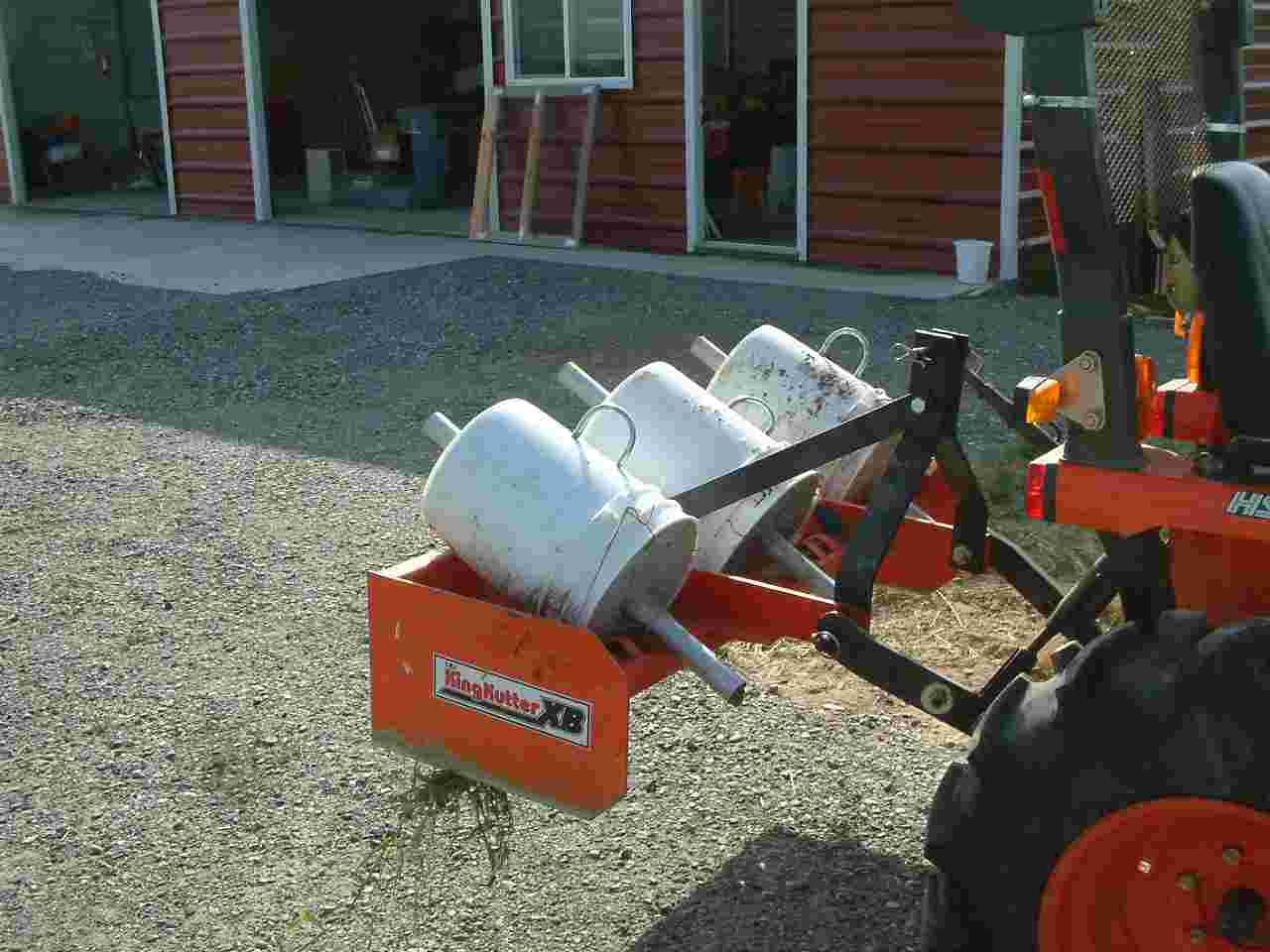

That's why I use concrete weights for my BB--three 120 lb weights
Cheap and no special tools required.
