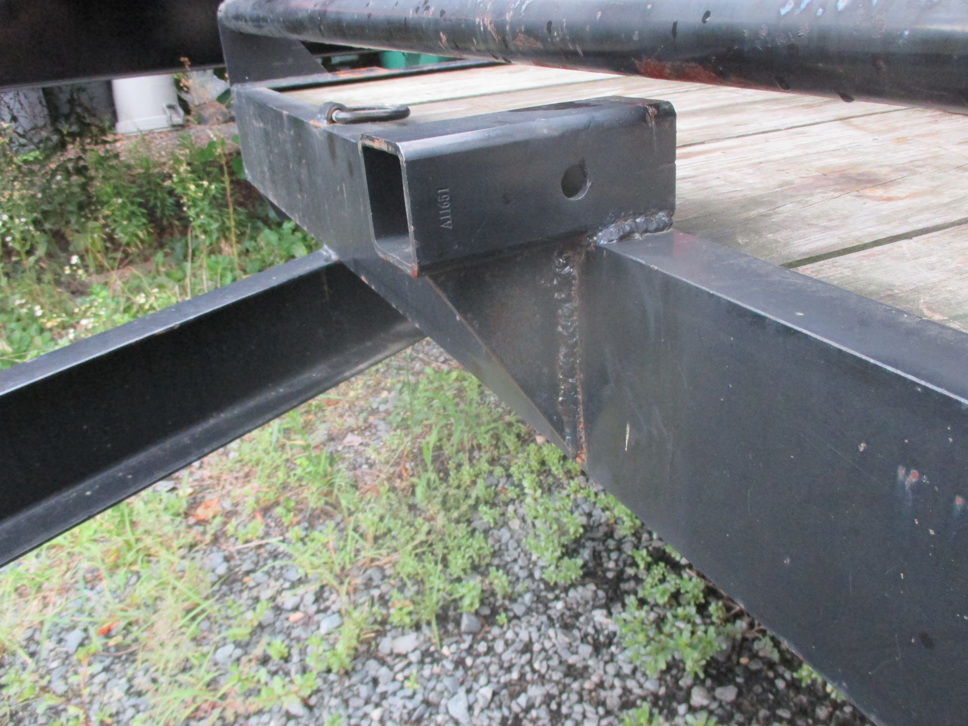

i've done the winch cradle thing. can move it to anything with a 2" receiver, front/rear of vehicles, both trailer, etc. i have a spare battery that i attach when using the winch and then put back in whatever i took it out of after i'm done.
/ Adding winch to trailer #6
I welded a 2" receiver to my car hauler trailer because I have friend the borrows it from time-to-time to retrieve collectible cars in non-running condition. He just pops his winch on and takes a good, charged battery and that's usually good enough for several pulls if needed.

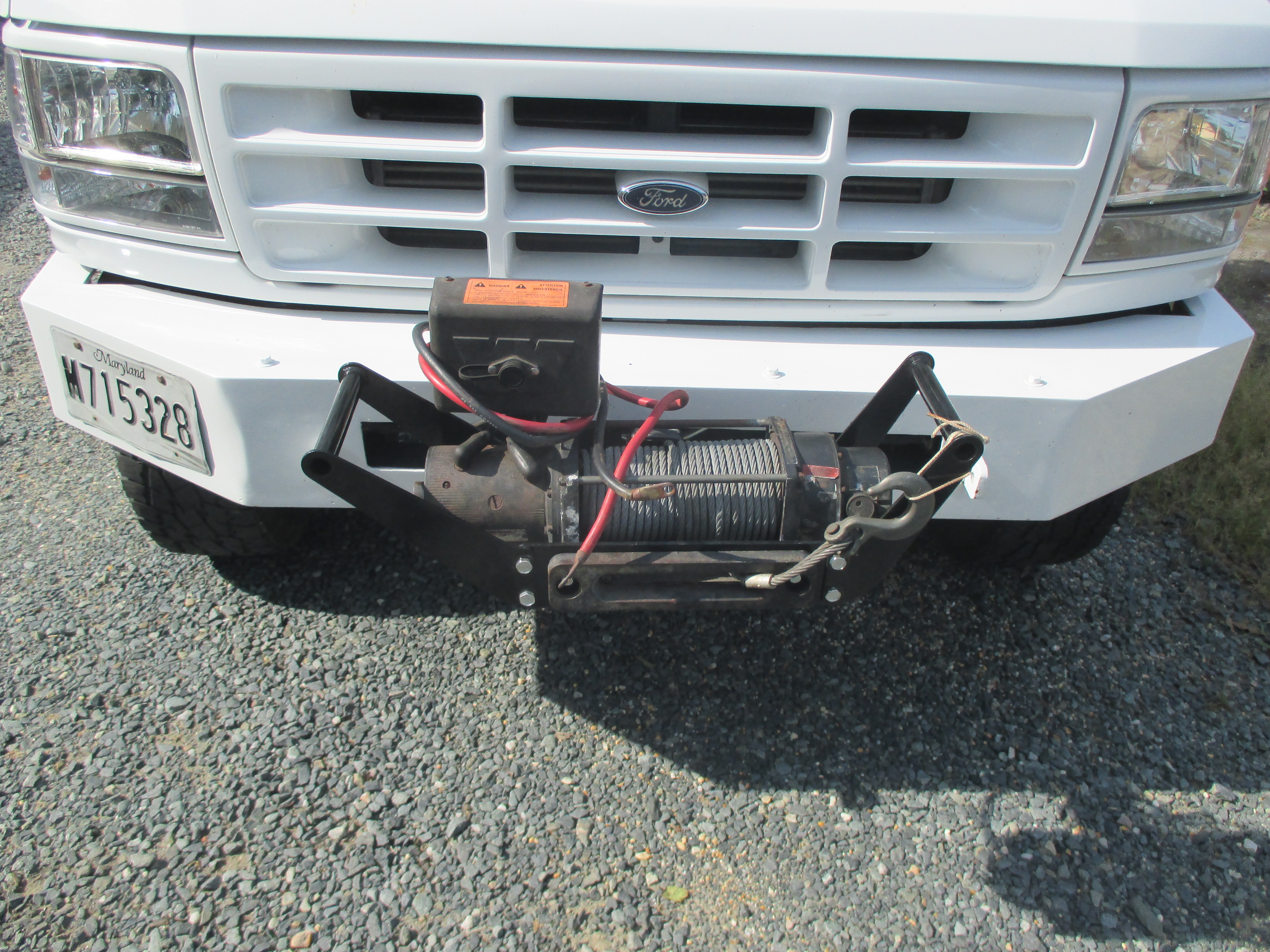

As others have said, attach a receiver to the front of the trailer, buy or build a winch carrier and use a separate battery. I just use my camper battery so it gets multiple uses.
When I setup my winch I bought a used 9,000# Warn winch, built my own carrier that allowed me to pin a aluminum box that I made on top. Then I ran a wire off the trailer plug for charging the winch battery. I am careful to unplug the charging wire before using the winch though. It makes a versatile unit that can be switched from trailer to vehicle easily. I just bought a new trailer Saturday that I need to setup to accept the winch.

Here is my set up on my car hauler. It get used daily. I never have an issue with the battery not being charged

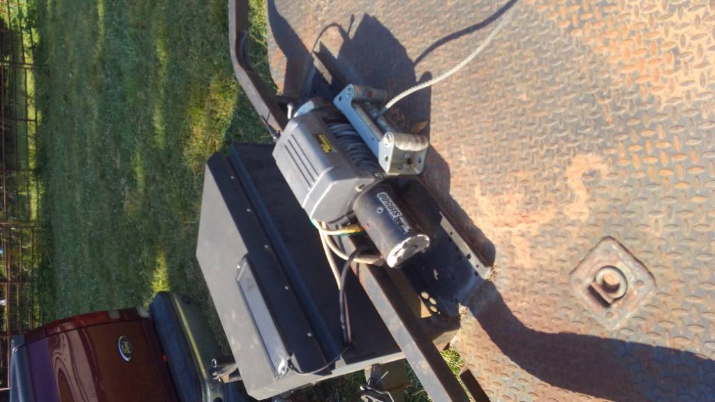

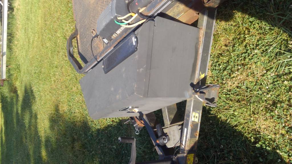

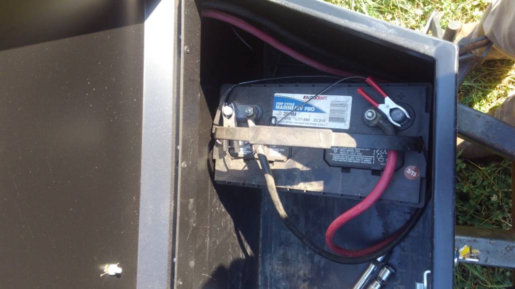

Made a bridge mount for the front of my gooseneck so I can retain the d ring in front. I then installed a high amp quick connect to hook an extra battery to and also made cables with jumper cable ends.
