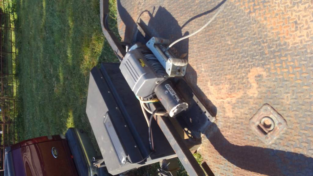

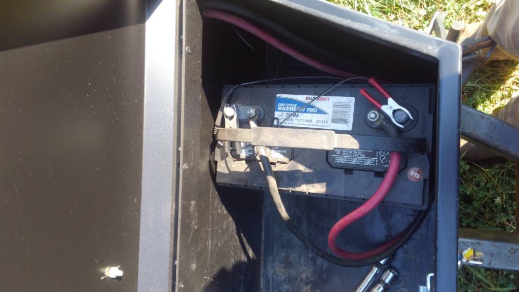

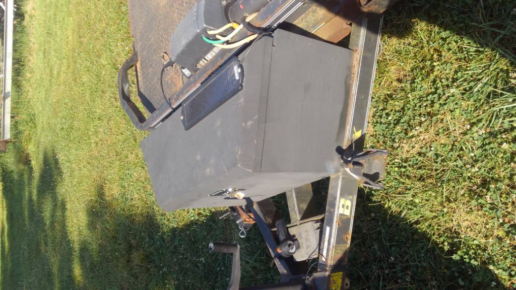

Here is my set up on my car hauler. It get used daily. I never have an issue with the battery not being charged
