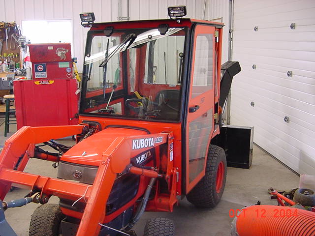

And Another

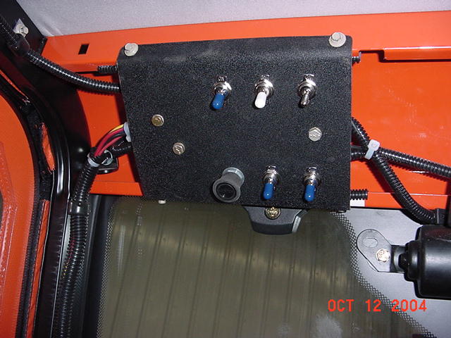

And the Electrical Panel for lights and heater

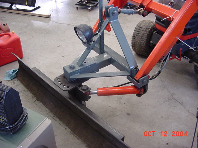

This is a picture of the front blade I re-vamped from a bent up rear blade I found. I took the bucket cylinder off my loader and use it as an angle cylinder on my blade. Works great, but I'm sure I could bend the loader arms if I got going too fast and hit something. Worked it all last season with no problem.

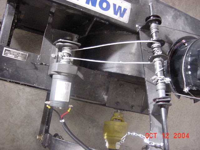

This is a picture of a cheap winch I bought to change the angle of the snow blower chute, without having to un-valcro the cab every time. I have just completed this, so I have zero hours on it. Works well in the heated shop, we'll wait and see what it does with a bit of snow caked on it. I will probably build some sort of a cover yet. I also welded two 3/8" nuts to the chute and threaded grease nipples
in them so that I could grease the chute rotation properly.

I was beginning to think that I was nuts trying to configure my rear blade to the loader arms. Nice work. I'm really getting tempted to get a welder. Great idea using the bucket cylinder to angle the plow. You don't even have to disconnect the hydraulic lines. I'm impressed!

BXRICK, Don't forget to add in the draw from the fuel shut-off selenoid. I'm not sure of the exact amperage, but on my B2400 it's on a 5A fuse.
