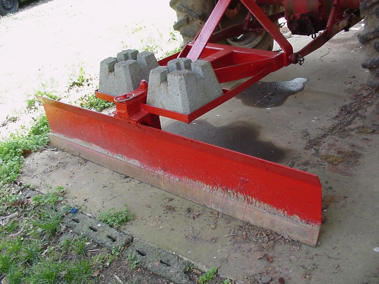

I welded some angle iron to mine to make trays to hold 2 heavy concrete post footings. They can be removed if needed, but so far they are just about the right weight for most of my chores that I use the blade for. Buying a box blade w/rippers has been what I use now for really heavy duty work though. My angle blade only does snow, leaves, ditches and light scraping since I got the box blade.
