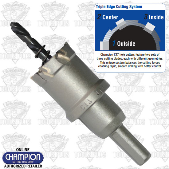

I use these Champion hole cutters in drill press and also hand held. They are good for up to 1" thick steel.
I have used them up to 2" dia in mild steel with the 1/3 hp Duro that I mentioned previously. But the Duro is happier with 1" dia or less.
OK we have discussed every option from handheld cordless to 1 ton milling machines and lots in between. I would be interested to know what the OP thinks at this point.

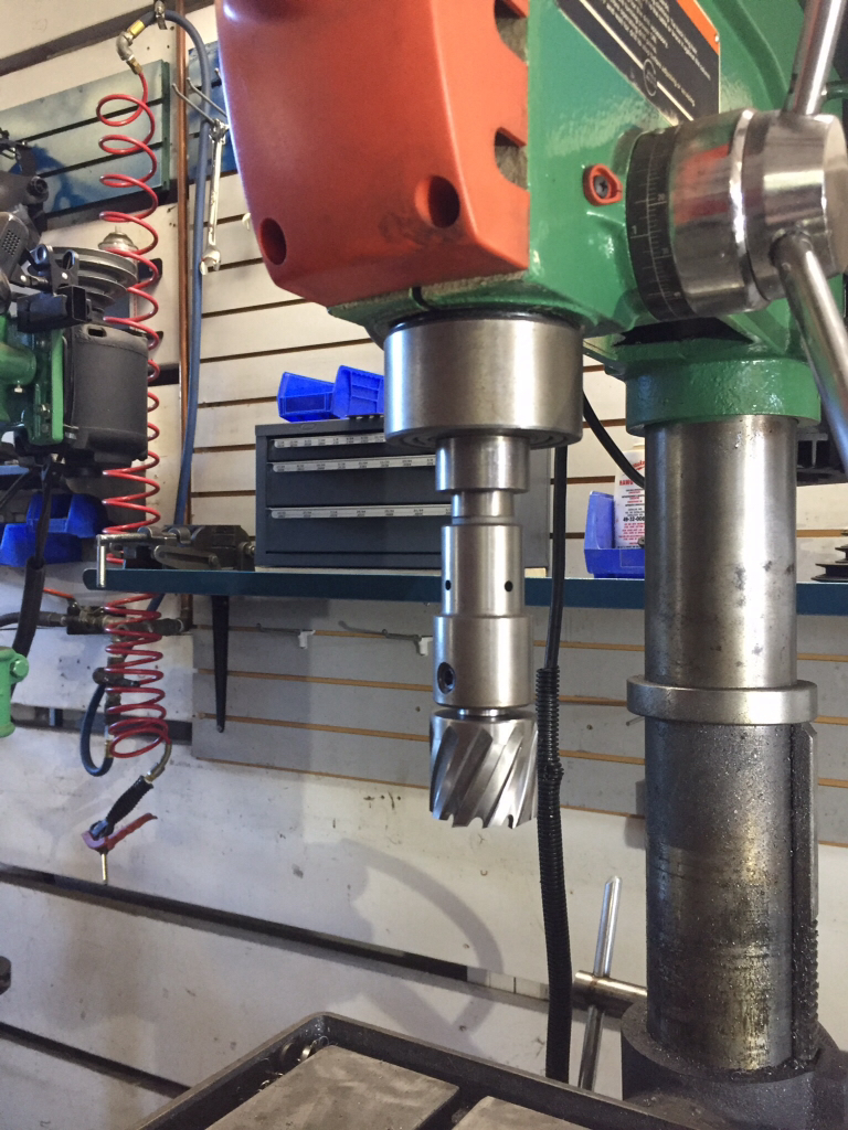

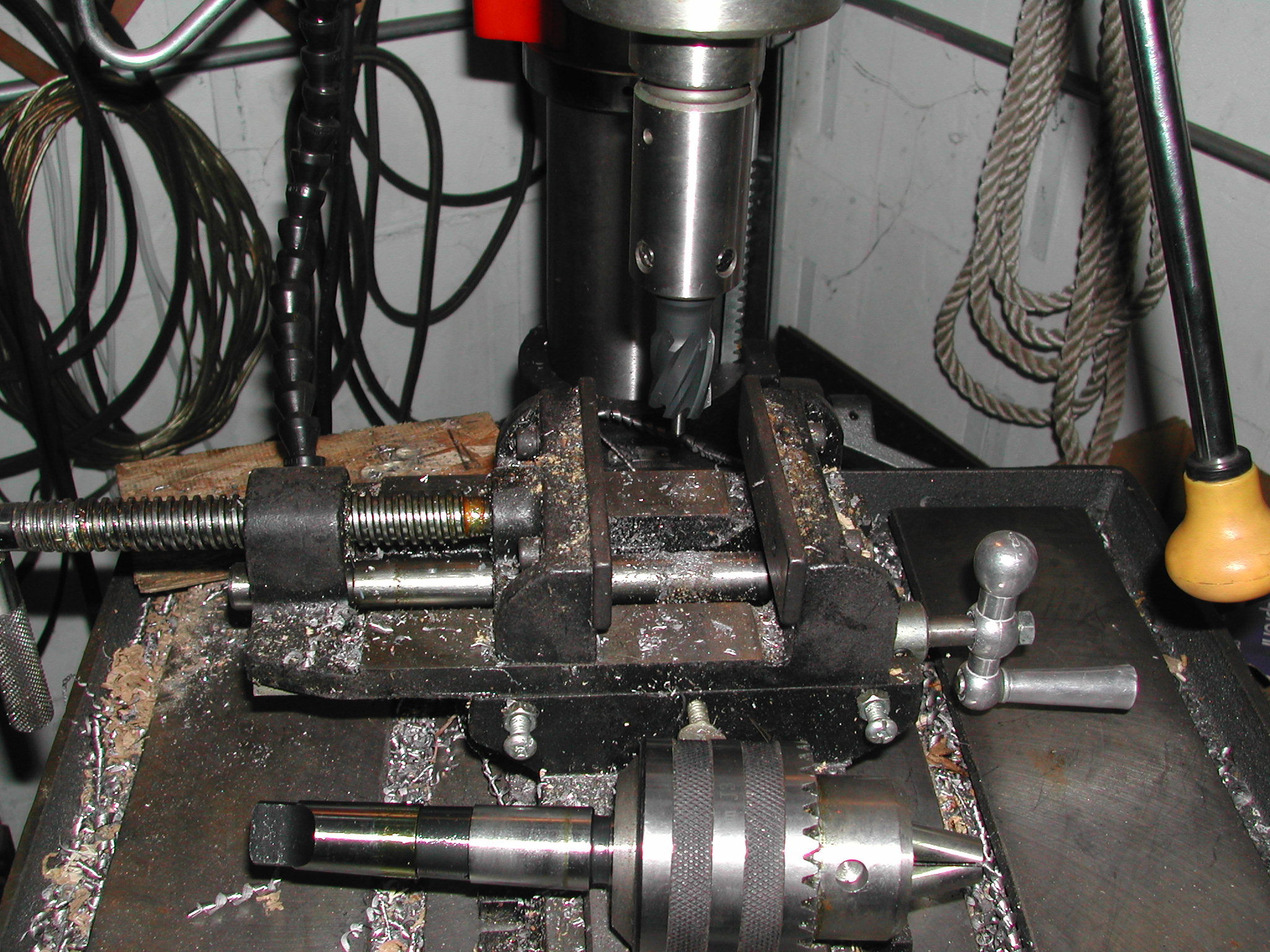

I have one of those adapters muddstopper mentioned. It's a great investment for a drill press.
Mine happens to be a "MT3 (the quill taper for MY drill press) -3/4" Weldon shank (for annular cutters). "
Terry
/ Adequate drill press specs #33
Looks like the same DP and adapter that I have.
