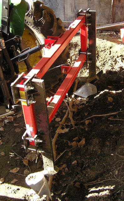

If I want to go deep, I go through it with my twin masted middlebuster first. It makes two trenches for the skids and the tiller takes a full bite the first time through.
I do similar with the scarifiers on my box blade.
Same here. Sometimes I've used the Middlebuster, sometimes the Moldboard Plow, and sometimes the rippers on the Box Blade. It depends on the situation or what happens to be on the 3 pt. Then I go to the 54 inch (4 tine :D) LandPride tiller.......with perfection no less.
