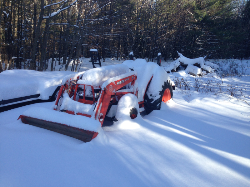

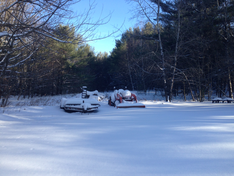

To get this thread back on topic, here is a picture of my tractor buried in a bit of snow. This is one of those times a blower would have been really nice! :laughing: I had left my tractor on my land in NH along with my trailer, figuring I wouldn't need it for a few weeks. Well of course I needed it and it was covered in snow, so I had to plow a path for a couple hundred yards through the field to get the trailer onto the driveway, so I could load the tractor and bring it home.
I had no issues driving the tractor around in the snow, but I figured I'd need to plow a path to pull the trailer out. I used the bucket to push the snow out of the way and, as has been mentioned a few times, it wasn't the best tool for the job, but it was all I had with me aside from the stump grinder, and I don't think that would have been too useful :D
I'm not sure how my rear blade would have done in this situation, but I really would have liked to try it. I don't think it would have been too effective because the snow was 18" high, and my blade is only 19" high. Plus I didn't have my chains on at the time.
