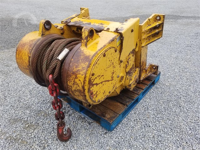

I figure this one'll fir right nice on my Kioti DK4710. Cable's not too big only one inch. Or maybe that's one and a quarter
I'll attach it to the front grill.
