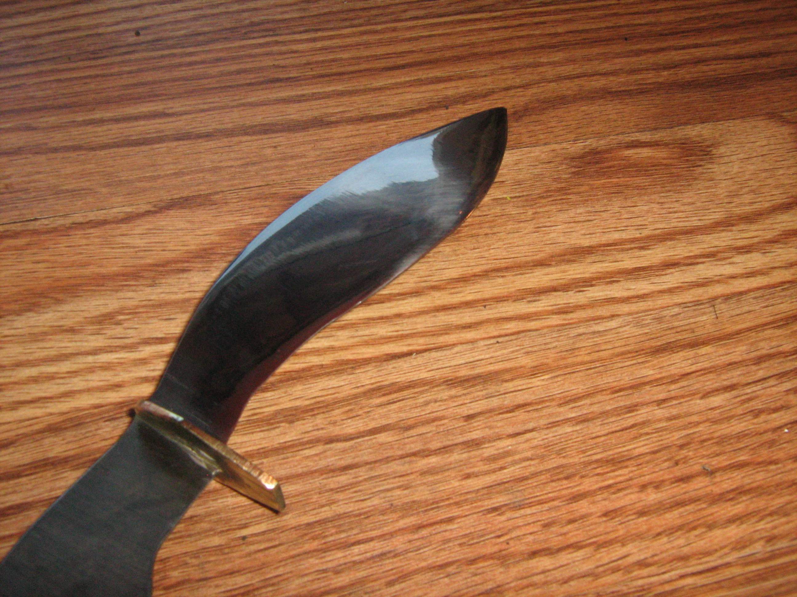

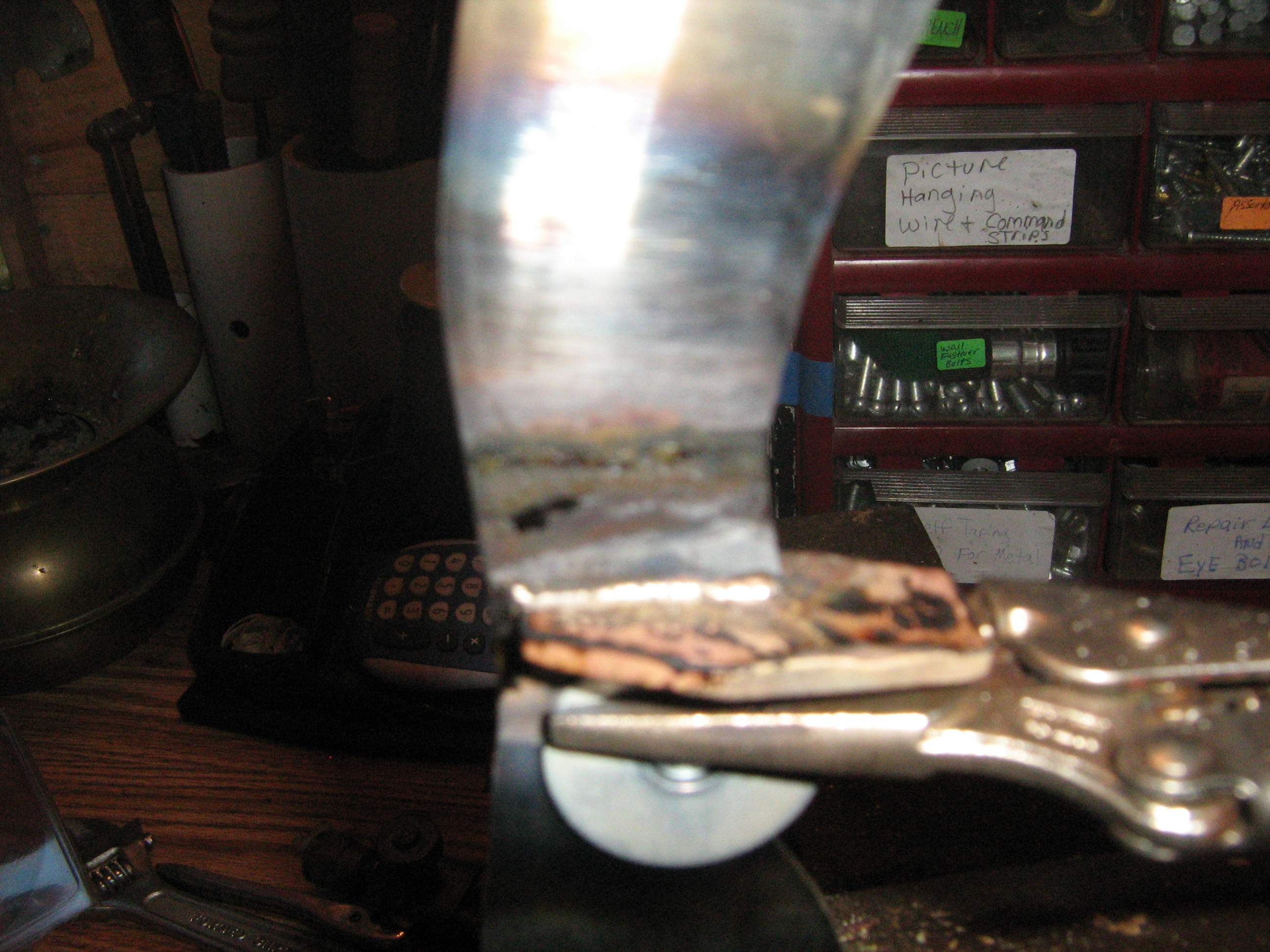

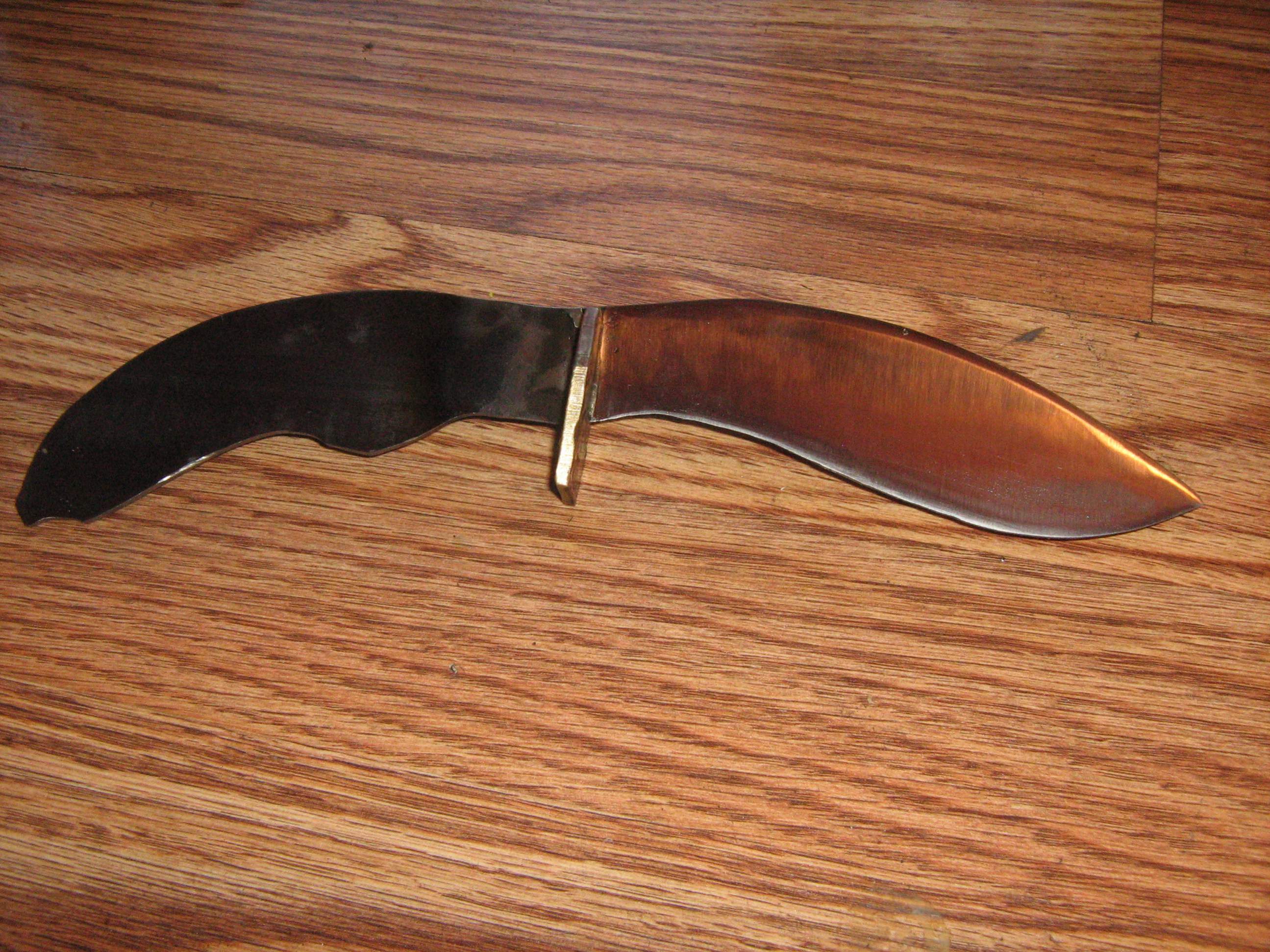

IMG_0550.jpgIMG_0551.jpgIMG_0552.jpgIMG_0553.jpgIMG_0554.jpgIMG_0555.jpgIMG_0556.jpgIMG_0557.jpgwell you just set your self up for many questions Thanks when I get ready I will let you know how it goes .Thanks Jeff
Its done the finger guard is on there was some clean up but for now its good enough.The guard will be shaped to the handle scales once I grt them installed, it will be much smaller. Thanks for all the help.

I looks like you did good, Very good for a first go at it. Only thing you might have done is get some heat on the blade side & pull the solder through. That is how you get maximum strength.

Thanks it came out ok I guess.Now you lost me a little heat on the blade side? The guard has a slot and there is blade on right side ,Left side, and top. I am not sure what you mean?

Pictures are good, but I can't see if the solder pulled through the joint. If it did great. What I meant was to apply a little heat to the opposite side of where you put the solder and pull it through. Solder flows to heat. (Up to a point - over heated and flows away.)
