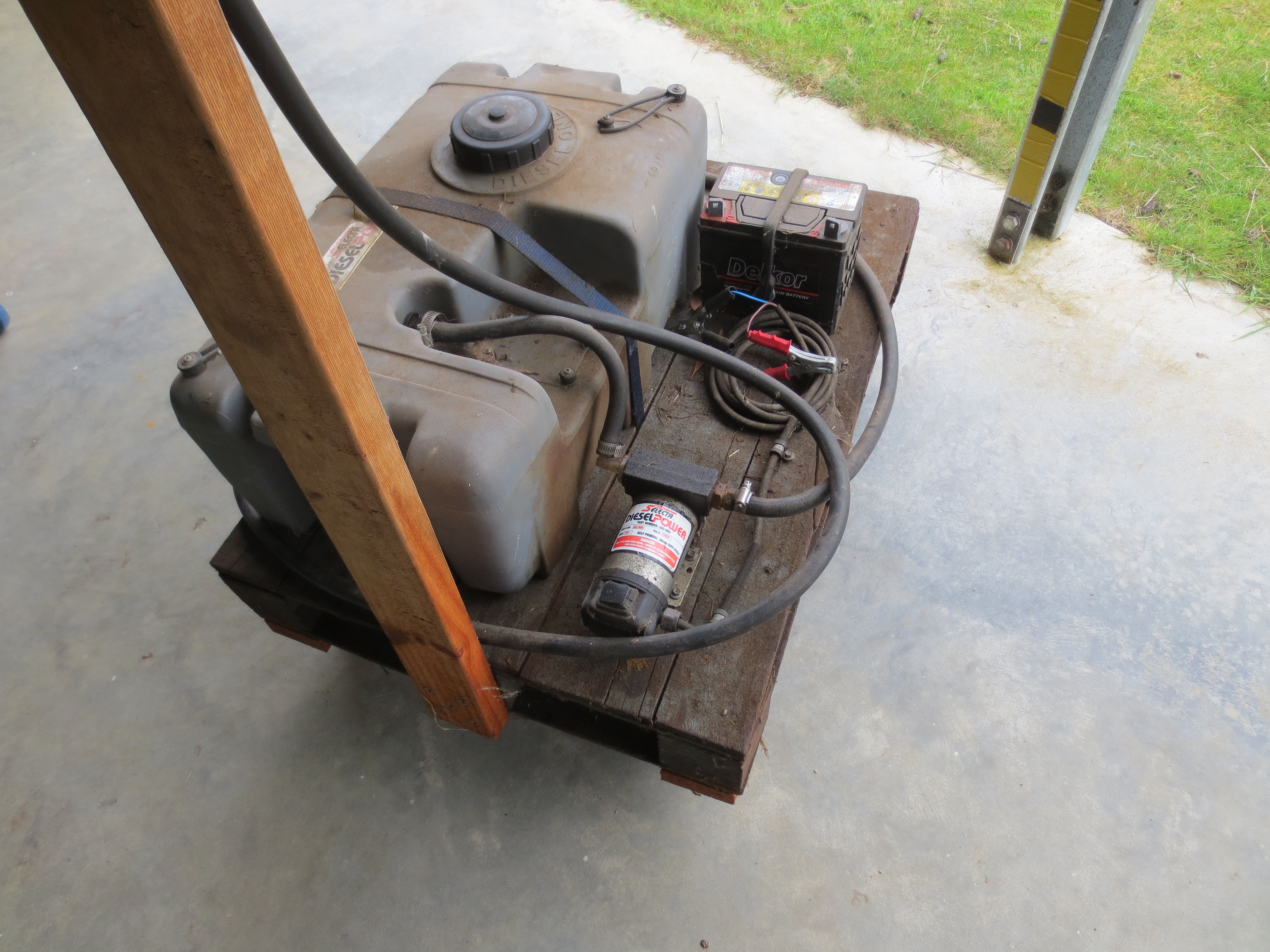

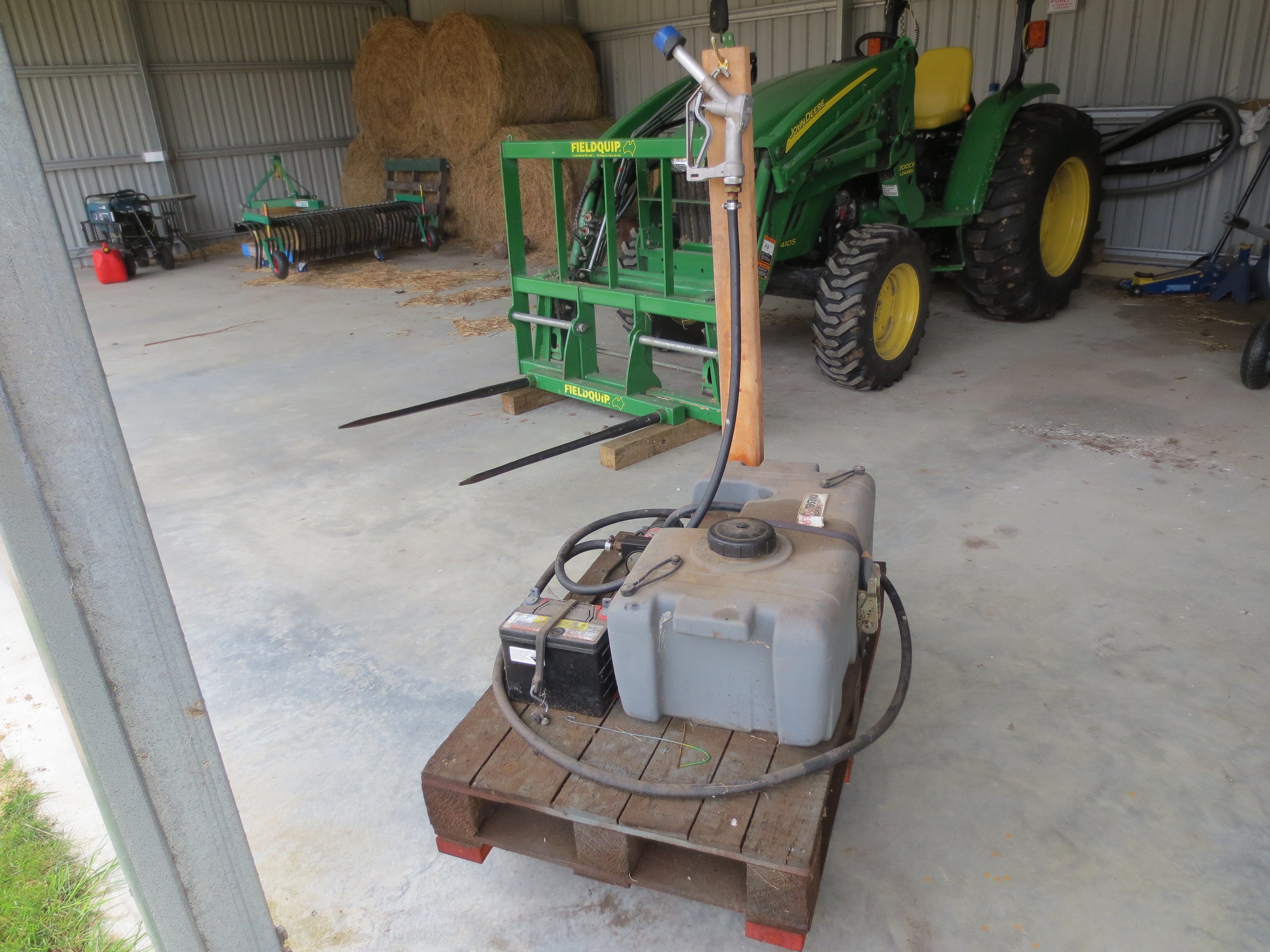

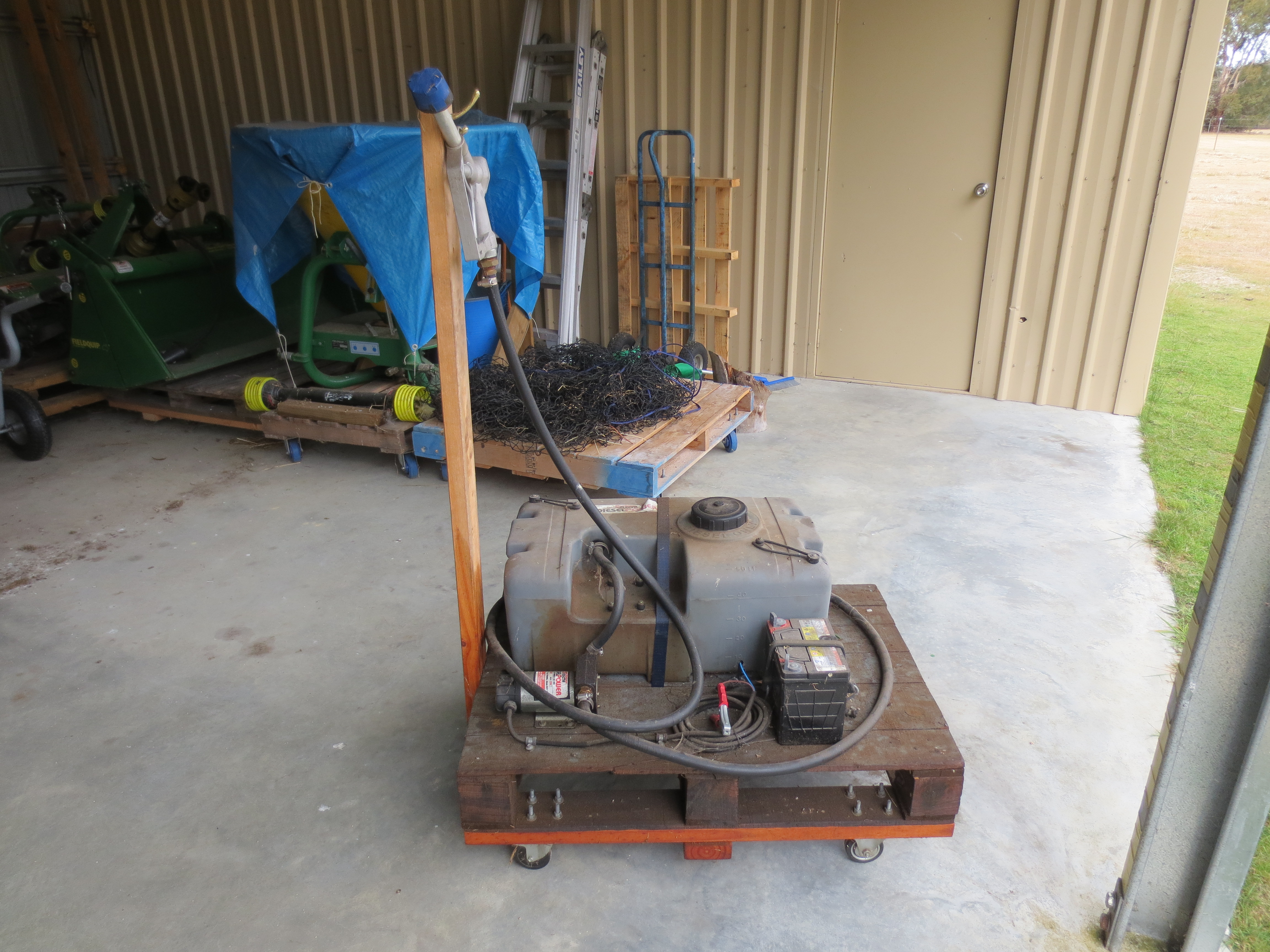

I tried using my tractor's battery as power to the 12V fuel transfer pump (I've got a 50ltr tank, pump & nozzle set up on a wheeled pallet). It worked using alligator clips but really became a bit of a pain in the arse.
I simply bought a small 12V marine type battery & mounted it on the fuel caddy. alligator clips onto the terminals when needed, off when not. Trickle charger every now and then when required.
Now with picture "goodness":
