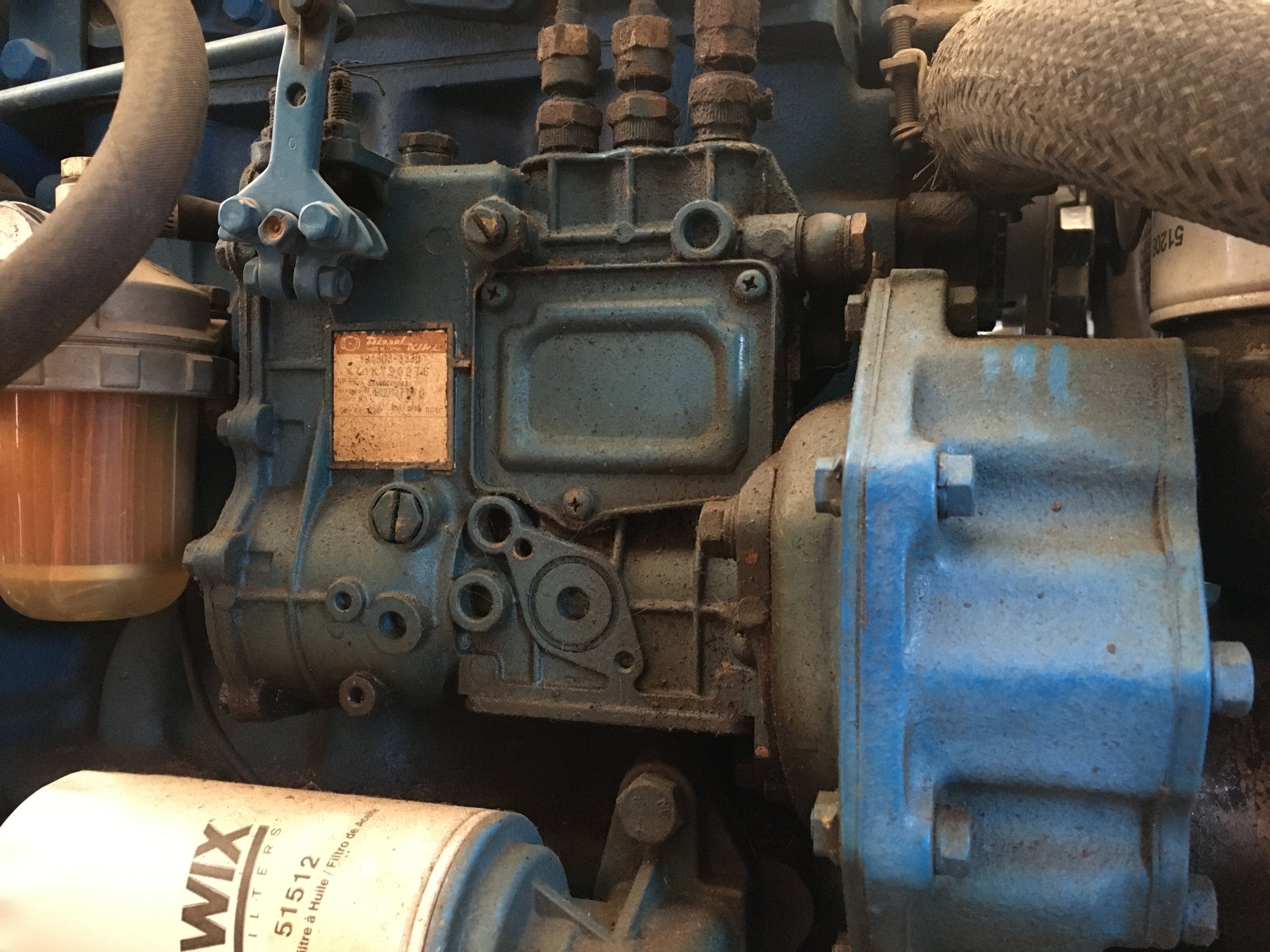

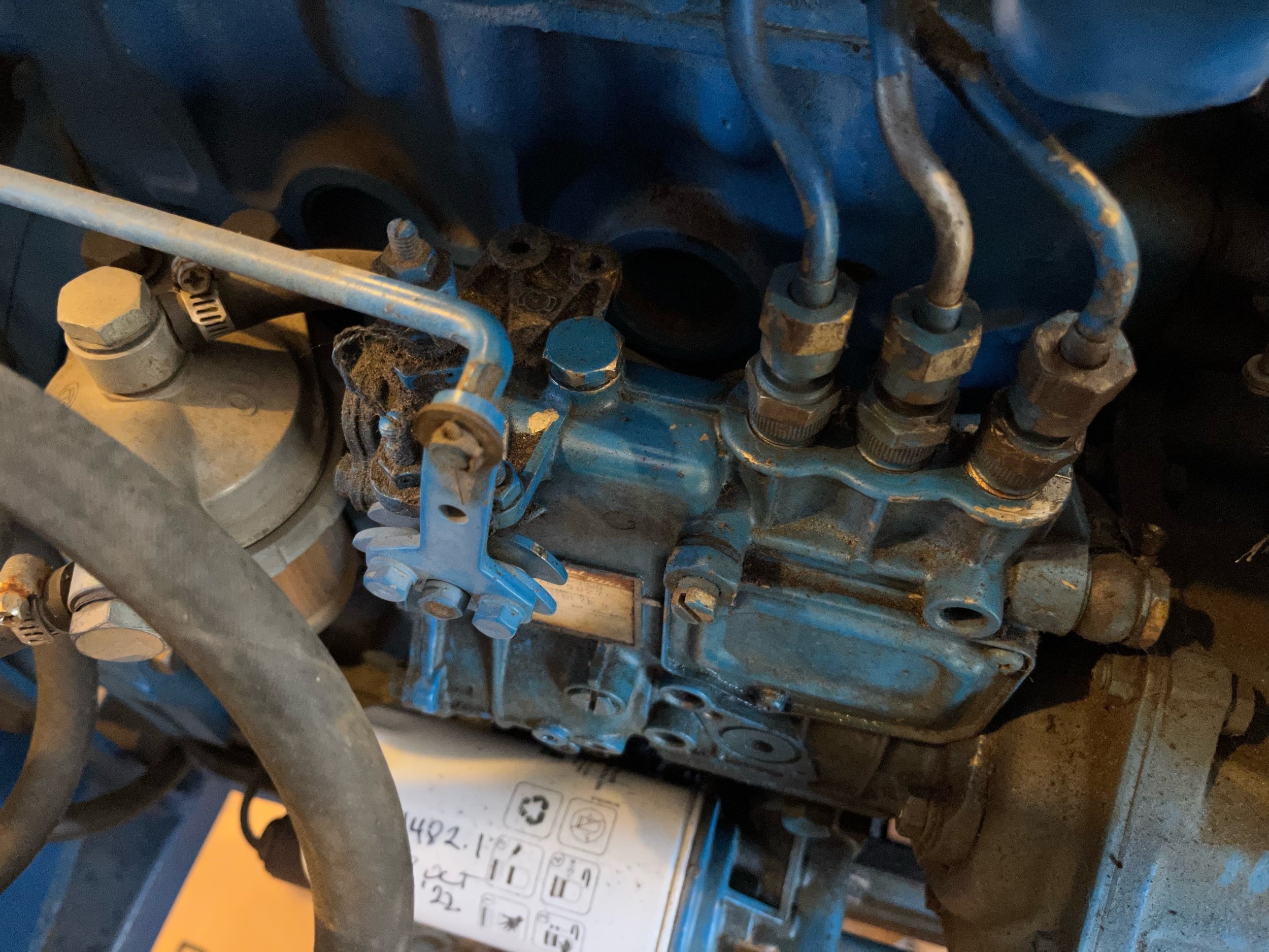

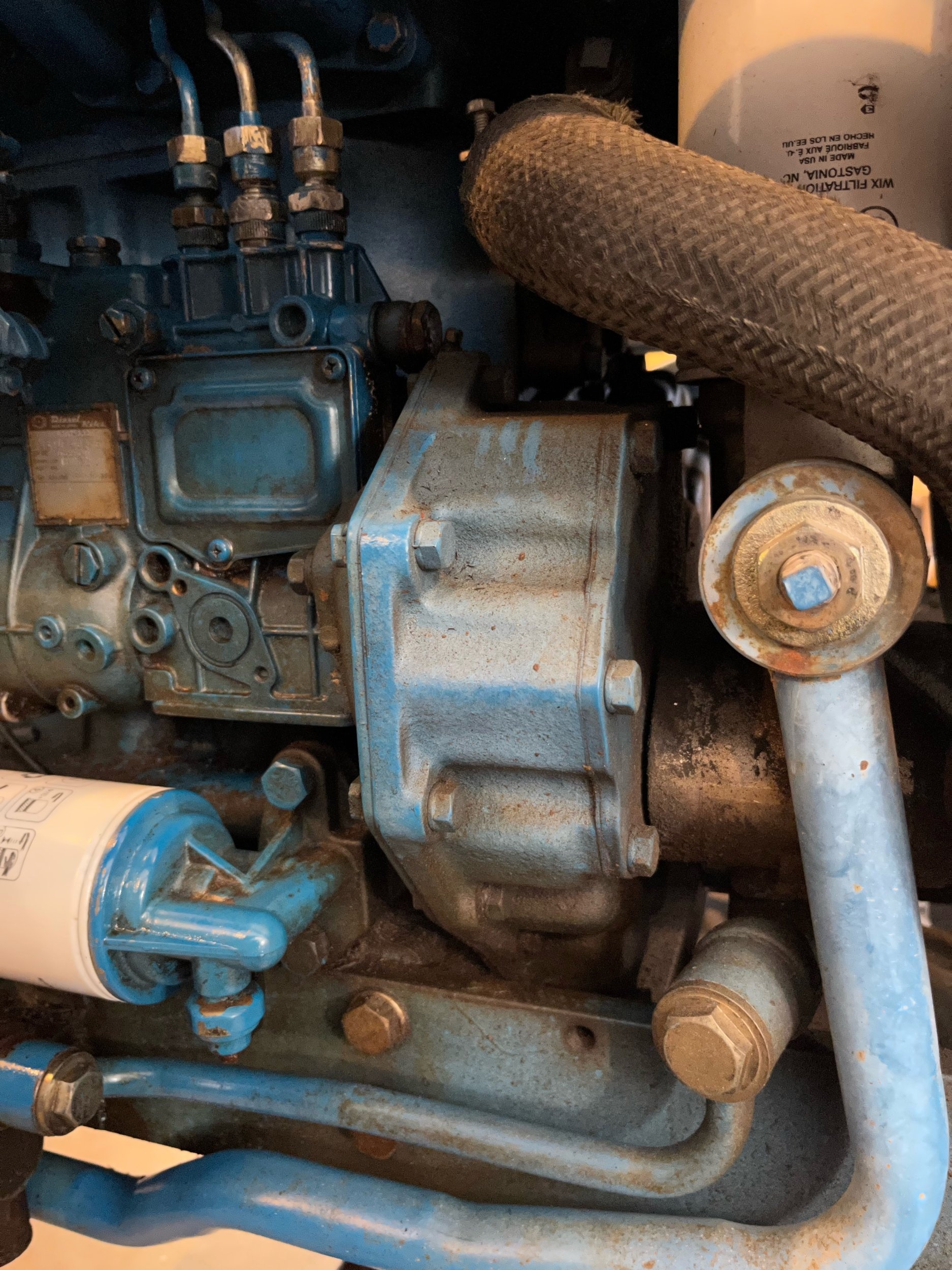

I am getting ready to remove the diesel injector pump on my 3-cyl Ford (Shibaura) 1910 tractor. The pump (diesel kiki) needs rebuilt and after that's done, I want to reinstall it with a minimum of timing and alignment issues.
Hoping for some general advice on how to accomplish this. Things to watch out for, etc.
Thanks in advance.
-Jim

Beg, borrow, rent, or make up an injector puller that will pull your particular type injector. Often some part of your puller tool will thread or clamp onto the injector while another part o the tool will then push down against the head to pull the injector out. Try to avoid slide hammers.... , but YMMV. Go slow. Use new washers when you torque them back in.
Wire them down if you are going to do a spray pattern check.

“Pump” Scotty.,
I’ve never removed one..
I do know u have to go thru the front to release it from the drive gear..
But as far as timing goes, idk..sorry..

Was figuring on the spray paint trick and etching any end shafts. I'll turn the crank to line up the timing marks before I pull it too. Hopefully, these things are robust enough that I won't offend it too much in the process!
Guess I need to find a timing cover gasket too...

Here's few pages from a manual regarding Ford 1910 injection pump.
It's not a dealer manual, rather something from online few years ago!
Sorry for the lousy text quality, it's a scanned copy of a print, which was probably scanned from original?
It is more or better legible if you zoom in in a monitor.

That looks pretty straight forward as far as lining up the S & T marks..
Do THAT and look for any marks on the mounting flange on the pump..
If none r found, make a punch mark on the flange and 1 on the block..
Don’t worry about the spill timing..
