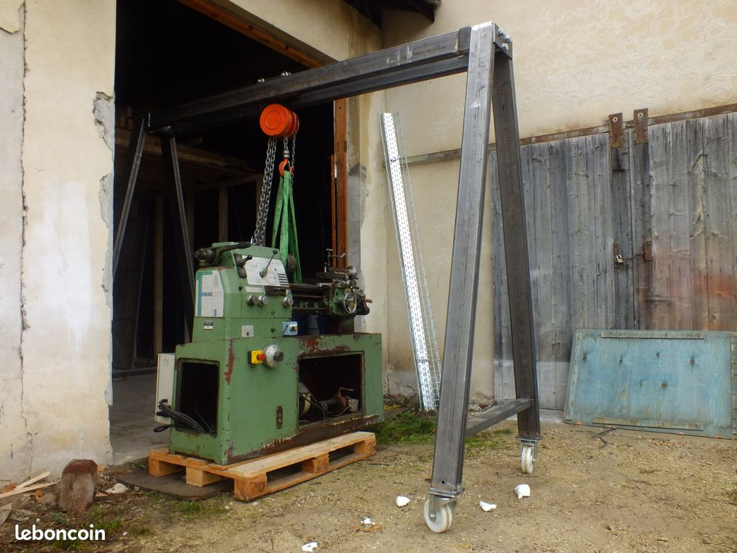

Cute little toolroom / second operation lathe. Not much in the way of swing or overall bed length either. I'd say it weighs less than 1500 pounds (US).

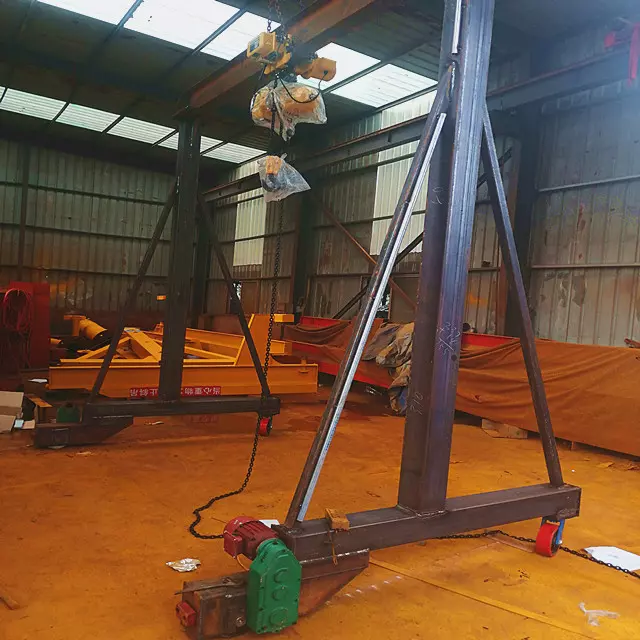

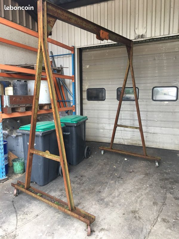

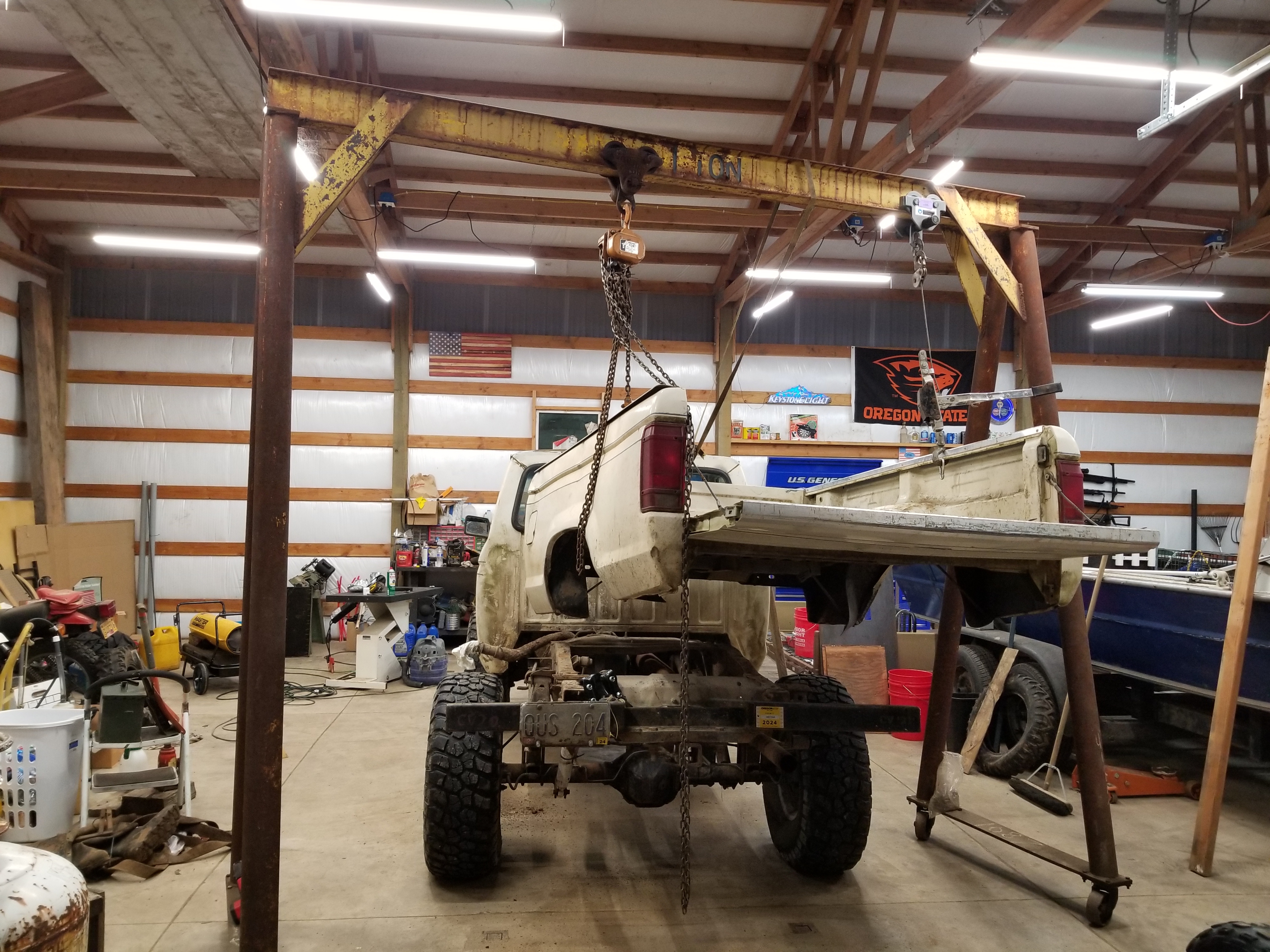

If I were building a crane that would go off-road, I would get the biggest casters I could and gusset the connection between the top rail and side legs more.

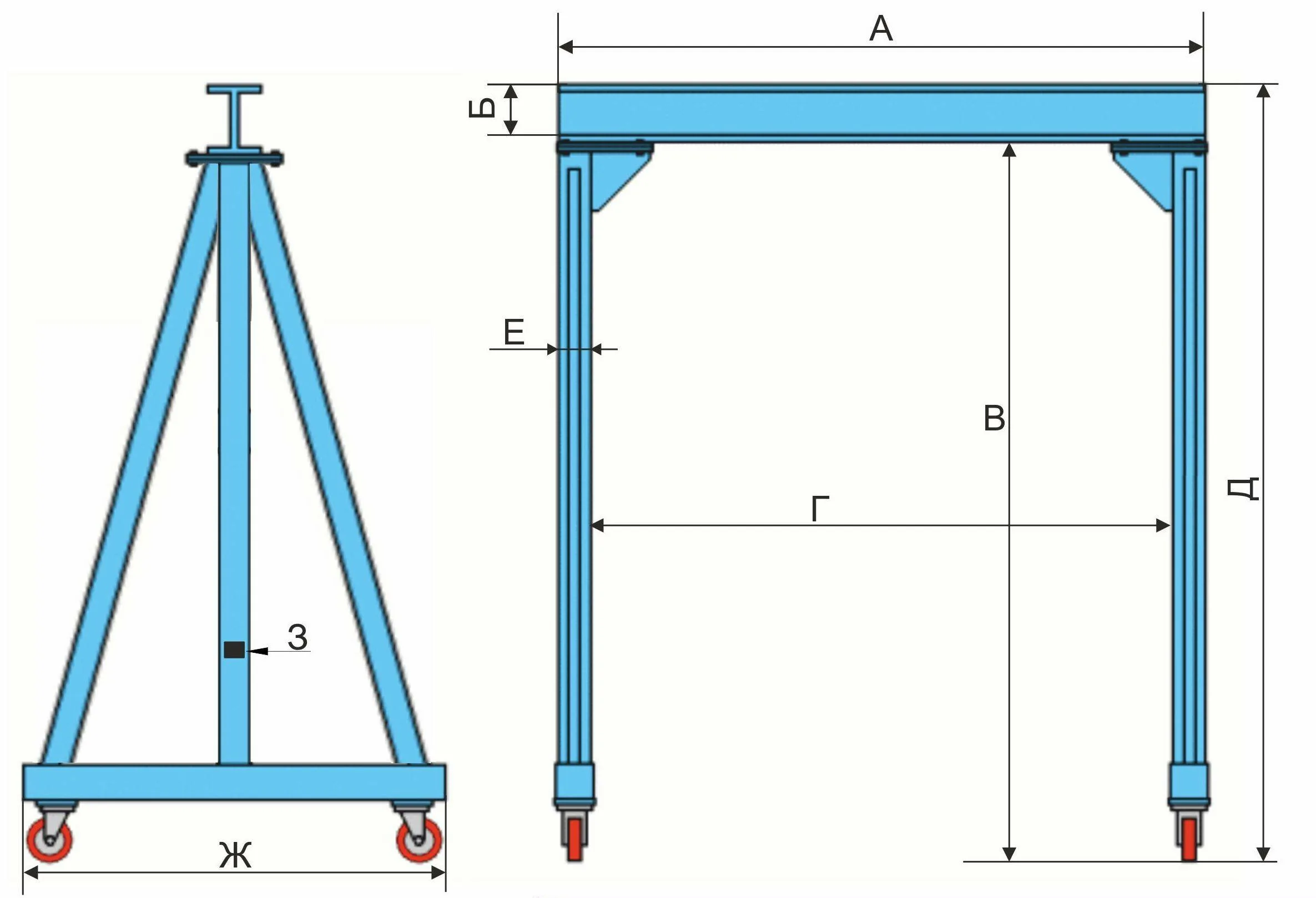

Dovrei recuperare le travi per la trave orizzontale e le colonne per le gambe, che materiale e sezione uso trave e tubolare o tutti i profili H o U? che sezione. se avete foto o disegni utili vi invito a mandarli nella discussione grazie
(Should I recover the beams for the horizontal beam and the columns for the legs, what material and section do I use beam and tubular or all H or U profiles? What a section. If you have useful photos or drawings I invite you to send them in the discussion thanks)

I agree with most above, if going off concrete the biggest wheels available are very important, I think I know the salvage yard bcp is referring to and they do work real nice.
I have one but it has ~4" casters so it is limited to smooth concrete.
I would get the casters as far apart as reasonable and as high as you have available, two trollies and two chainfalls make it way nicer to use for most things...
I'm not sure what's commercially available in Italy but if you have the ability making something shouldn't be too much of an issue.

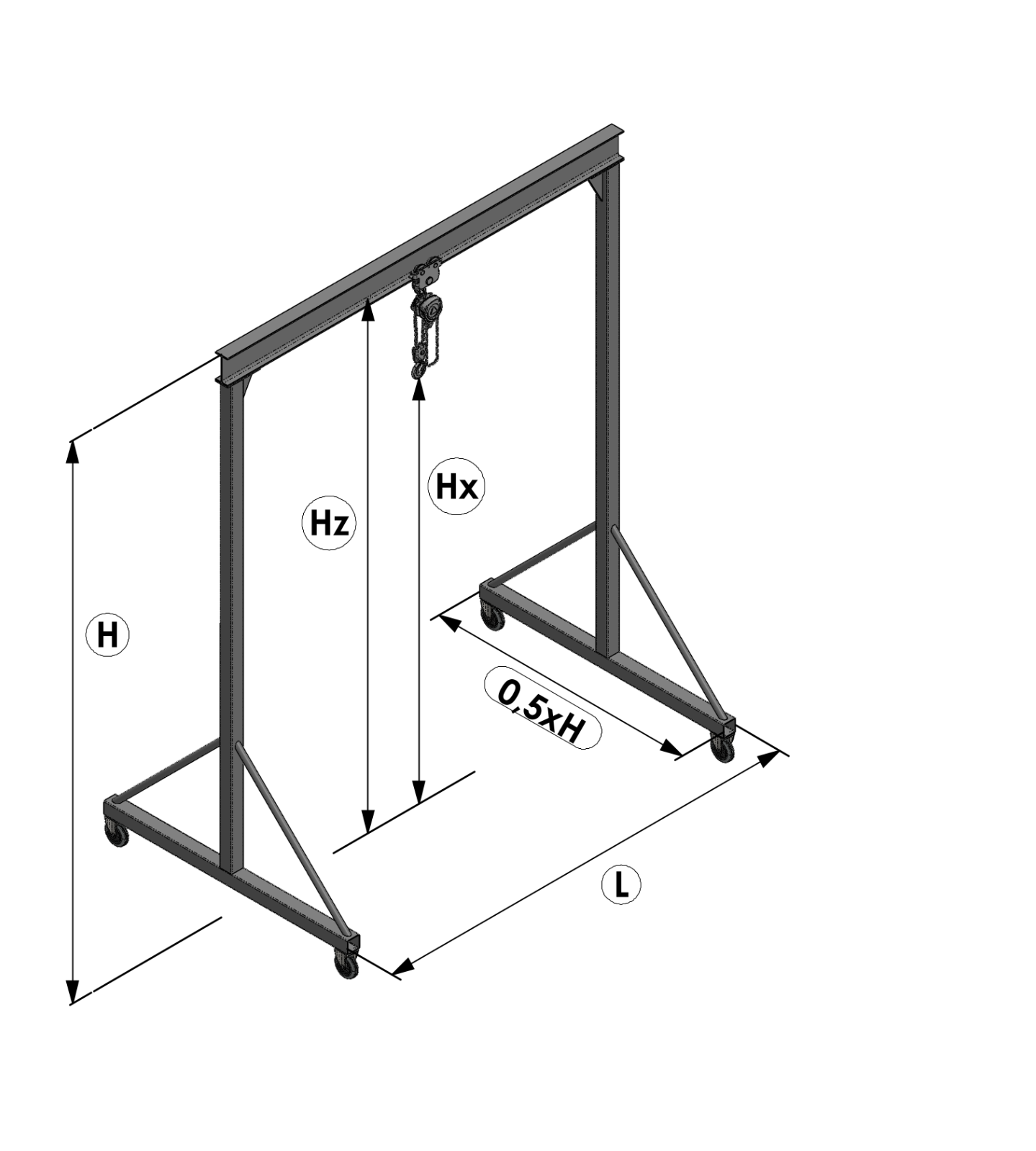

Grazie, potresti gentilmente allegare delle foto con delle misure di riferimento? Per la traversa penso che userò una trave ad H da 180 mm o 200 mm, credo che abbia la giusta capacità di flessione. Ho guardato le tabelle. Per le colonne penso che userò un tubo quadrato o una scatola rotonda da 4 mm di spessore e 100 mm di sezione. Cosa ne pensi delle proporzioni per i rinforzi o i profili a T o L o U? Ci devo pensare. Grazie. La capacità delle ruote è divisa e distribuita per tre, non per 4, perché a volte una gamba verticale non poggia correttamente in piano. Grazie.

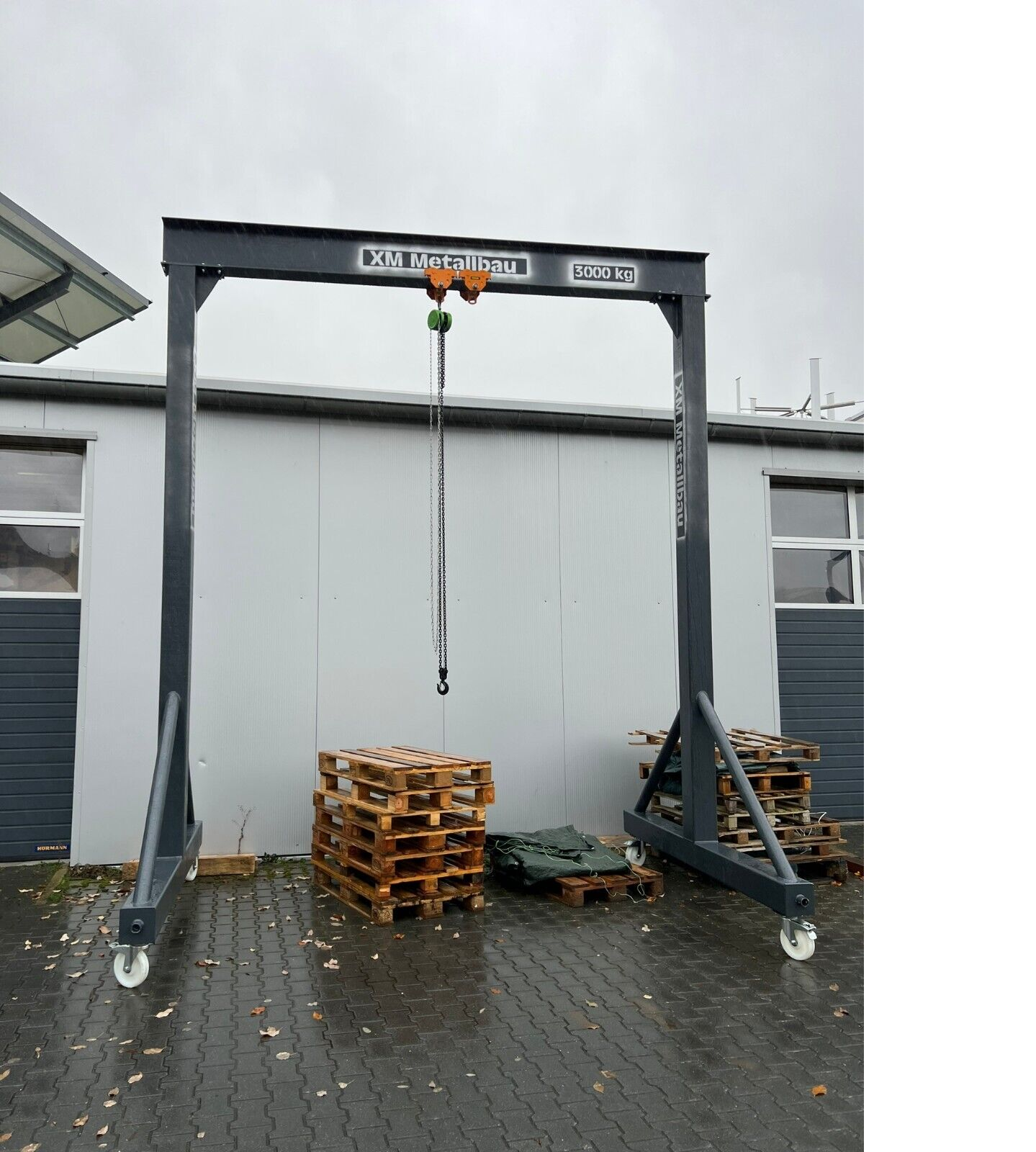

Never side load a crane.
Power hoists are nice for repeatable large loads. Manual hoists offer high precision adjustments.
Power or chain travel along the beam a nice feature.

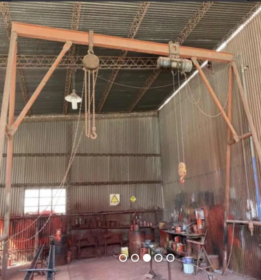

tornando al progetto, ho trovato il paranco manuale a catena in un negozio locale. Ho visto il carrello per la traslazione del paranco su internet. come trave orizzontale penso che un H di 200 mm sia sufficiente.
Devo dimensionare i cavalletti laterali ad A oa T rovesciata. Devo dimensionare le diagonali, i rinforzi ei rinforzi. Ho trovato le ruote ad alta capacità molto costose. Mi pare che un amico abbia detto che nel capannone c'è una trave monorotaia, vorrei gentilmente allegare foto del fissaggio della stessa grazie alla traversa del binario e ai pilastri scusa se ti disturbo saluti
