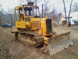

I'm new to the forum, but I've been reading and reading posts trying to learn as much as I can from you guys, thanks.
Like so many, I find myself a victim of a really bad logging experience. I said that as politely as I could. heh. Its a pretty large job as far as time, it would take quite a while to clean it all up. Renting a dozer, with the weather off and on like it will be for the next few months, doesn't sound cost effective. My time too, its not completely dedicated to dozing all day. Anyway, I've found what I THINK might be a good dozer for me. Its a 1987 JD 450E. Its been owned by a fella that bought it a few years back to kinda do the same thing I need it for, push tops and dug up stumps and such. Its got some dents and dings from pushing top piles. Its got a cab, which I think is unusual for an older 450. The cab is missing a few panes of glass but does have A/C, he says it works. It's also got some sort of wings that attach to the blade. I guess these wings pivot on pins and can be set at different angles to create or valleys or crests. They fold up, but are quite tall, so he took them off, which I guess they go back on easily. Not sure how these work exactly or how wide the blade is with these wings deployed. Most likely useless for me though, pushing rocks and red dirt in the hills of Arkansas. It also has rippers.
The story goes it came from a contractor in California that built roads. It pushed gravel for road beds. He rebuild the undercarriage the sold it to the guy I'm getting it from 2 yrs ago. This guy has a small piece of land hes worked with it and it hasn't left his place as long as he's had it. He says it perfect and runs strong. He has not had any issues with the dozer at all. Says it steers crisply and snaps right into gear. Doesn't get hot or have any leaks. Other than a few lines, he hasn't had to do a thing except change oil abd grease it. He is NOT a dozer guy though. I'm not either really. Kinda a scary situation, hehe. I haven't bought this thing yet, but looking at whats for sale around here it SOUNDS like a solid deal on something that I can use for a while and resell. In the market now there are several dozers in this price range ( he wants 12k for this dozer) but most are older, much older, or just too big. I know a D4 or a 850 would do the job faster, but I don't want a dozer that large. Too hard to get hauled around, maneuver in the woods and such. Plus, most in that price range are mid-70's D4's or older. Seems pretty old to me.
So, I said all this to ask....Does the deal sound pretty good to you guys? Also, as far as the 450E in particular, what should I watch for? Thanks so much for time and opinions.

That price sounds pretty good. Most 450s of that vintage in my area are probably more in the 15-16 range. The guys I work for used to have a 455e high lift and I know it was a pretty good machine for them. That cab makes it pretty unique too. I've never seen one with a cab like that.

Dbaer78, Here too, most 'newer' 450's or 350's for that matter are in the high teens here. Also, I have been unable to find one with a cab period, unless its a 2005 model or something. The cab needs some work. Possibly some expensive work. Its missing a few panes of glass and the right door. I guess a stump popped up and smacked the door and crushed it in. He just removed it. I've been googling around trying to find replacement parts for it and haven't really had much luck. I'm thinking if I can fix it up cheap enough it will be money well spent. As long as I don't break something else that is....which is likely. I haven't seen it in person yet. Its over 200 miles away so I want to be as armed as possible before I run down there and look at it. I've quizzed the guy to the point of pestering...lol. So, all that is left is going to see it.

The cab looks to be after market. I'd be more concerned about the transmission.

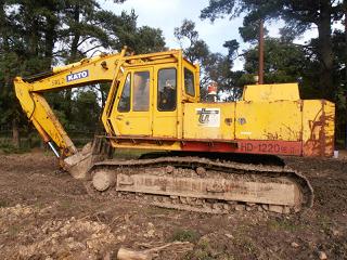

As an example we picked up the 20T class Kato1220se pictured for $15K last year, mechanically/hydraulically/undercarriage sound & at 5000hrs reasonably low houred/looked after (i.e. no demolition or hammer work), sure it isn't a popular machine (& there's no way I'd use a Kato in our contracting operation) but for the $'s is a reliable "clunker" to be abused/bashed around by our farmhands - whether we run it for another 1000 or so hours then easily offload it for roughly the same as what we paid, or maybe run it to destruction (@say c.8000hrs, picking up a couple of thousand $ or so for scrap) on cost/hr we'll be in well in front (even against running our own current model excavators we use contracting).

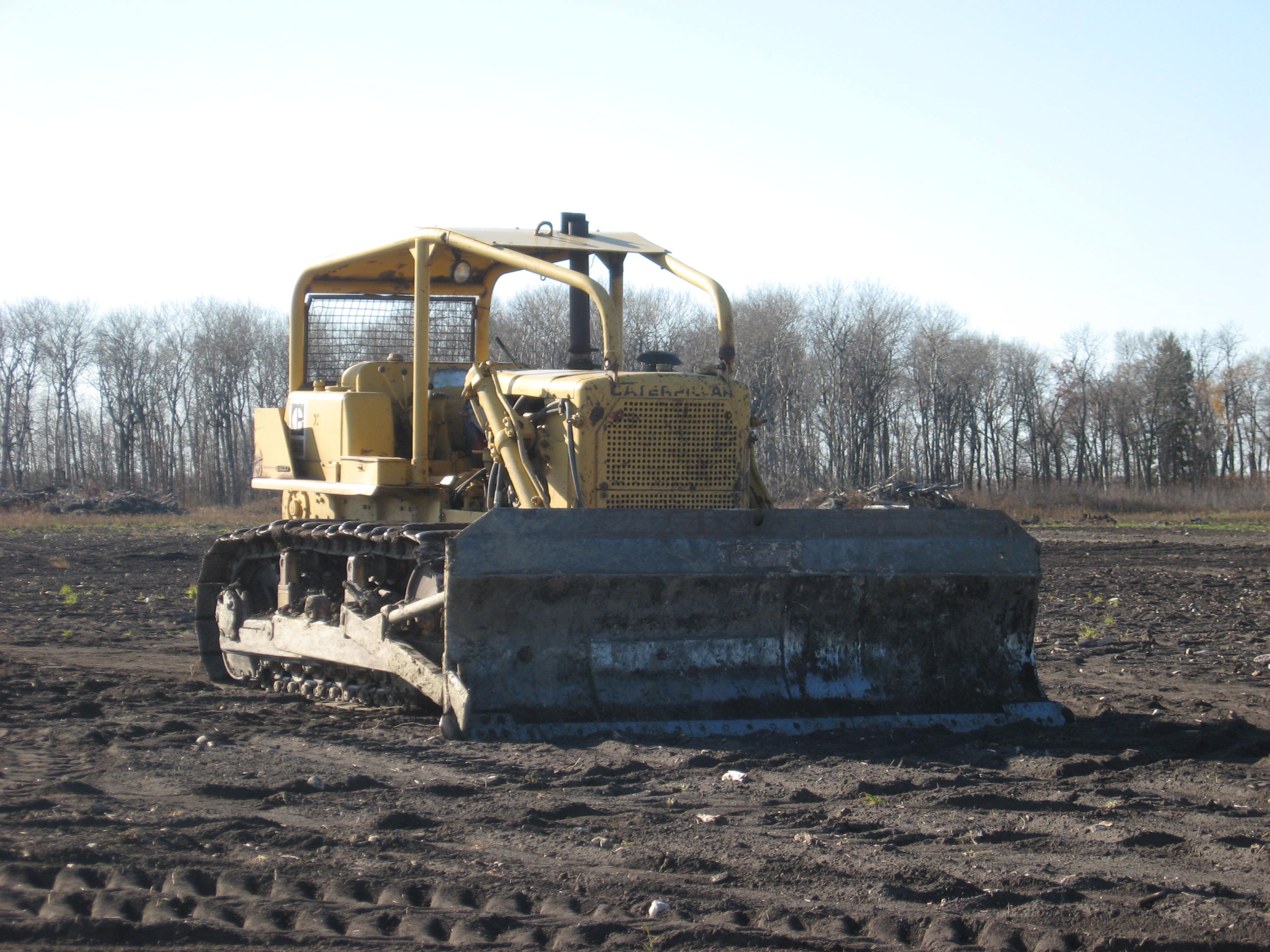

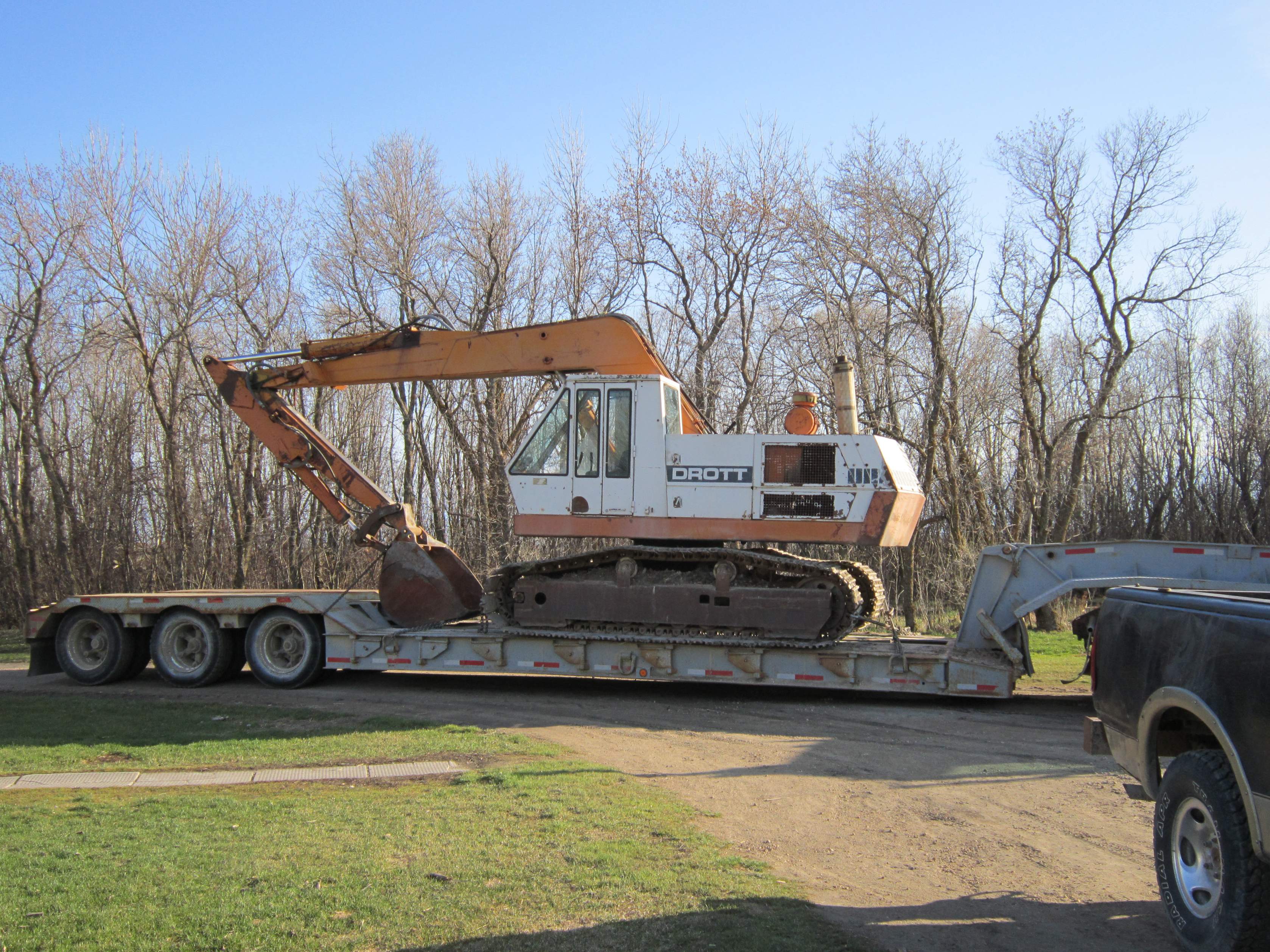

Just for our own farm maintenance and tree clearing we have a 1968 Cat D7e that we bought 7 years ago for $14'000 knowing it had one cracked cyl head and this Drott 40 we bought for $5000 last year with bearings shot in one final drive and had been put out to grass .

Jdtractor, Thanks for the insight, especially since you own this model and year. I went ahead and bought it today. Its not going to win any beauty contests but seems solid. I ran it for about an hour, pretty hard. The trans temp never really got over about 1/4 into the green, same with the engine temp. It started right up and didn't smoke a bit. It steers crisply and clutched and ran thru the gears perfectly. The only thing I noticed is that when shifting to reverse it seemed to have a slight delay before it engaged. But, it wasn't a slip at all, just a pause. I'd say less than 1 second. This happened warm or cold. The owner said he always clutched between directions using the powershifter. The U/C was documented being replaced 1 month before he bought it 18 months ago. It was 100% when he bought it and he says hes put about 200 hours on it in the last 18 months. Tracks and sprockets look great. From looking at his place and the work hes done, I agree with the time. Also, he obviously didn't work it too hard doing what hes done. The 6 way balde is a bit loose. Bushings I assume. All the hydraulics work flawlessly and I didn't see any leaks. The oil was black, as expected, but it had good viscosity and not milky or anything. Hydraulic fluid was clear, looked good.
I wasn't able to work it real real hard, it was pretty muddy and it was around 32 degrees outside. The cab is missing some glass (its an aftermarket cab I found out, a Sims) and the air units wiring was not connected, but he said it worked for him. He just didn't use it because he broke out one of the front windows so it was sorta worthless. The ripper worked as designed. The slope boards were removed but they were there, cylinders looked good on those.
Other than being dinged up and ugly, I think its a solid rig. Hopefully Im not wrong. Thanks for everyones help!

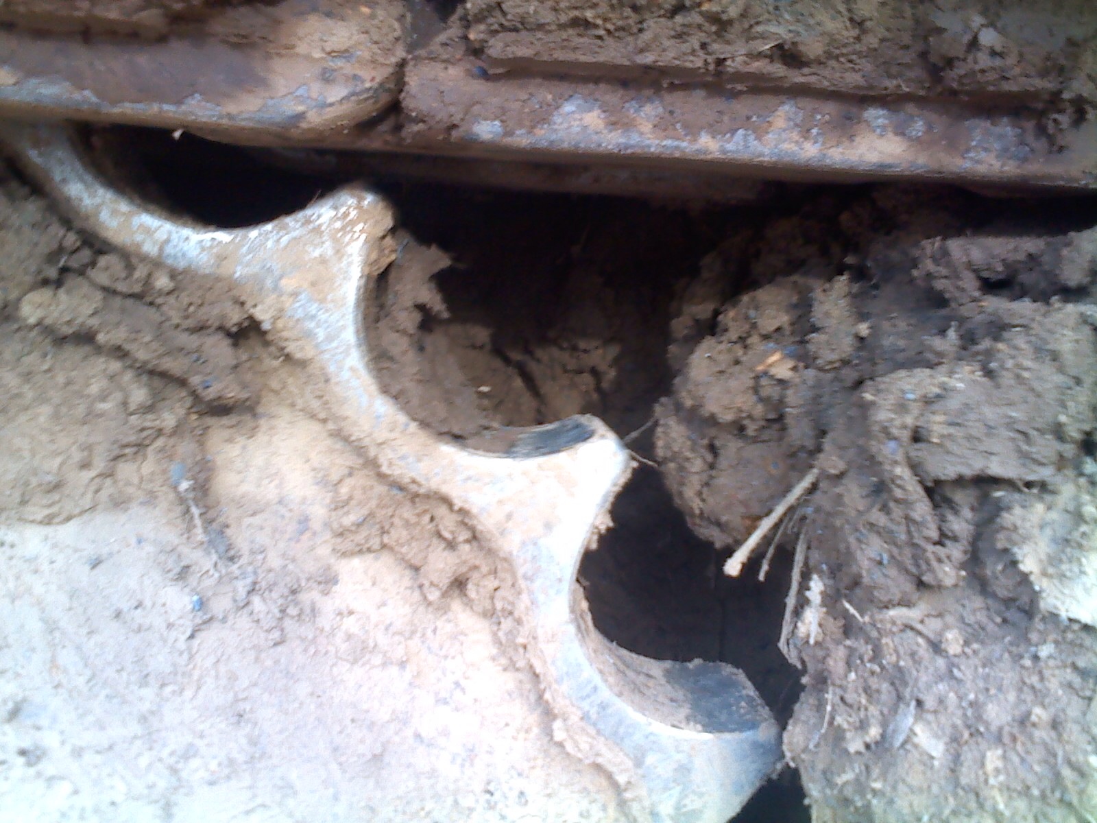

Anyway, it sounds like you got a pretty good machine, that one sprocket and chain pic looked pretty good. Congratulations.
