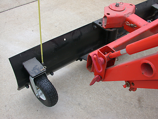

Hello SensibleNick,
I had the same situation as you when I bought my tractor 8 years ago. On the advice of a couple of friends I bought a 6 foot back blade for snow. But I couldn't see driving over the snow before I plowed it much less constantly turning my head to make sure everything was going right. So I made a cross piece out of 2x6 tube steel to attach to my loader arms with a "receiver" in the middle. The receiver is sized to fit the tube frame of the back blade going to it's head. I, of course, cut that frame member in half and the half with the head gets pinned in the receiver. The first year I had to manually change the angle. After that I added a cylinder to change it. I have about 1000 sq ft of concrete in front of my garage and about 200 ft of gravel driveway. The concrete I scrap clean by adjusting the curl but the gravel drive was a problem. I could adjust the curl so the blade ride on the pads but that didn't work too well if the gravel wasn't frozen. So my solution was to add gauge wheels and I can adjust the blade up as much as an inch above the gravel. There is no trip function but the only time I found this to be a problem was if I had the blade straight and hit a slab that that was raised. I discovered that a little angle on the blade prevented a jarring situation. I have been using this setup for the past 7 years and it has worked very well for me. I especially like the fact that I can push snow up about 7 feet high. Here's a couple of pics of my setup.
There you go... that's the main reason I want to do this. The second one is beacause I dream of a snowblower.
For me the main enjoyment of a project is working out how to do things well and neatly. Looks like you've got a pretty neat solution there. I'll be using my blade without it's top-mount, and making a new swivel system that'll not only swing the blade, but offset it towards the side it is swung to. (pics to follow one day when I've got around to finalising it) I had also considered wheels or skidder plates, but I'm slowly starting to realise that a rounded steel cutting edge (2" scaffolding tube?) would save my dirt-road driveway and gravel area infront of the house more effectively than wheels or skid plates... and despite earlier convictions, I'm still unsure about the necessity of a "trip". I aim to move slowly pushing large mounds.
I don't need a perfectly cleared area, just enough to allow cars to get to the house. 4" of snow left on the ground is actually acceptable.
My main aim is to keep the blade as close to the FEL as possible. I had considered neat trapezoidal linkages, but despite being engineering heaven, it was getting way too complex. I'm now down to a couple of pivot points, and achieving nearly the same geometry as my over-complex system.

Thanks for the comment on my cab. I was told it was from an older model Kubota when I got it from a friend. I used the front piece (with new safety glass), the top and rear supports. I had to make some frame pieces to allow room to operate the FEL control and pedals. I custom made the soft sides. It's small enough to keep my body heat in on the coldest day. But best of all it keeps that cold wind and blowing snow out.
A tube on your cutting edge is a good idea and used by many here on this forum. It's an elegant and inexpensive solution to prevent ripping up your gravel. I have to agree with you that I think sometimes it's as much or more fun fabricating something yourself and then putting it to practical use. Good luck with your project.
