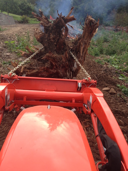

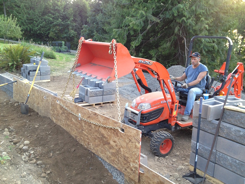

Not sure what is your point on under-sized tractors and use of hooks, but if I understand right... I have a BX and I get plenty of use with my hooks and chain. :cool2:
