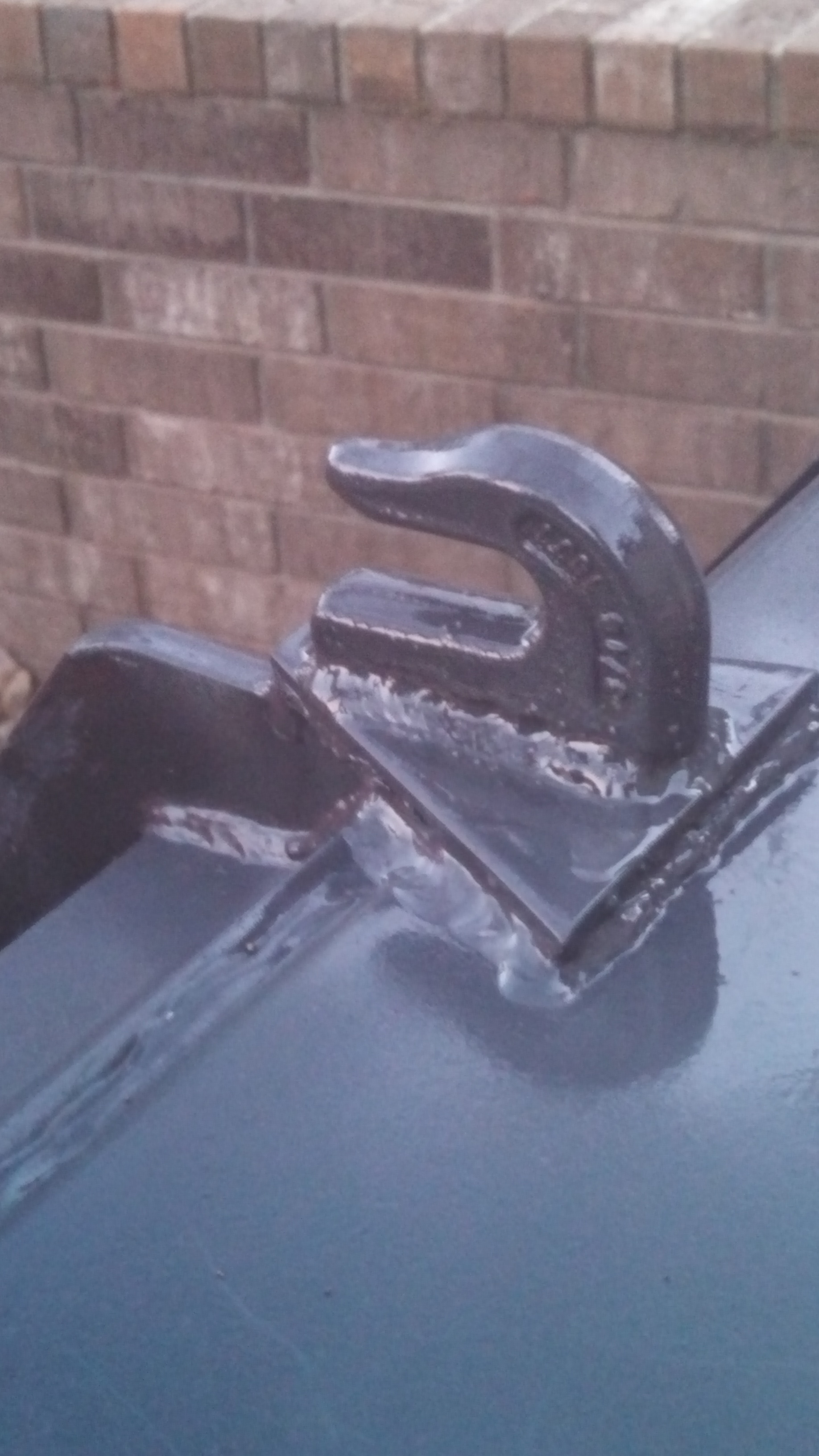

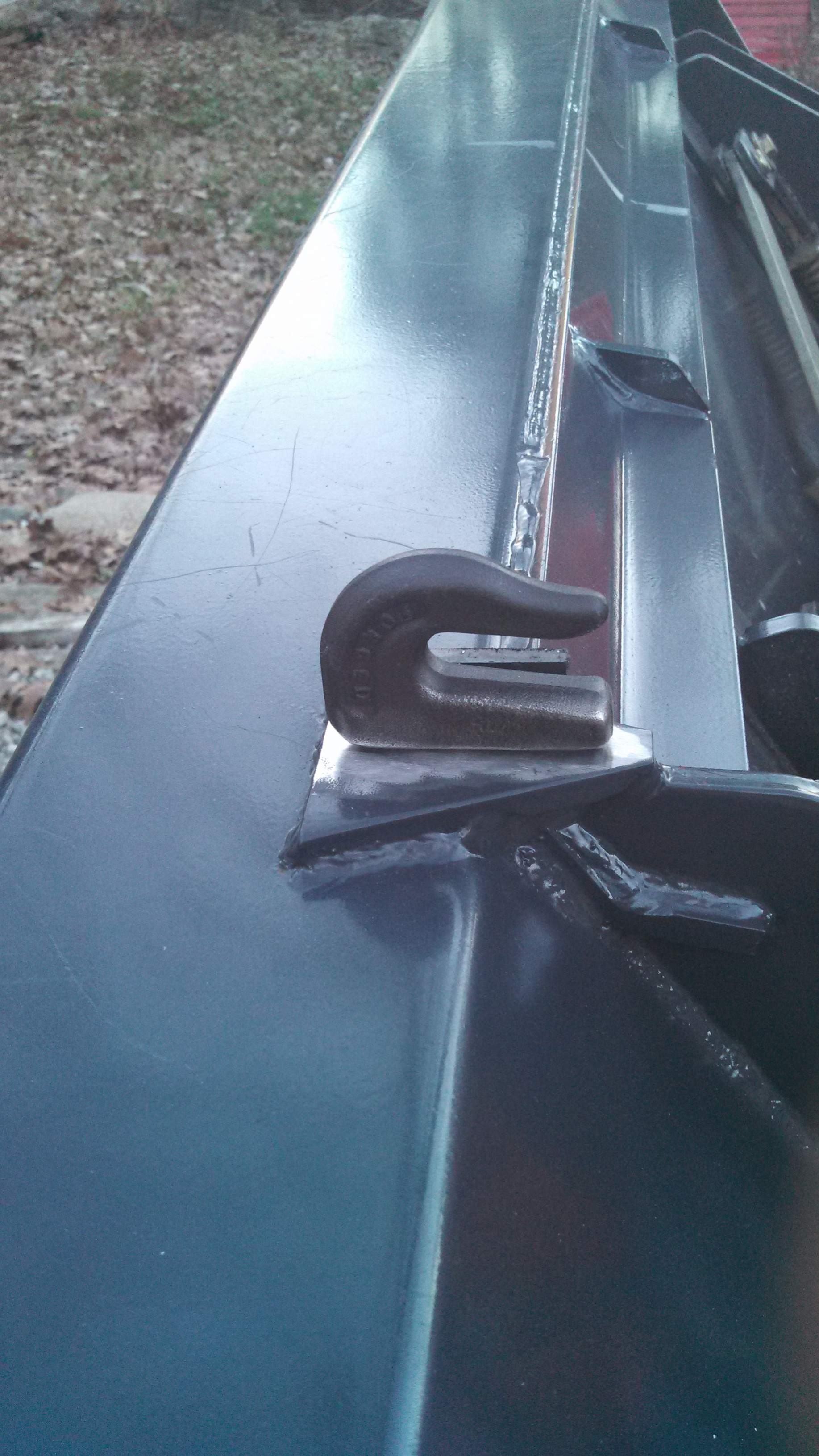

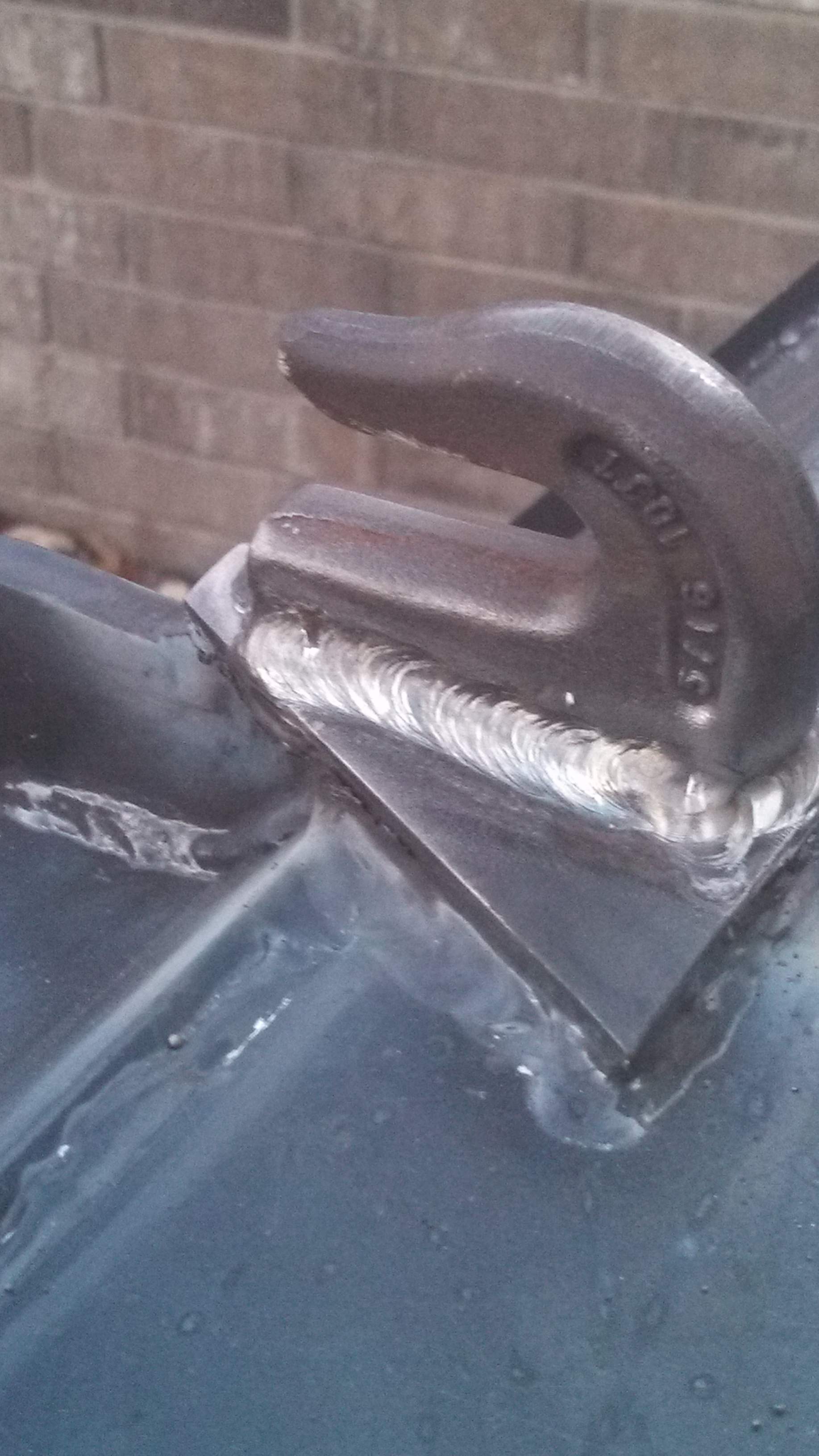

A lot of different ideas floating around here. Do what works for you. I have always used 5/16 weld on chain grab hooks. I use chains for all my pulling/lifting. It is easy to attach and remove the chains.

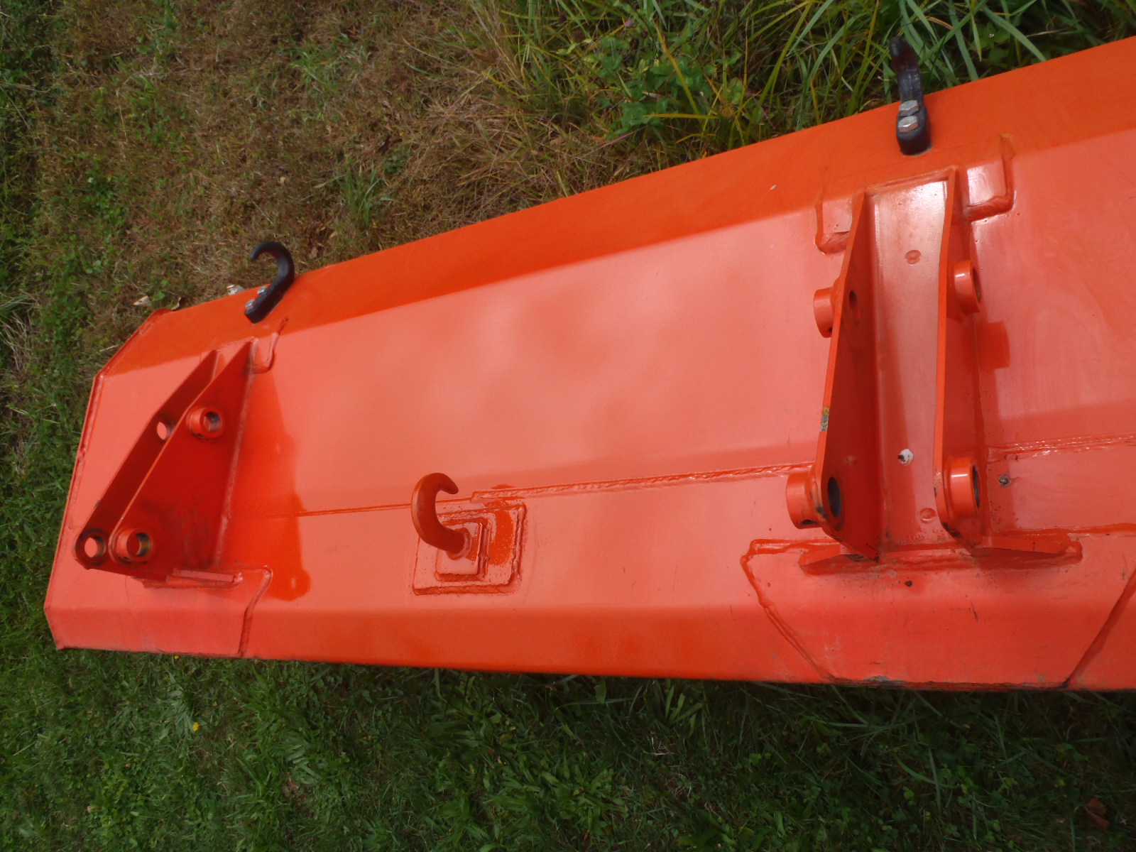

I prefer 3. Link hooks at the ends of the bucket. Slip hook in the middle. Seems to give me the most versatility. I also prefer weld on. I also reinforced the bucket lip to add strength.
I also just realized I only have one pic, and it ain't very good. Sorry. :)

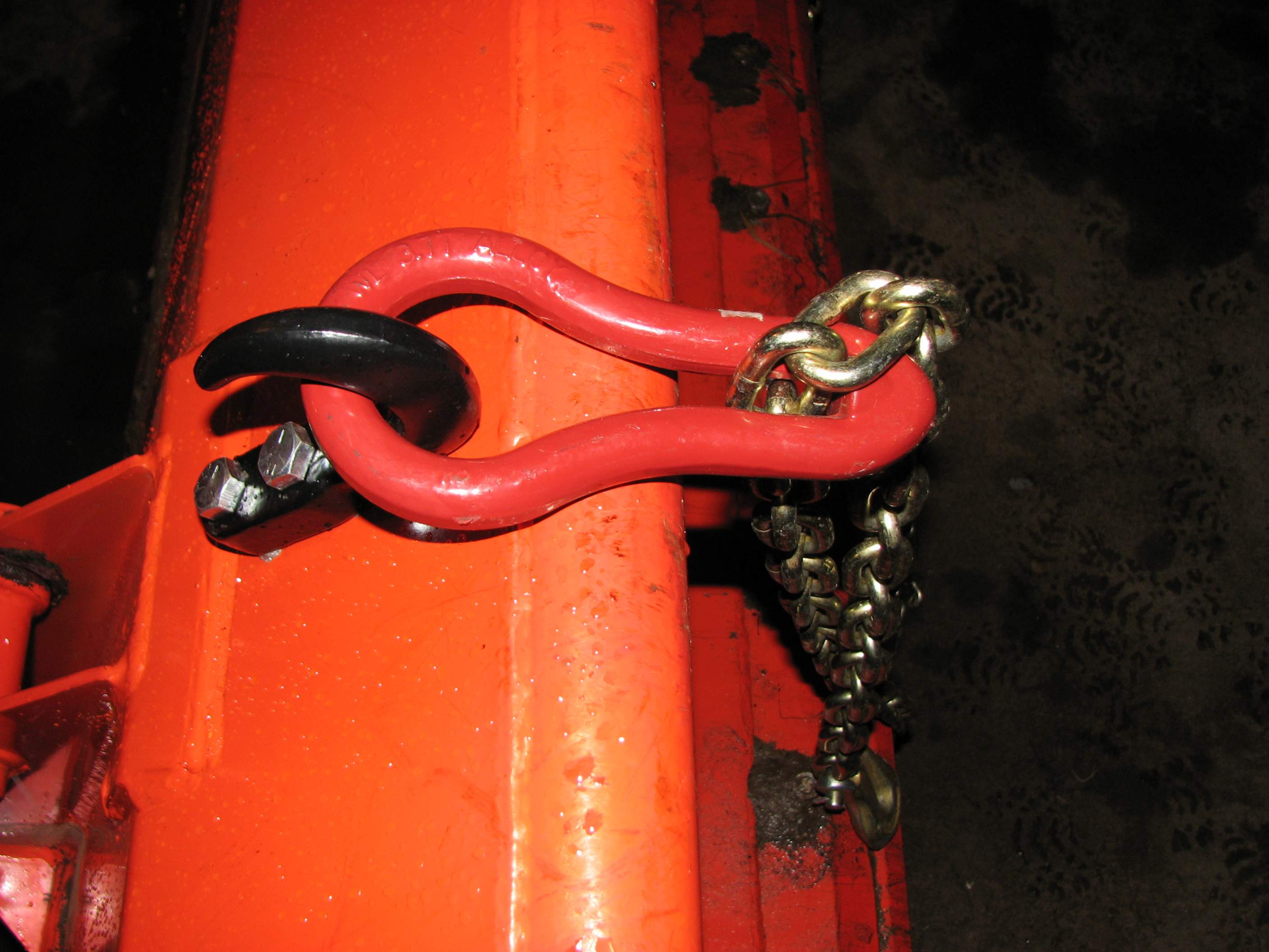

Have you seen the new RingSlings we are making now?
