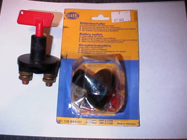

I was wondering if any of you have had success childproofing your tractors. I always put the implements down and release hydraulic pressure when I'm not using the machine - that's not really my issue.
The problem is that the new BX22 tractor is a **constant** magnet to my 4 year old, and he is getting on the machine and turning on the hazard flashers (which don't require the key to turn on). It seems he's not-so-good at turning them back off. #$%@!
I looked under the dash and it looks like that circuit (and all the others) come directly off the back of the key switch (no easy reroute to the 'key on' side of the switch without cutting up the wiring harness). I either need to move that circuit or cut off the battery completely when it's not in use.
On my boat, I added a large red battery switch which is locked in the bilge to keep them from playing with the trim switch on the back of the motor...but there's no room for a switch that size on the Kubota.
Any ideas?

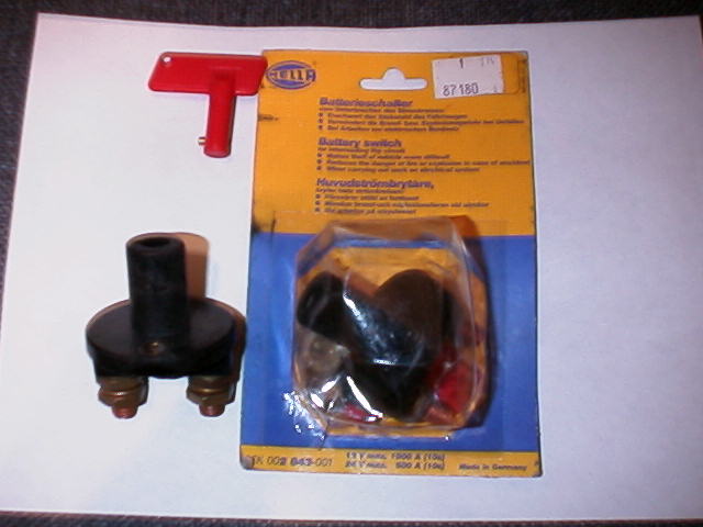

Here is a photo of the switch I have used on several projects, like RV's, Boats, And tractors.
It is a batttery disconect switch made by Hella of Germany, sold by most auto parts stores, Boat supply stores etc.
It will handle 1000 amps at 12 Volts and is 2" in diameter and 3 inches tall without the key inserted.
It should fit several places on the BX series.
It might not stop a determined thief, but it will slow them down, and should keep a child from playing with the electrical system.

Another photo of the switch with the key inserted
