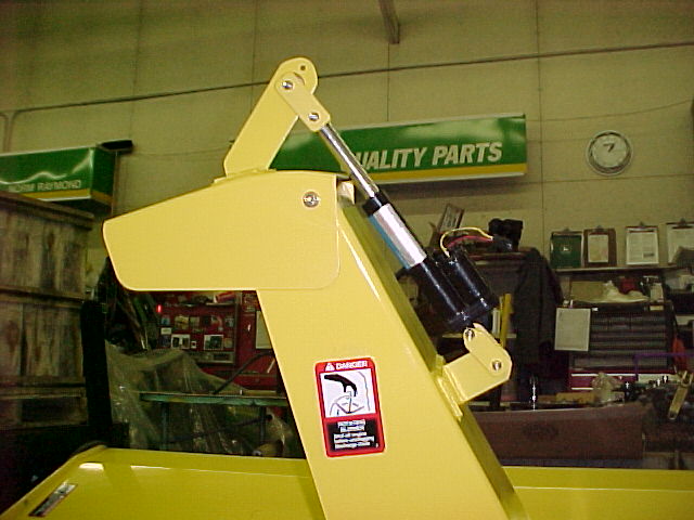

Now that it is the end of snow season I finally managed to score a snowblower for my BX. It came with an electric motor for the chute rotation - but I would like to add something to manipulate the chute deflector at the top of the chute too. I did a little research and it looks like the way to do this is to use a linear actuator. What I would like to use for a control is a joystick - figured doing this would make it very intuitive - up-down on the joystick is up-down on the chute deflector - right-left is right-left on chute rotation. Anybody have any advice on where to source these parts (joystick and actuator) . I did some searching on Ebay and found linear actuators, only info I could find on a joystick was marine joysticks.

We needed to install one on a JD 59 blower on a 4310 for the next village over,, they needed it for doing the sidewalks in front of people's houses. Here is a picture of the actuator we used, obviously this was a fairly large one. I have sold a couple smaller ones for smaller snowblowers also, but I think at a price of almost $200. They are electric, 12v... simple.
