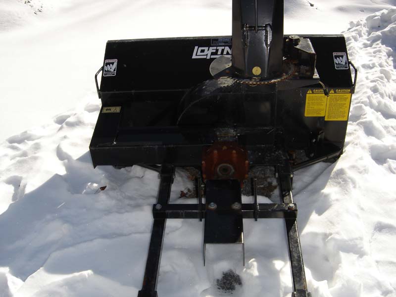

The blower that I got is a 54" Loftness that was originally made for use on either Jacobsen or Ransomes commercial mowers. It was this guy a few towns away from me who had bought it hoping to make a killing on it because the original price was something like $5000 and he figured he could make money on it selling it for half price. Turns out he couldn't sell it so he was willing to get rid of it for what he paid for it - $750.00.
I figured since a new rear blower is in the 1300 -$1500 range even if I have to do a little work to get this working on the BX it was worth the price. Plus it has electric chute rotation which would have cost me even more money if I bought new. I talked with Loftness and confirmed that the blower would adapt to work on the tractor like I hoped it would. Apparently all of the basic blower units are the same and they just get adapted for each particular application. This unit has a frame coming off the back that mounts to the mower - I already removed that and cut it up to make a 3pt mount for the tractor. There was also a gear reduction unit mounted on the gearbox - this adapts the 2000rpm PTO on the mower down to the 540 rpm that the blower is designed for. I just have to remove that and get the proper type of PTO shaft to install the blower on the BX. Once I get the thing working and on the tractor I will post some more pics but here are a couple showing the blower when I brought it home.
Hopefully I can get this working on the tractor before all the snow goes away /forums/images/graemlins/wink.gif

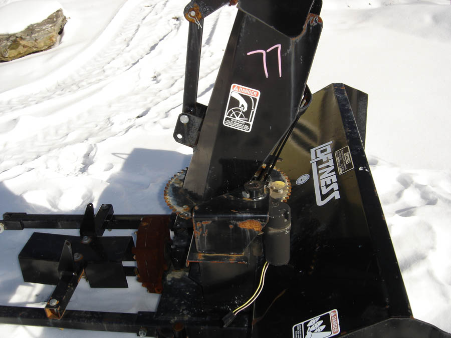

Here's another one..
