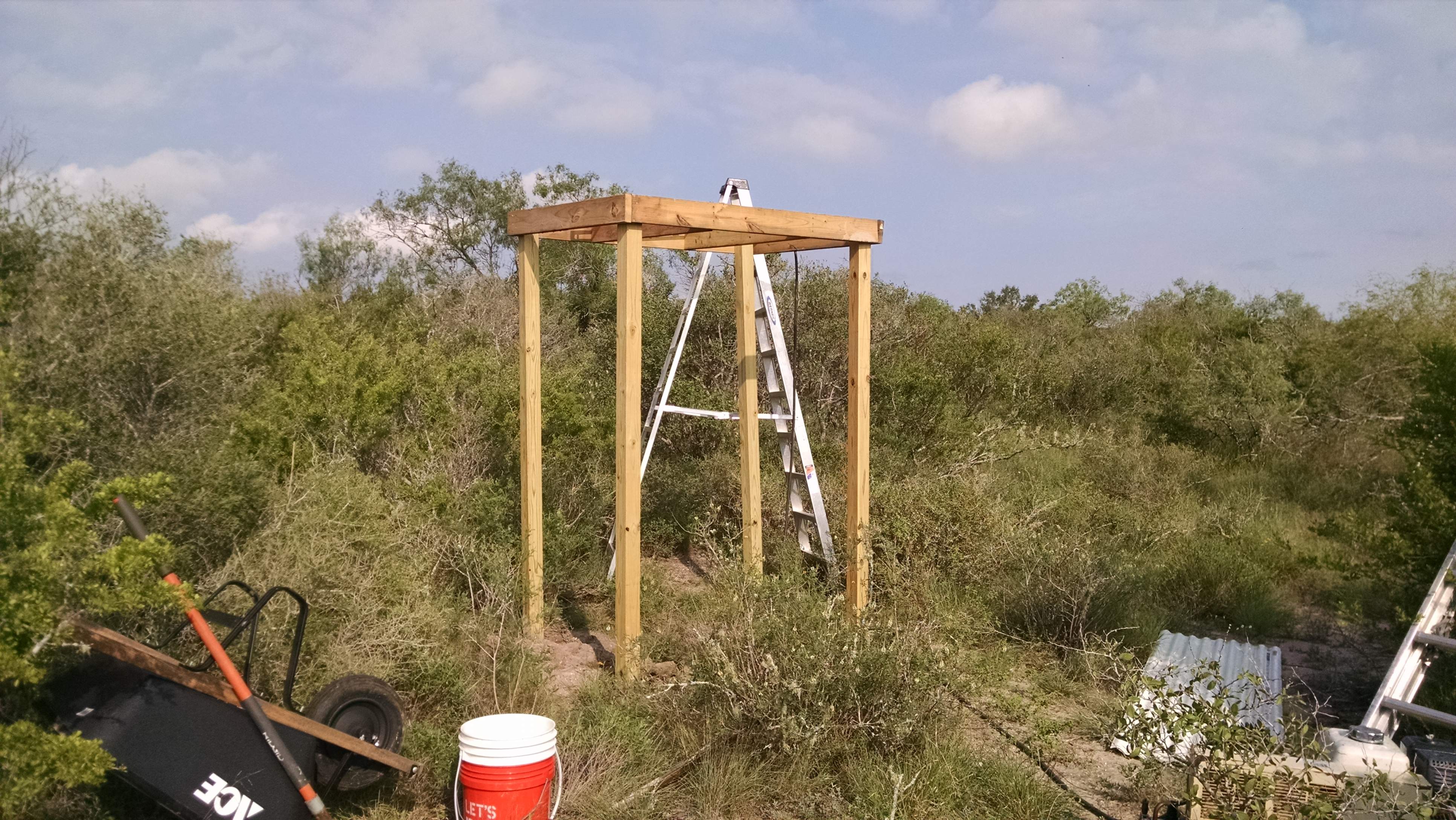

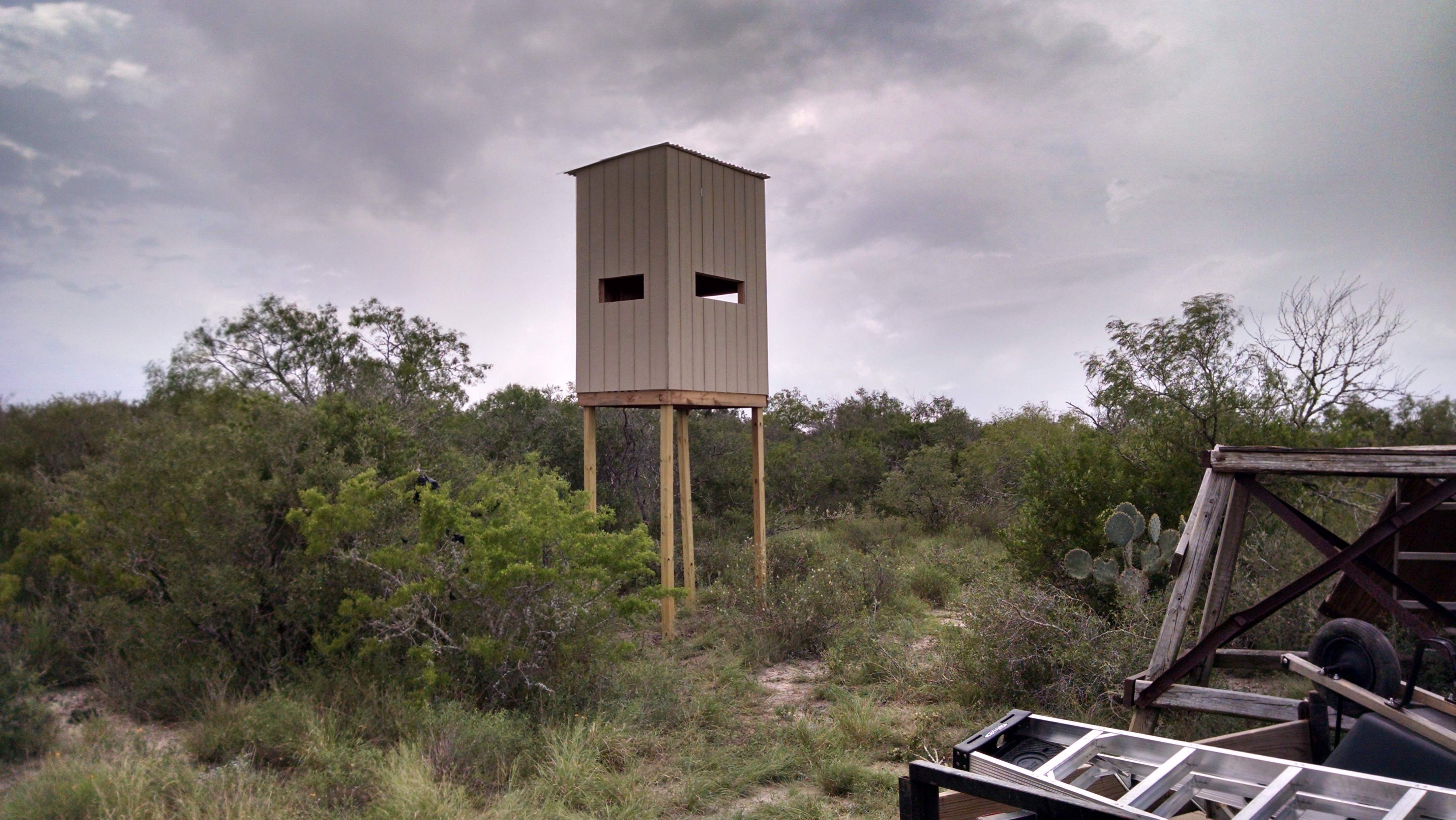

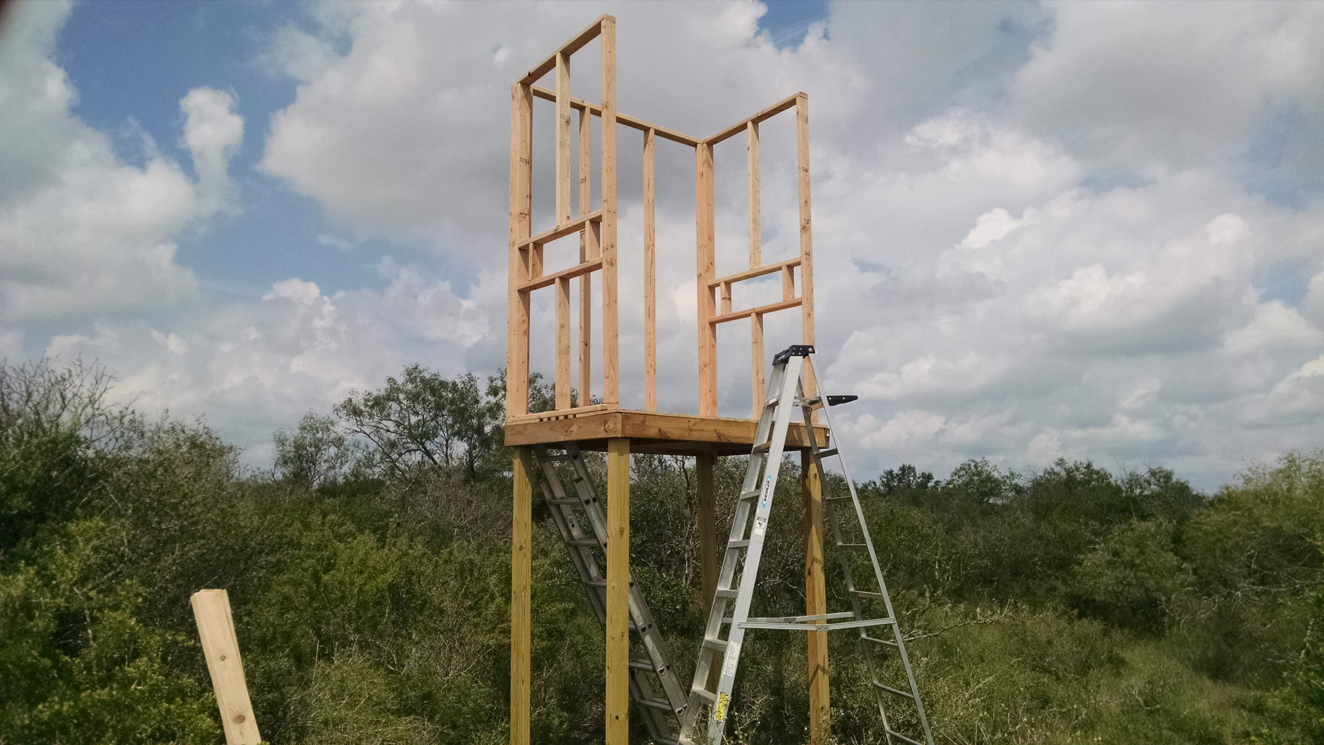

This is what we do in Texas. It's going to be insulated with paneling on the inside walls and high shelves. I've already installed the propane heater, the mornings can be kind of chilly. I would thing this would be bear proof and after 2 or 3 weeks, the deer won't even notice it anymore. It took my buddy and me about 3 hours to build this and only cost about $300 in materials. We did have a generator and a gas powered air compressor to run power tools and nail guns though, that probably cut our build time in half of using screws or a hammer.
The blind is 4' x 6' with the floor 8' off the ground. The 4x4 posts were set 3' deep in concrete and we ended up cross bracing them as well. It's rock solid and should last a LONG time.
The last photo is the view from the blind.

Nice raised blind! Been thinking of building something very similar!

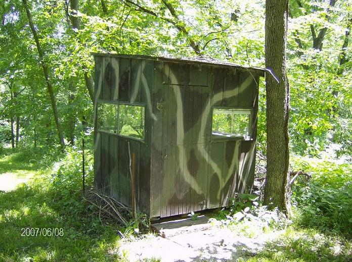

Mine is permanent, 6' x 6', made mostly of used lumber: FARM 2007 004.jpg

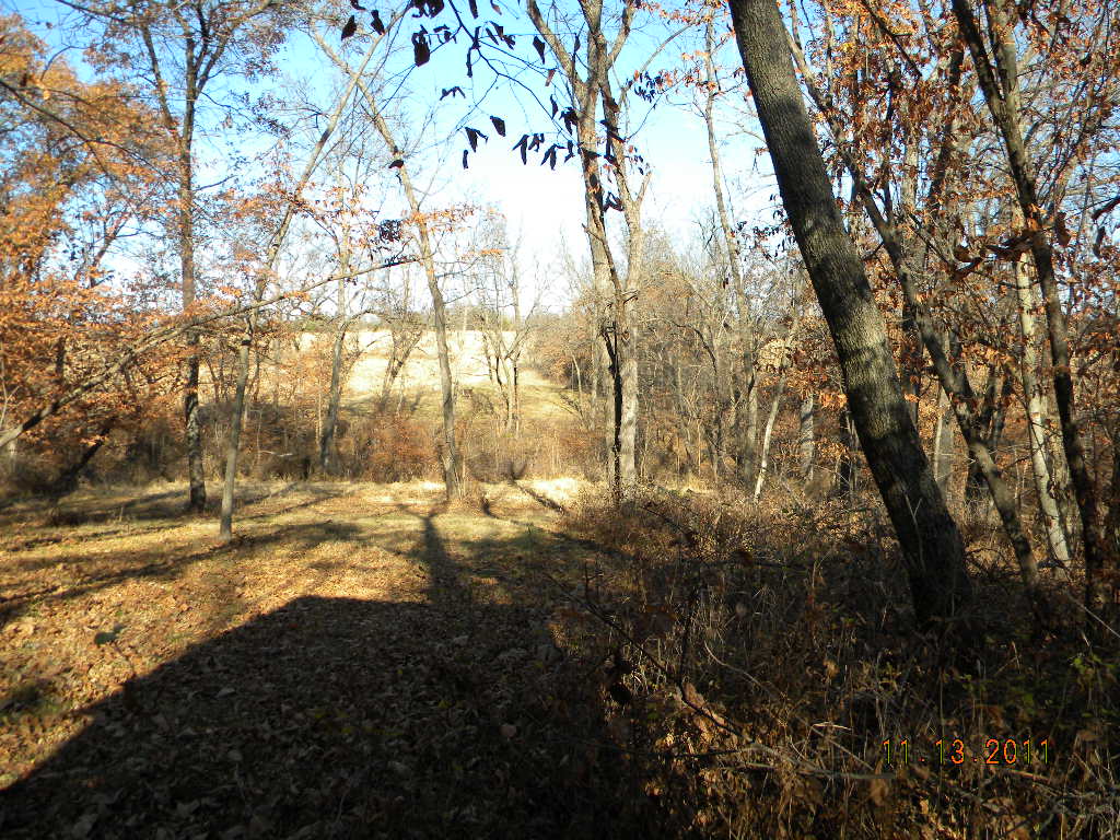

It sets on high ground, overlooking some open area & trails: Wildlife 003.JPG Wildlife 004.JPG HPIM0758-a.jpg

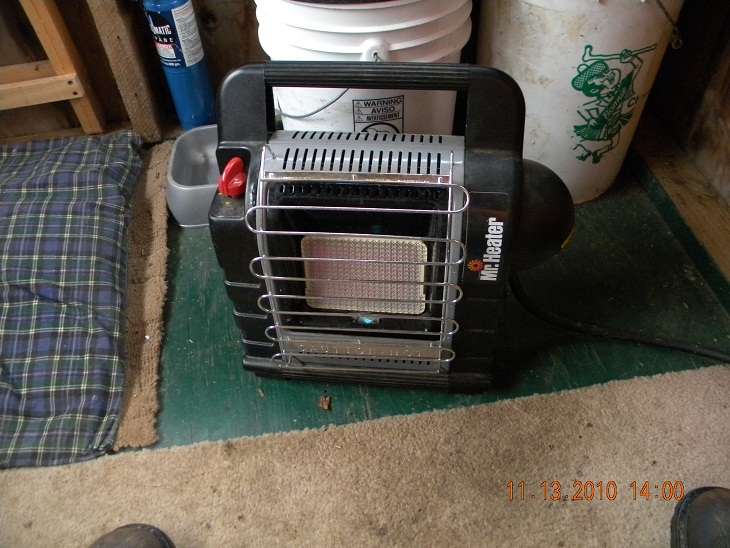

I use one of the "Buddy Heaters" DSCN0038 - Copy.JPG in in cold weather, makes a good place to get out of the weather when I'm working at the farm!

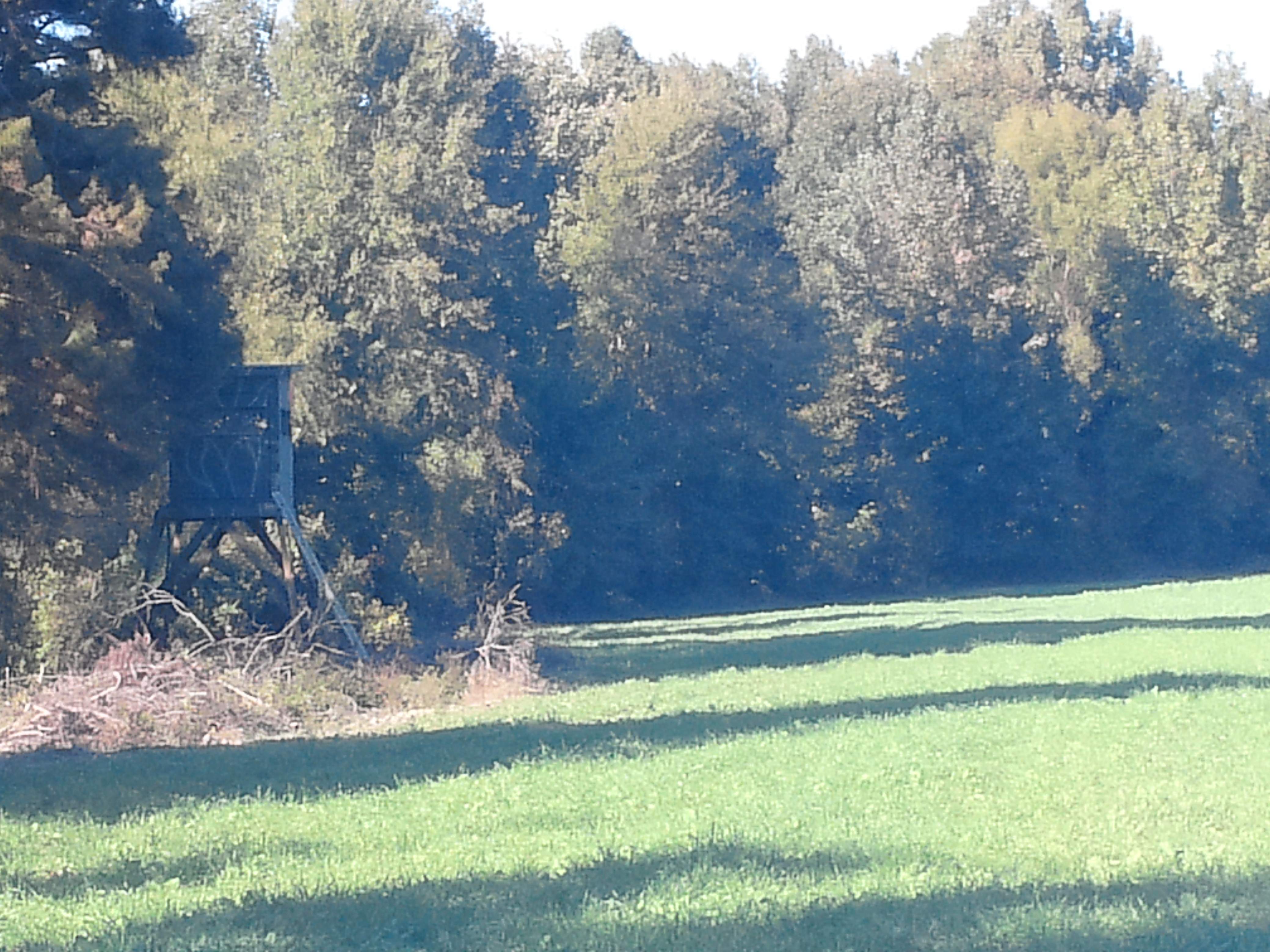

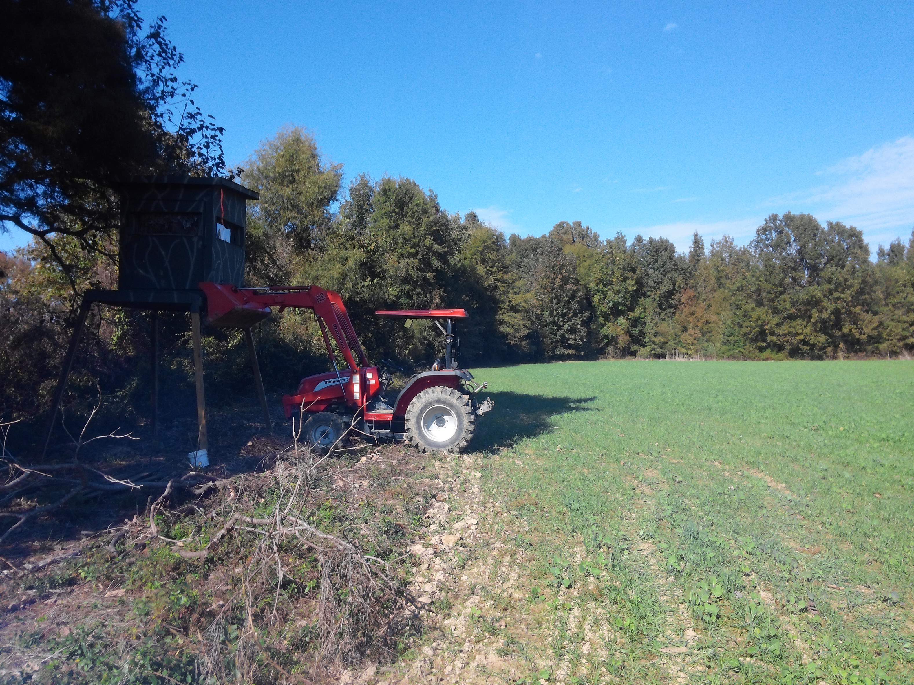

Have a 'temporary' (not attached to ground) blind 8' platform box on big greenfield overlooking 25 acre cut soybeans and woodline.
The 'Condo'(my son named it 10 years ago!:dance1:)

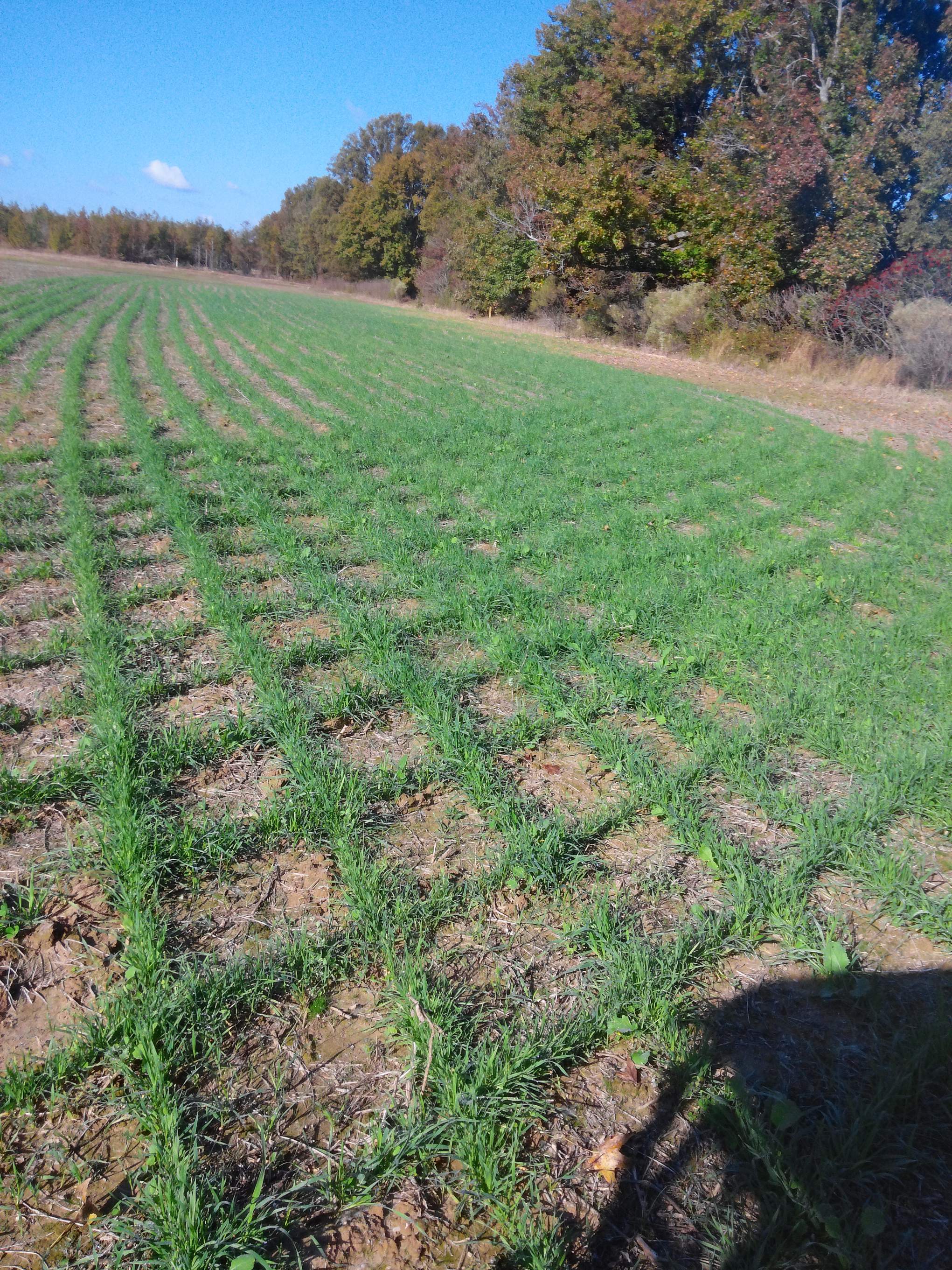

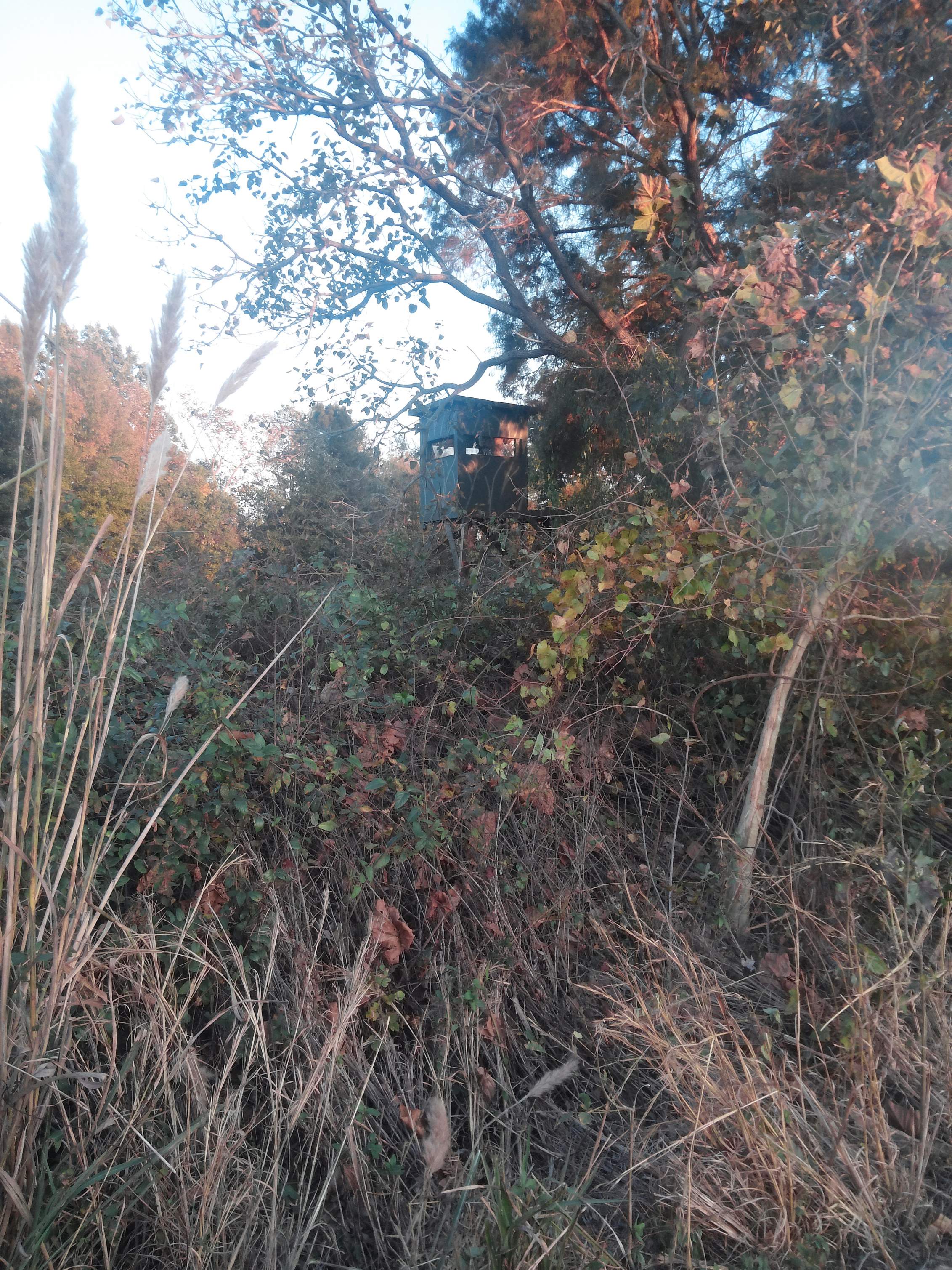

Drilled wheat in the beanfield and Condo across ditch from same spot- AMBUSH!!!!

Stx awesome stand, this summer when I build mine I may have a few questions for you. I have the spot, now I need to find out how far I can dig down, there may be bedrock and that may change the plan. thanks for the pics they are great!

Ask away, I'll be happy to help. If you can't dig down deep enough, you can always flare the legs for the base, like this -
They sell elevator brackets so you don't have to worry about getting the angle just right - 4x4 Elevators,® Set of 4 - 83819, Tree Stand Accessories at Sportsman's Guide
Then you can use guy lines and mobile home anchors to seady it in the wind. I have soil that's easy to dig in so it was easier/faster/cheaper for me to just set my posts in concrete.
