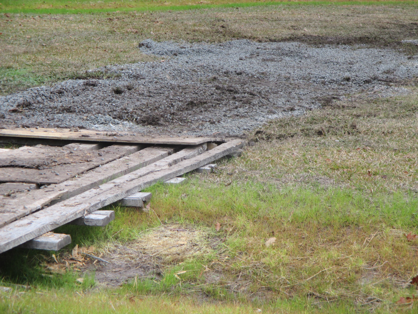

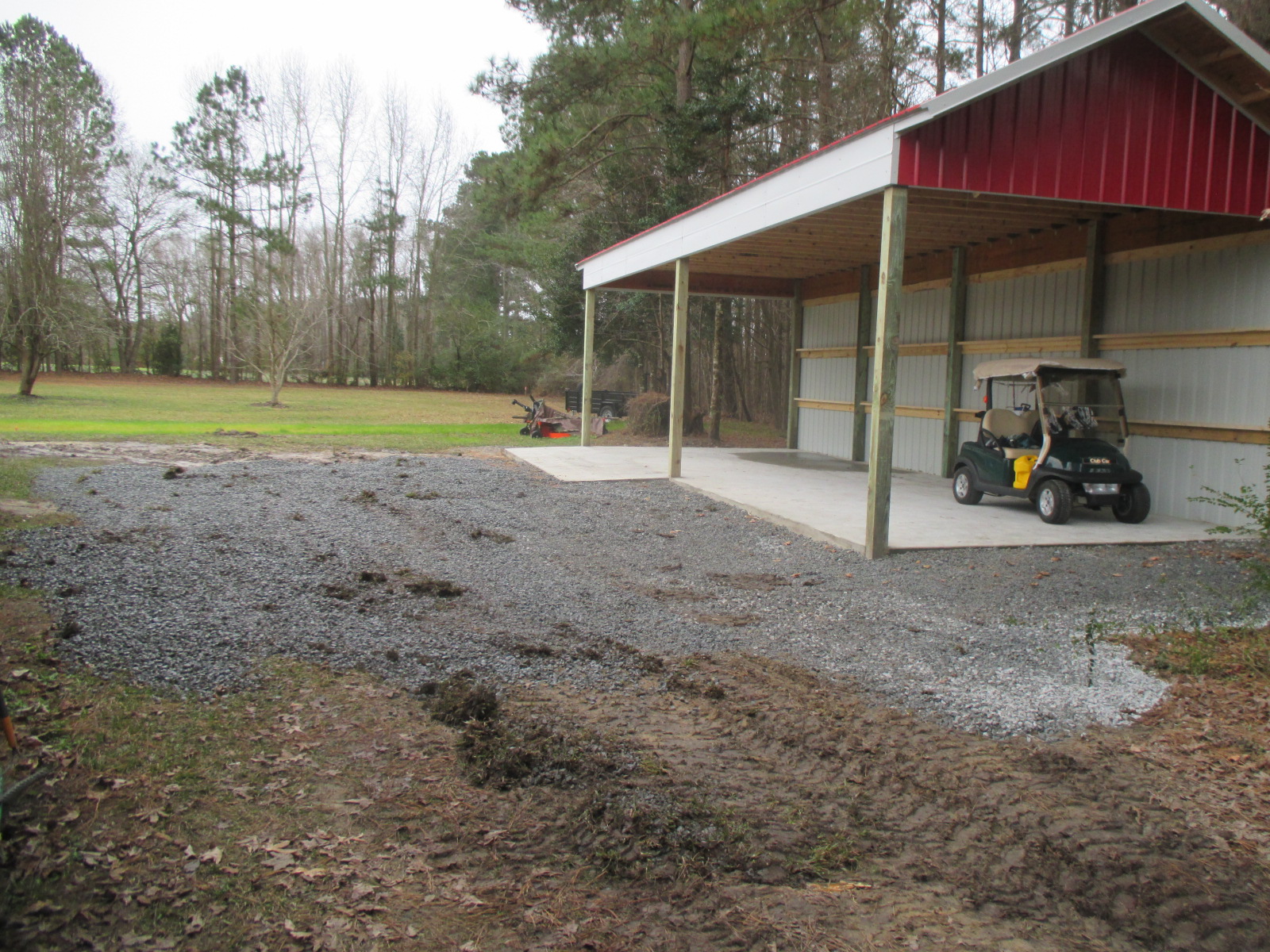

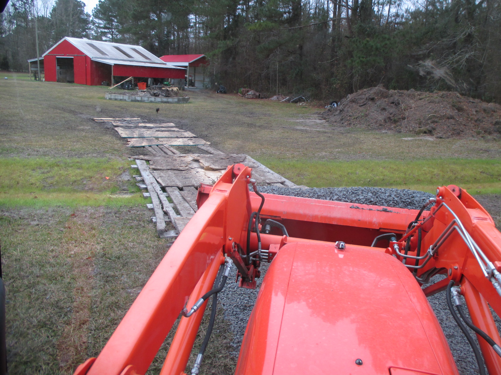

enjoyed two hours of tractor time before the rains came this morning. Moved the stone out of the field around the new building and leveled the gravel area before the temporary bridge. Thinking about it, guess I'd better build a real bridge there.
Got some stone down in the muddy area only temporary to push the precip about to come down over to the drainage ditch. If I drove a tractor on it I'd bury a tire.
But I could back the water roller over it. Not today for sure.

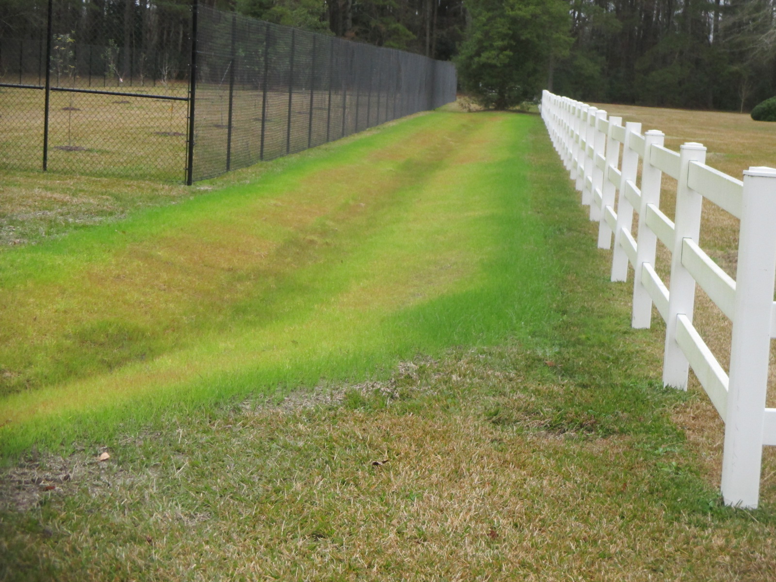

warm weather here is confusing the lawn; new grass planted to cover the water diversion ditches is bright green again. Nice change from dead brown.

Back when I worked a little bit in construction in CA, they always used sand under the slab. I was told it was required because of earthquakes, and that it was the only material that they didn't have to compact before using. When I moved to TX, I was surprised that nobody used it here for anything.
As for putting rock on mud, I wouldn't do it. Iv'e found that it's a wast of time and material. If I have to deal with mud, I either wait for it to dry out, or dig it out until I get to firm soil, then fill and compact the hole up to grade or a little above grade. Dirt is cheap and very effective for a base. Leaving a wet low spot just means you will always have a wet low spot after filling it with rock. On big construction jobs they will use bigger rock because of time and having more money to spend. Ideally, you want to use clean fill dirt to build up your base before adding expensive rock to cover it.

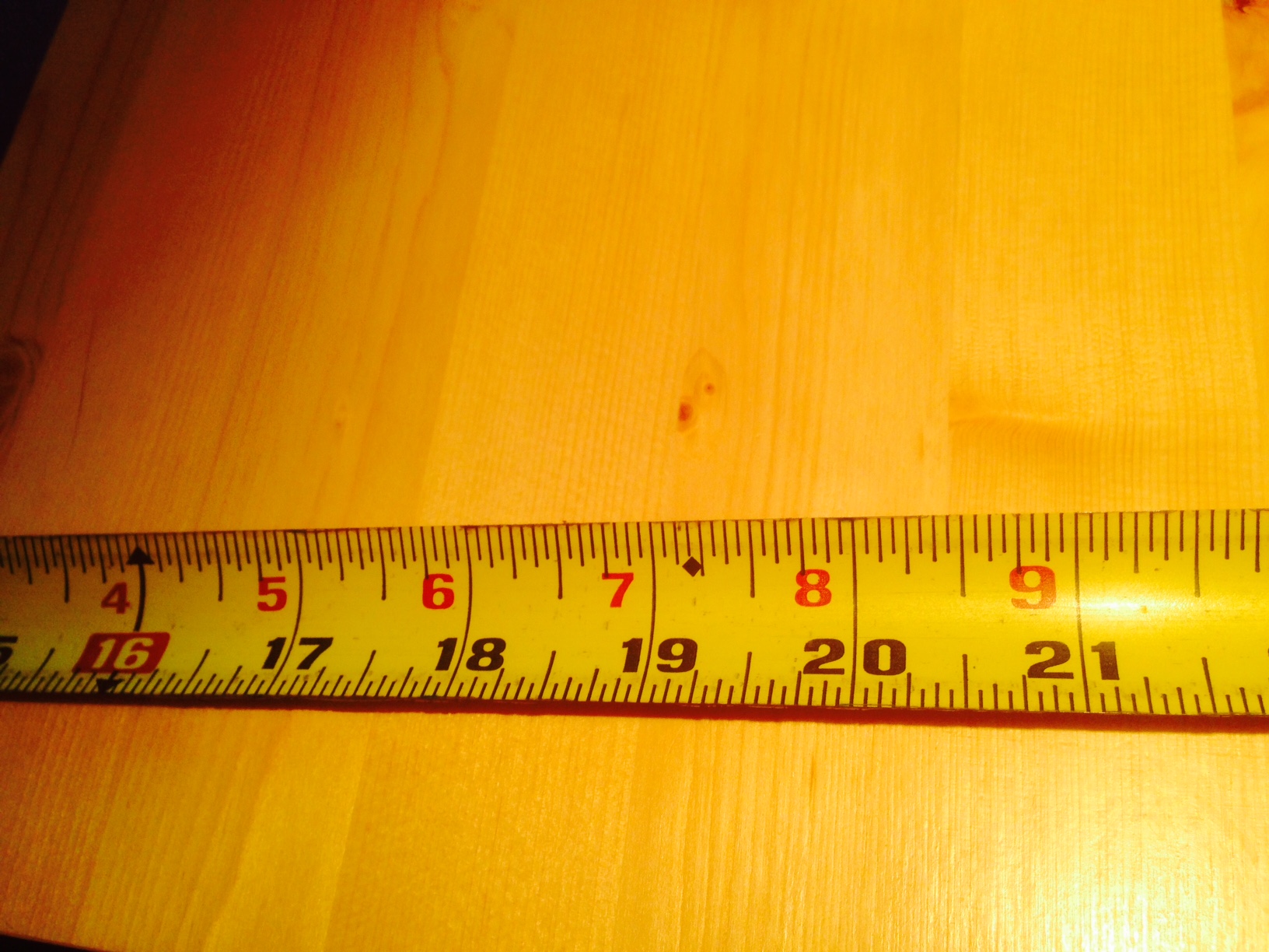

Technically it's 19.2 inches for spacing if you want to be somewhere between 16 inches and 24 inches. I tend to call it 18 inches, but that's just a bad habit of mine. If you look at a decent steel tape you will see that they are marked at 19.2 inches, 38.4 inches, 57.6 inches, 76.8 inches and 96 inches. Most people don't even realize that when looking at a tape!!! :)
Learn something every day. I've used these Stanley tapes pretty much every day for decades, and never noticed those marks.
