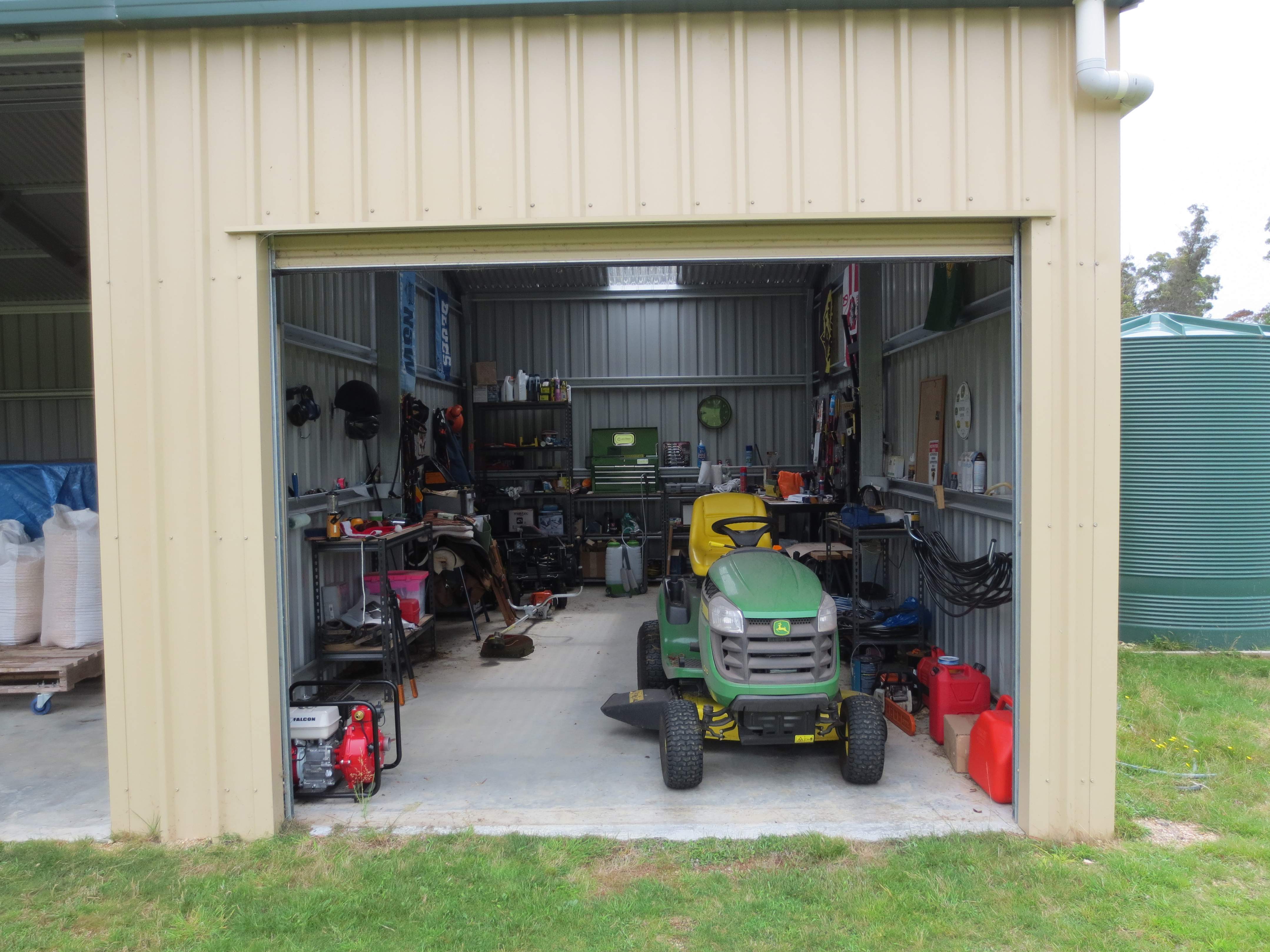

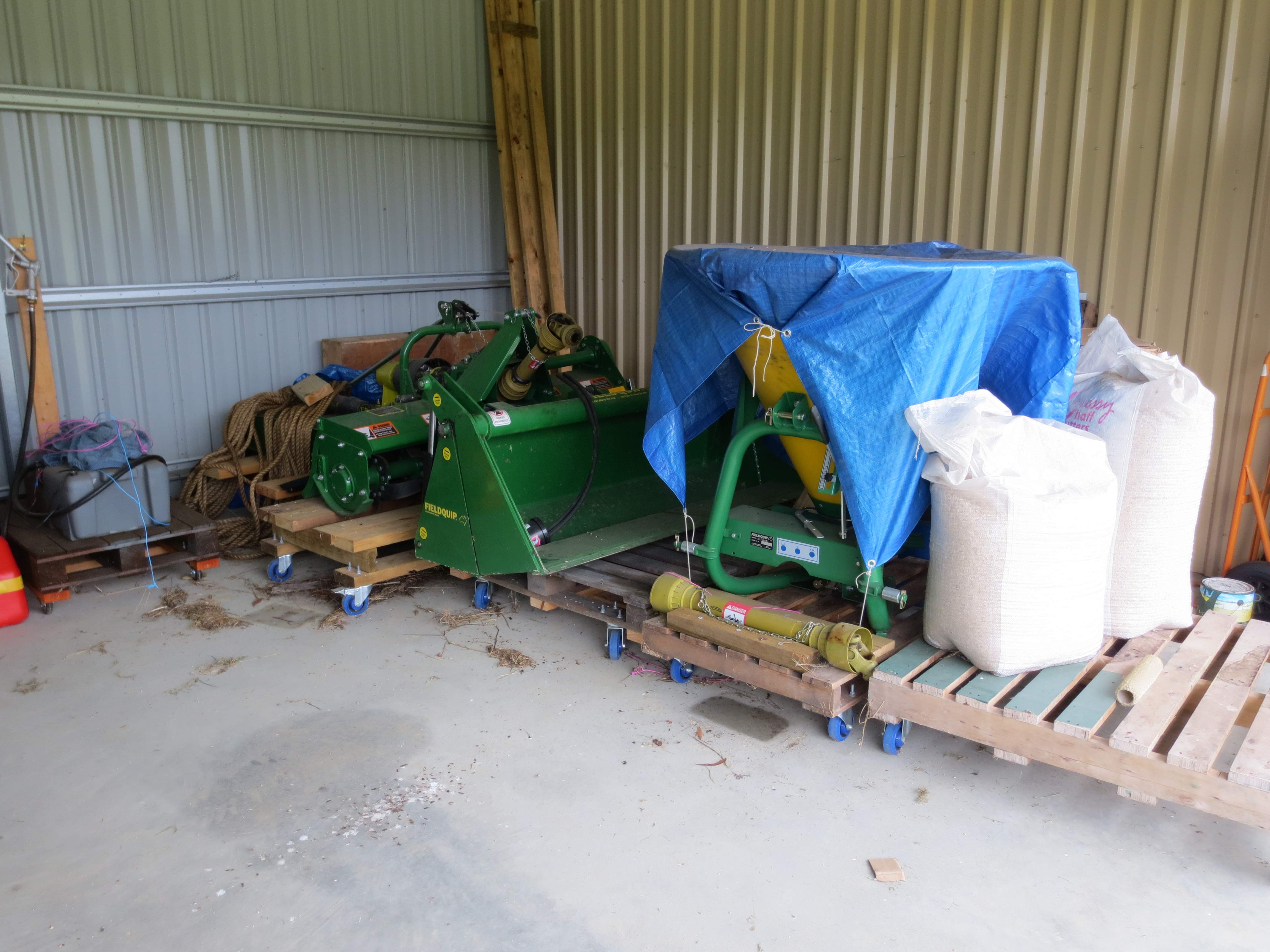

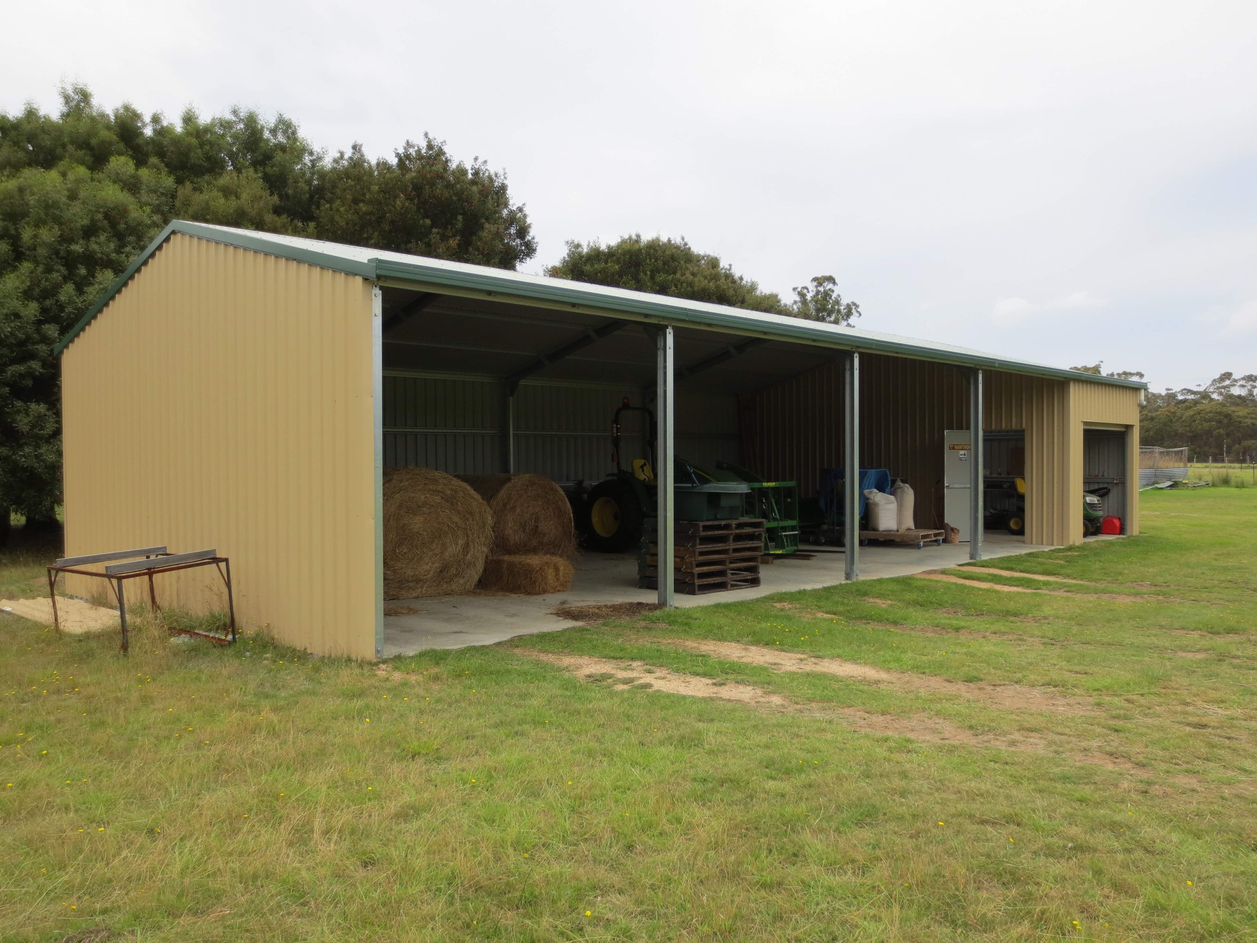

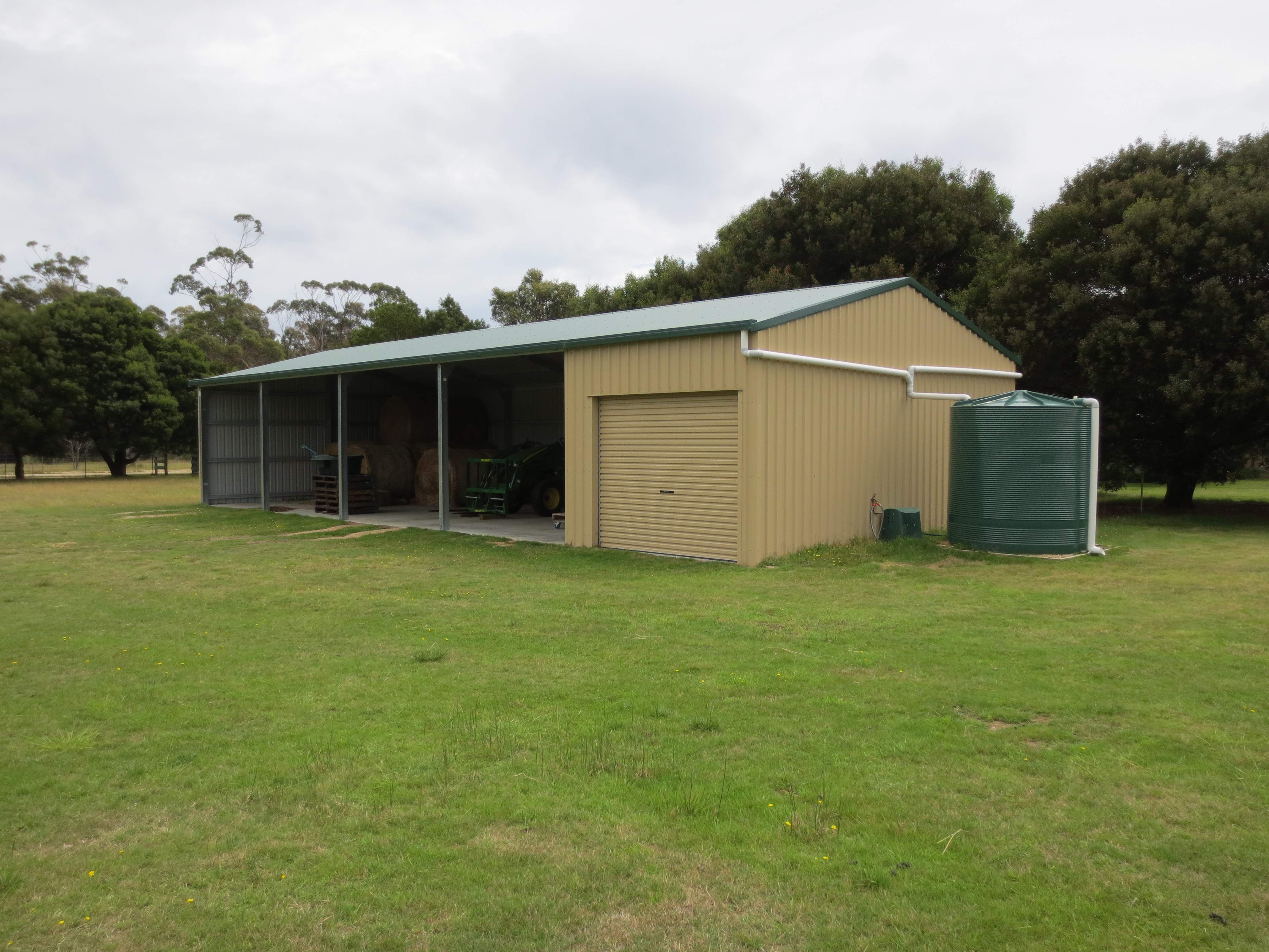

US$50k for a 30x60 metal, single story 'barn'? I'd shop around a lot more, Mate. Even taking into consideration that the poured cement floor/pad is approximately half the cost, that is an exorbitant price.
Two years ago, my 5-bay shed (one bay, roller doored workshop) with pad and assembled was A$32k. Mind you, I didn't have power run out to it as I just ran a heavy duty extension cord from the house. And I don't have to worry about insulation, heating or snow. But still... that's a lot of money.
