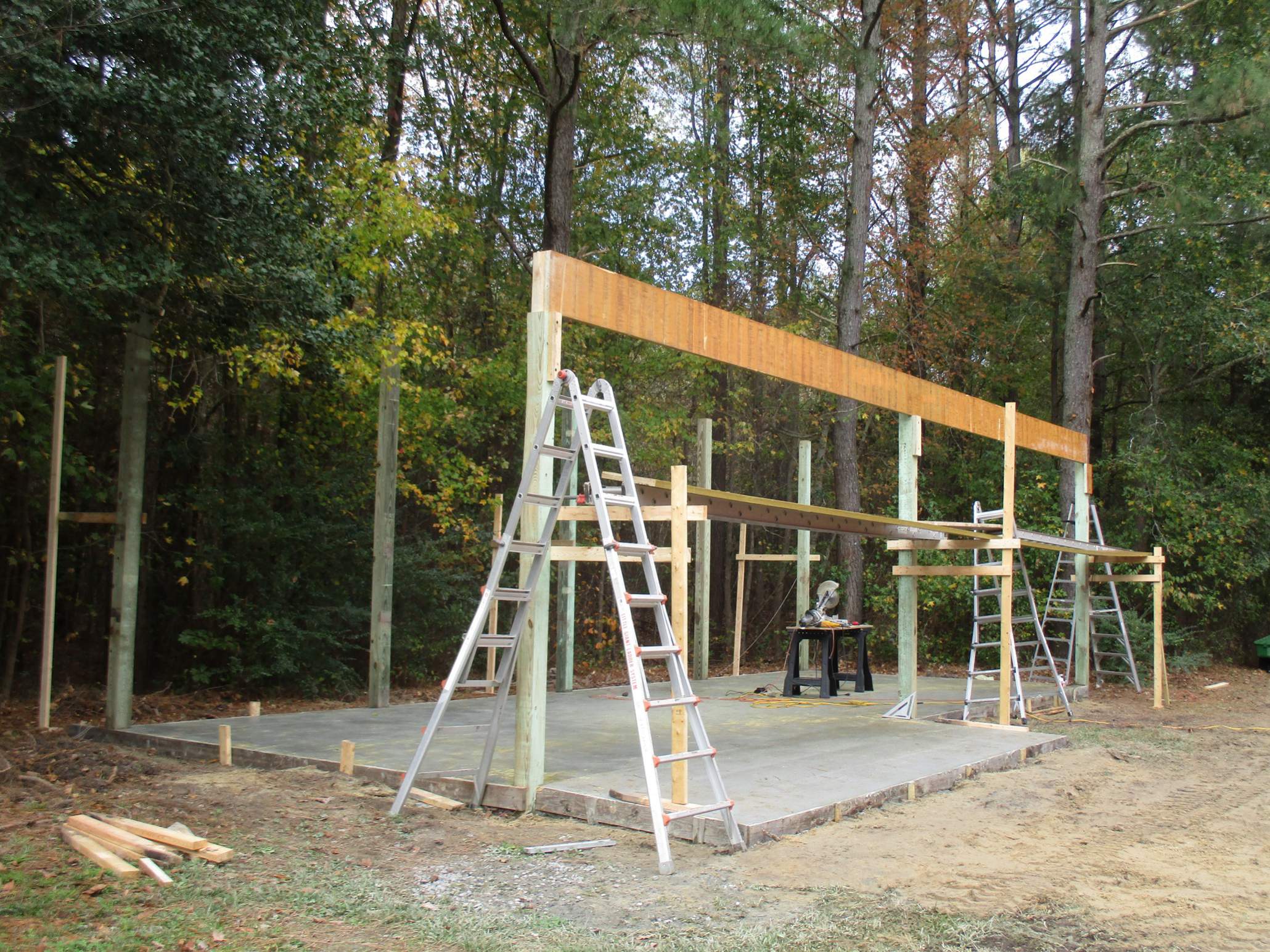

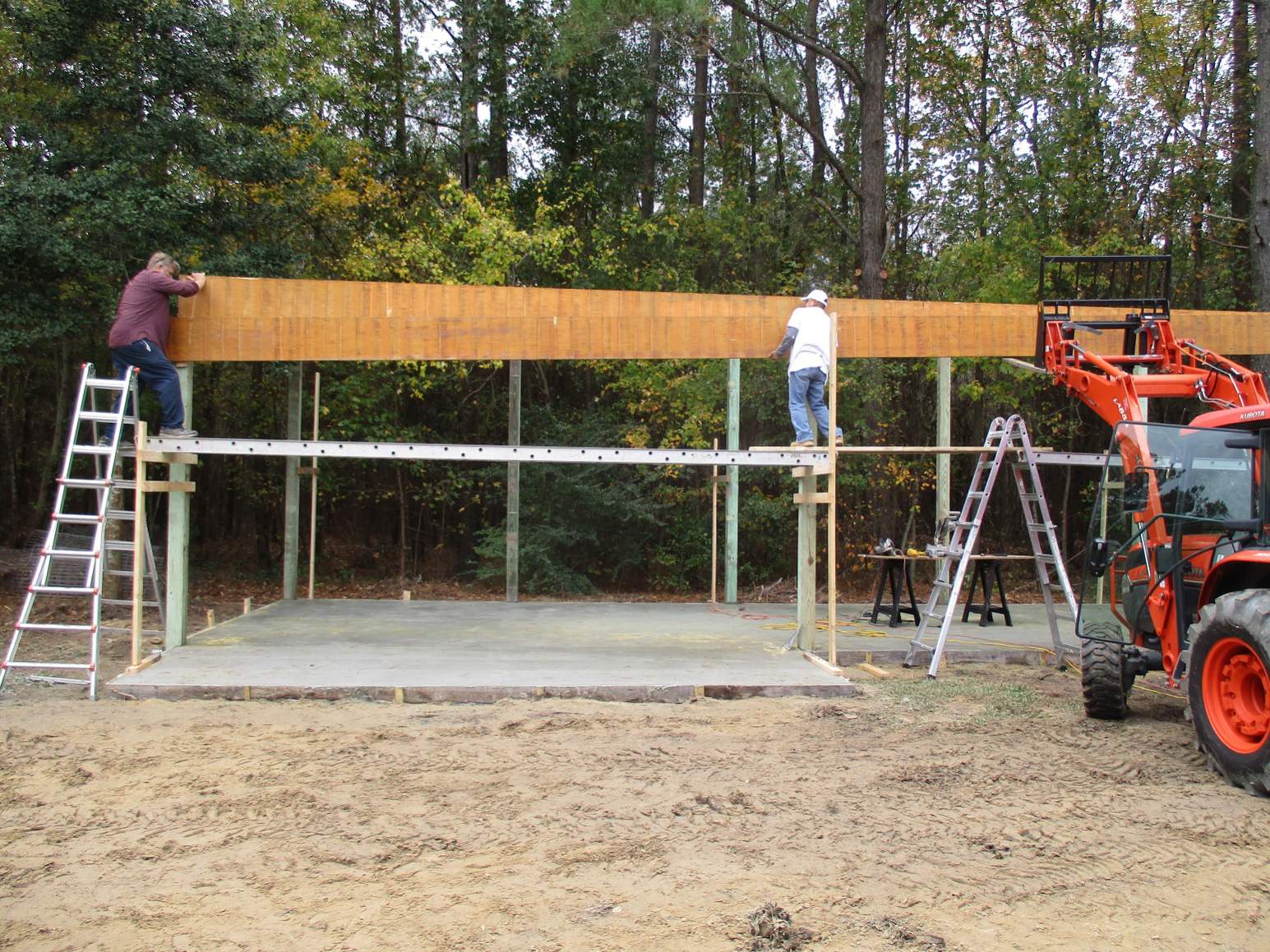

I didn't get a chance to see what they got accomplished this afternoon but this morning I saw them lifting those very heavy laminated beams. I thought one would be plenty strong, but they were doubling them up, two on each side. In my opinion, totally overbuilt for what I was intending. I did question the use of that short piece holding up the outside beam; told it was temporary, guess I'll just wait and see. Said they were throughbolting the beams and I suppose into the posts.
this was an OSHA nightmare at times, these guys have little respect for safe material handling. No backup lines, one slip and the whole thing would come down on them.
This is the carpentry sub working for the GC, 40 years doing this so I assume he's made it this far...

I think I'd be more concerned about them walking on the uncured concrete. And if one of those glue lams gets loose and falls, there will be cracks for sure.

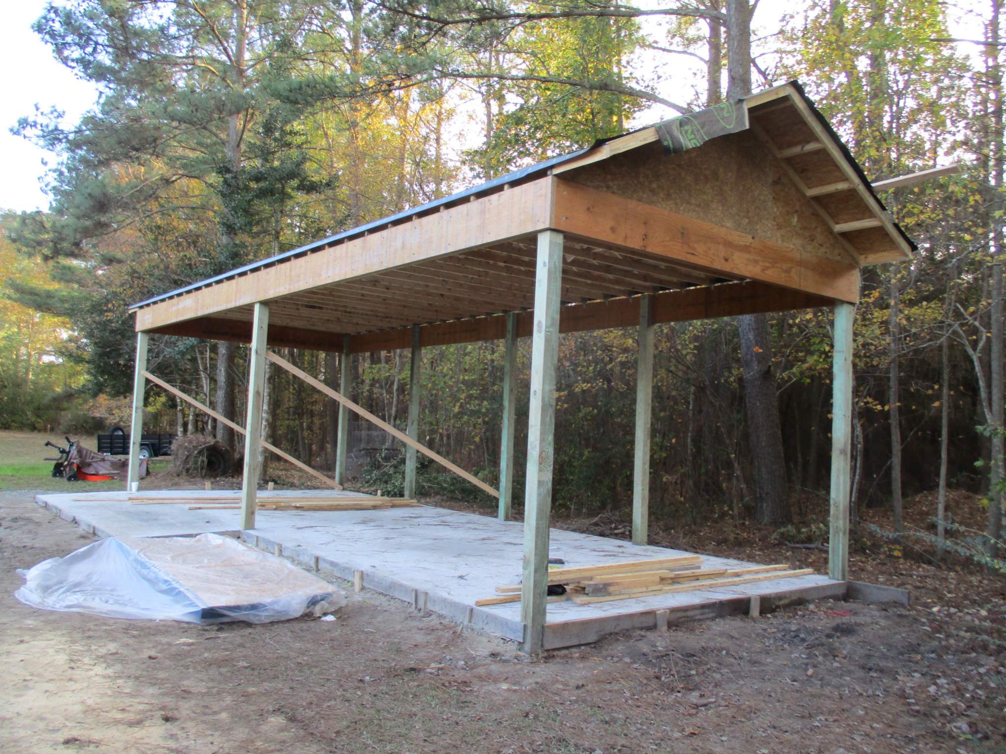

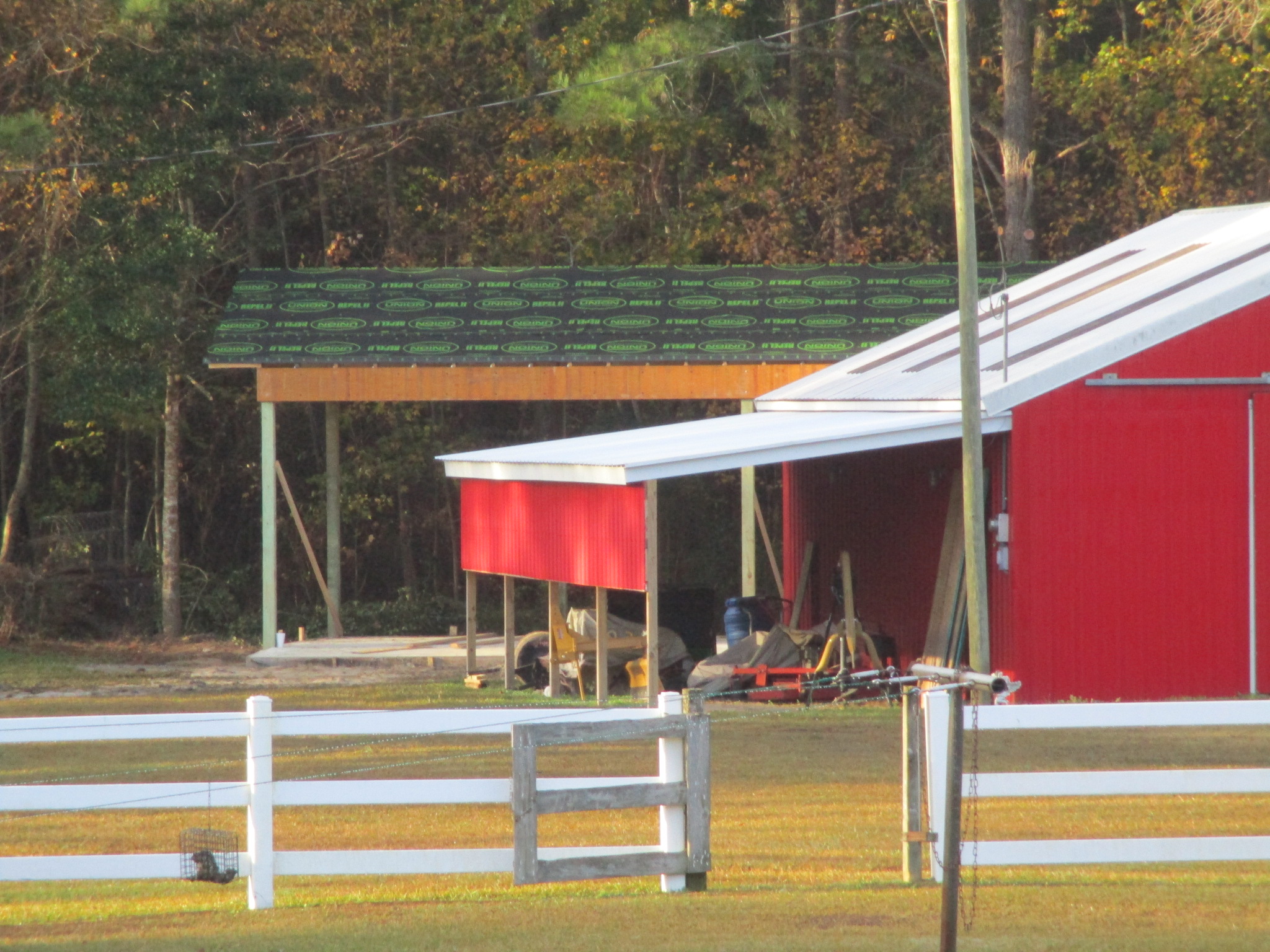

making progress, getting roofing underlayment on, I did ask they extend the roof out two feet on each end to help with keeping stuff blowing in the sides. Rear is likely to be closed in but sides and front left open. They will reinforce the part sticking out past the building, and gutters are going on front and rear.

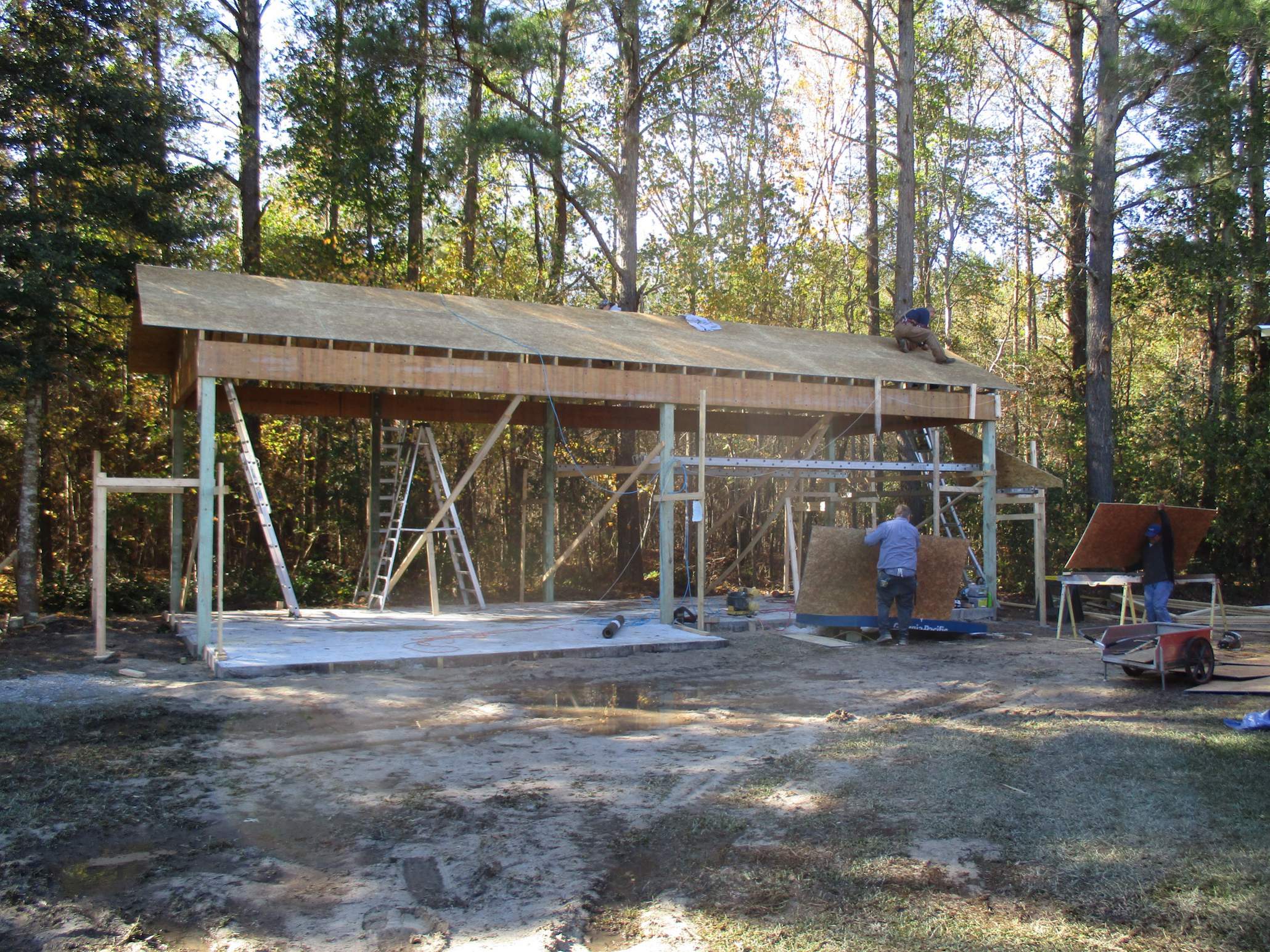

progress

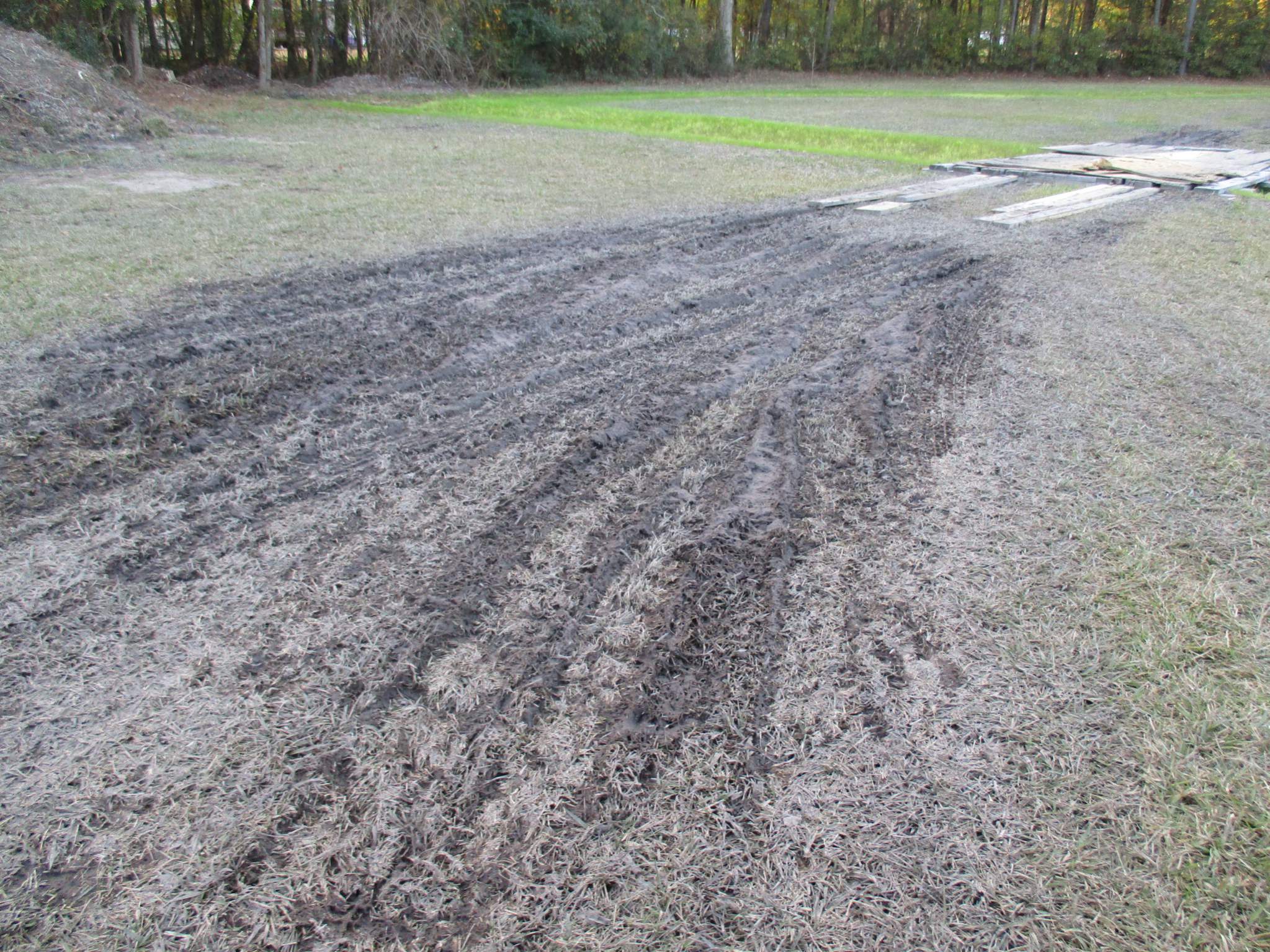

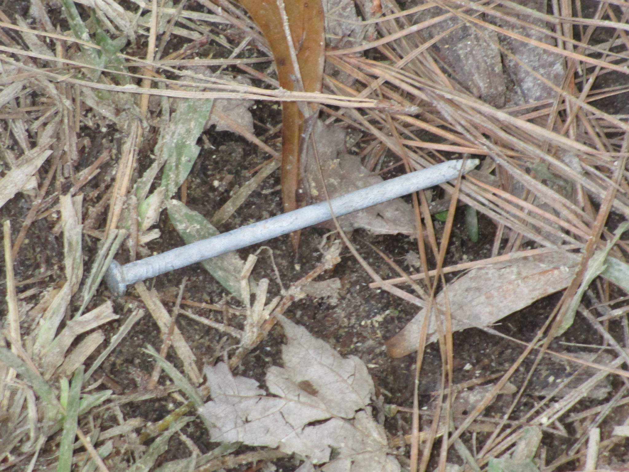

more ruts to fix and a reminder to the GC that he has to pick up nails at the end of the day...
Good luck with that, Drew. The concrete contractor that poured the driveway here got several reminders, all of which were ignored. I ended up dragging a magnet through the dirt over the course of several days, recovering over a gallon of screws and nails that I'm still waiting to recycle.
