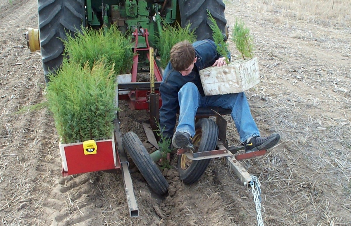

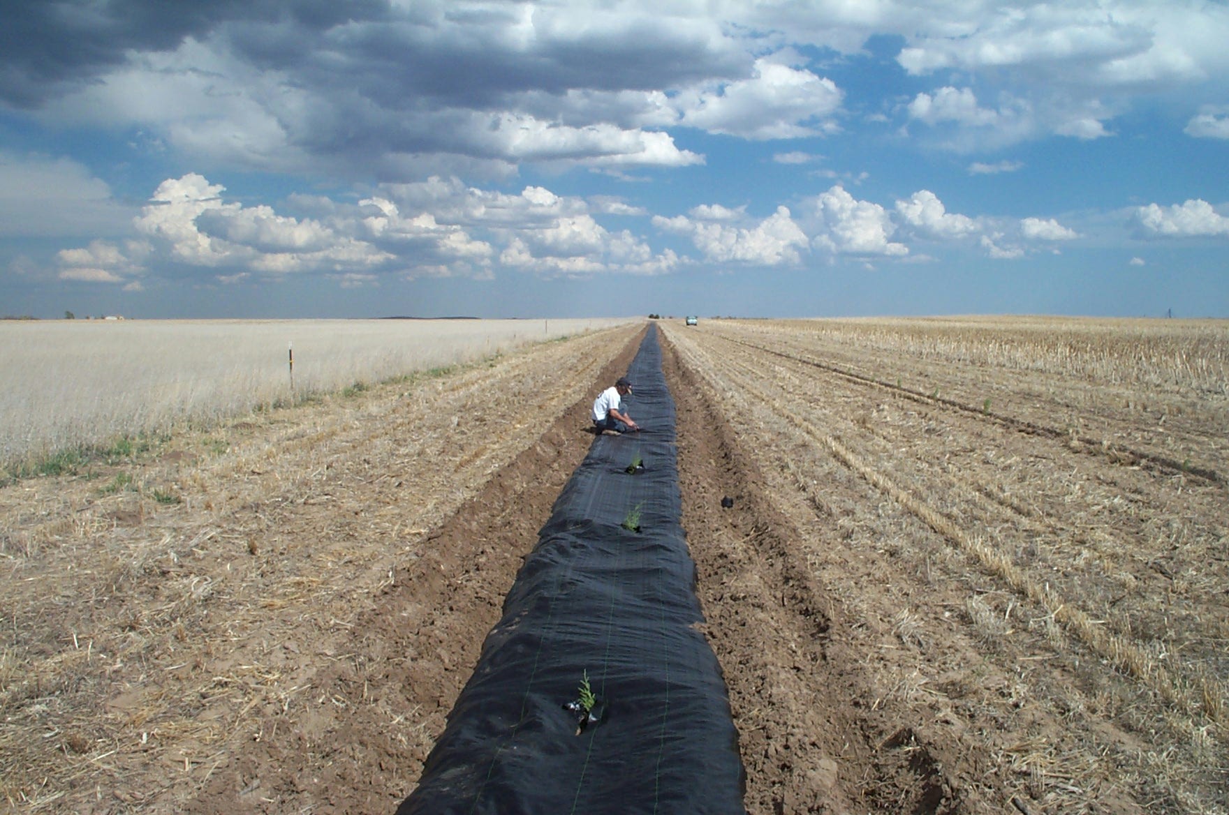

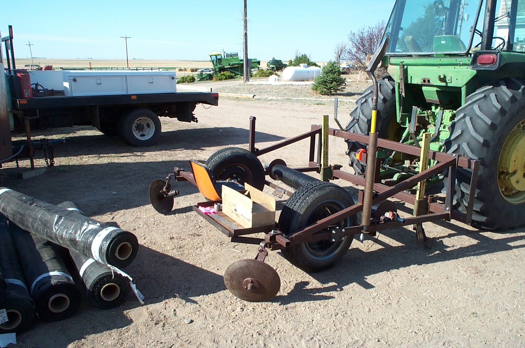

IF the ground is not froze, I would scrape the snow off or if it is not so deep it is a problem, go plant them
here is a picture of when I planted about 3000 trees, we put the weed barrior cloth on later,

That's great! I can see how that is a fast way to plant a lot of trees.

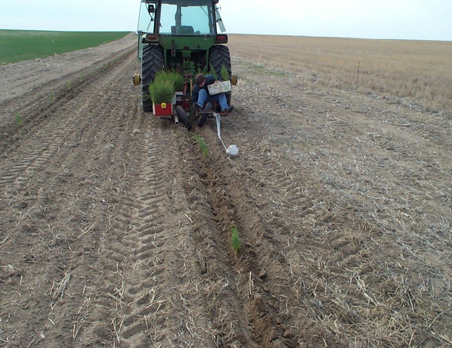

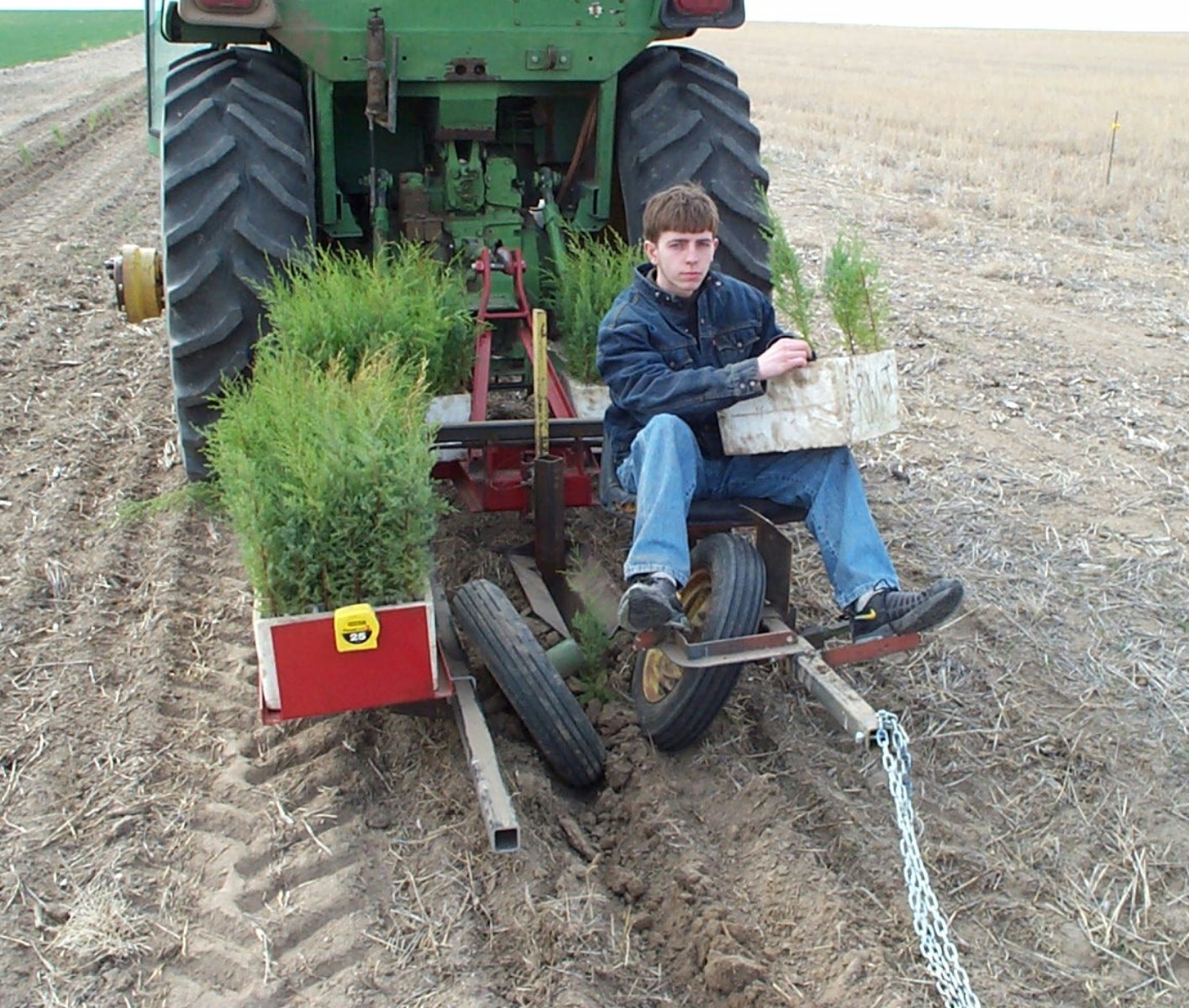

also when planting them (bare rooted) can be easy to J root, and they normally will die in a few years, or that was my experience, I planted some hard wood trees and they grew for about 5 years and were looking great and killed over, no apparent other problems,
these were planted before I built the tree planter, a few years, in the yard,
the rows I use the tree planter, I had close to 98% survival rate with the weed cloth on, we went through one of the worst drouths that summer, only 2" of water during the spring, summer, and fall total that year was about 5 inches, watered them once, the trees with out the weed cloth was about 4% survival, (I had a small area where I ran out) so the next year I had to replant and put down the cloth.in that area. that was on my own extra area,
J rooting is when the roots of the tree are bent over or even bent 180 degrees on the bottom of the hole,
http://classes.forestry.oregonstate.../1993 Haase et al TPL Effect of root form.pdf
https://nurserycoop.auburn.edu/PDF files/BSSRC10.pdf
one of the problems I have heard about with using a post hole digger auger is that the auger can compact the sides of the hole in some soils that the roots have difficulty to grow past that hole, kind of of like a root bound container plant, (in my sand it is not a problem but I hear it can be in some harder soils),
on storing your trees, they will stay dormant if keep in a walk in cooler for a good wile but still best to plant as soon as possible, one year I had some time problems and I put them in a cooler for a few weeks and no problems,
