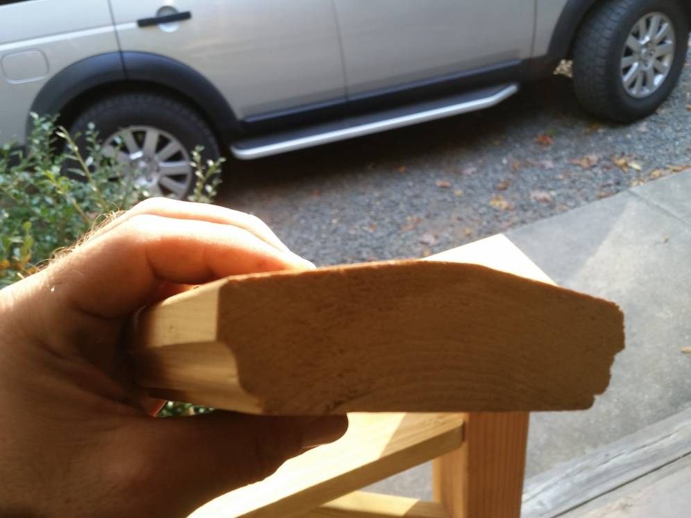

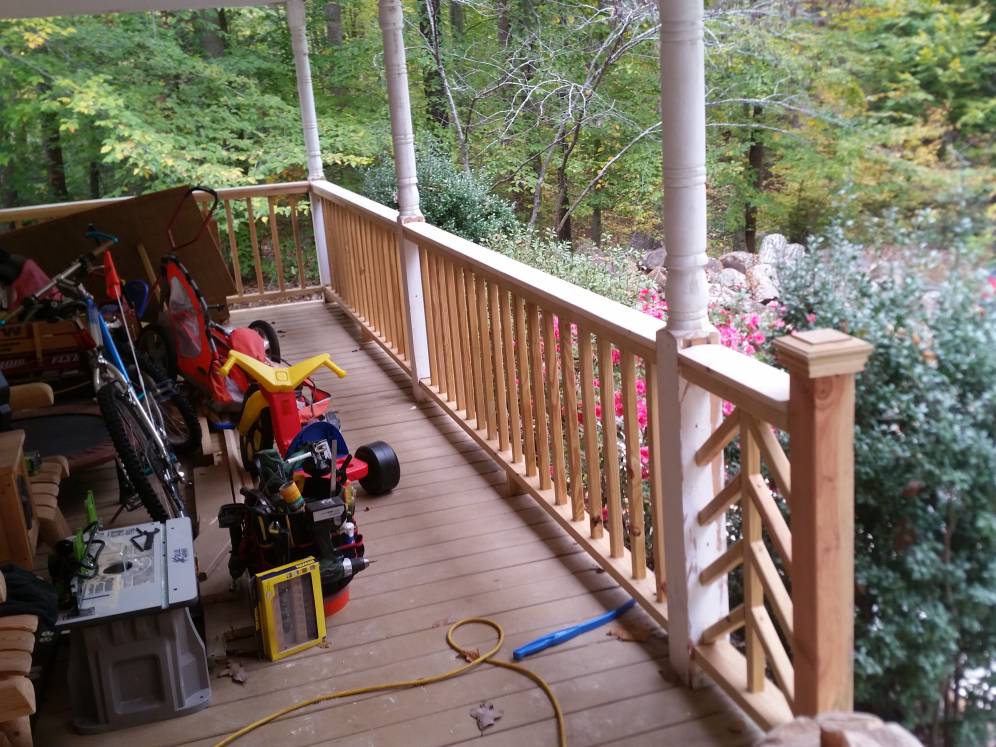

An old pic of mine.
   / Advice on porch rails
You guys think with a support block I want need any metal?
   / Advice on porch rails #7
The picture in post #5 shows a railing like you are describing, except it has a 2x6 for a top rail. You won't need any metal with that.
