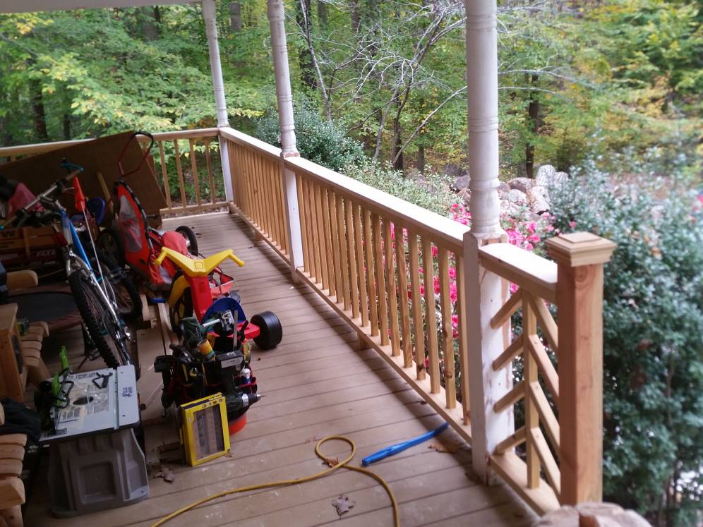

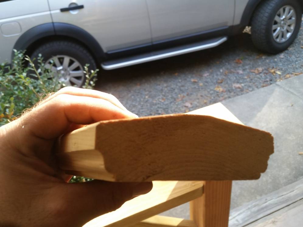

This is how I did my top rail, used a 2x6 and beveled the top on the table saw, then routed a Roman pattern in the bottom.
Really like the look and how it feels. I used a block in the middle with 2x4 bottom and top. Very stable.View attachment 624156View attachment 624157
Now, THAT'S a nice handrail! I hope you don't mind me copying your idea. ...simply perfect!
