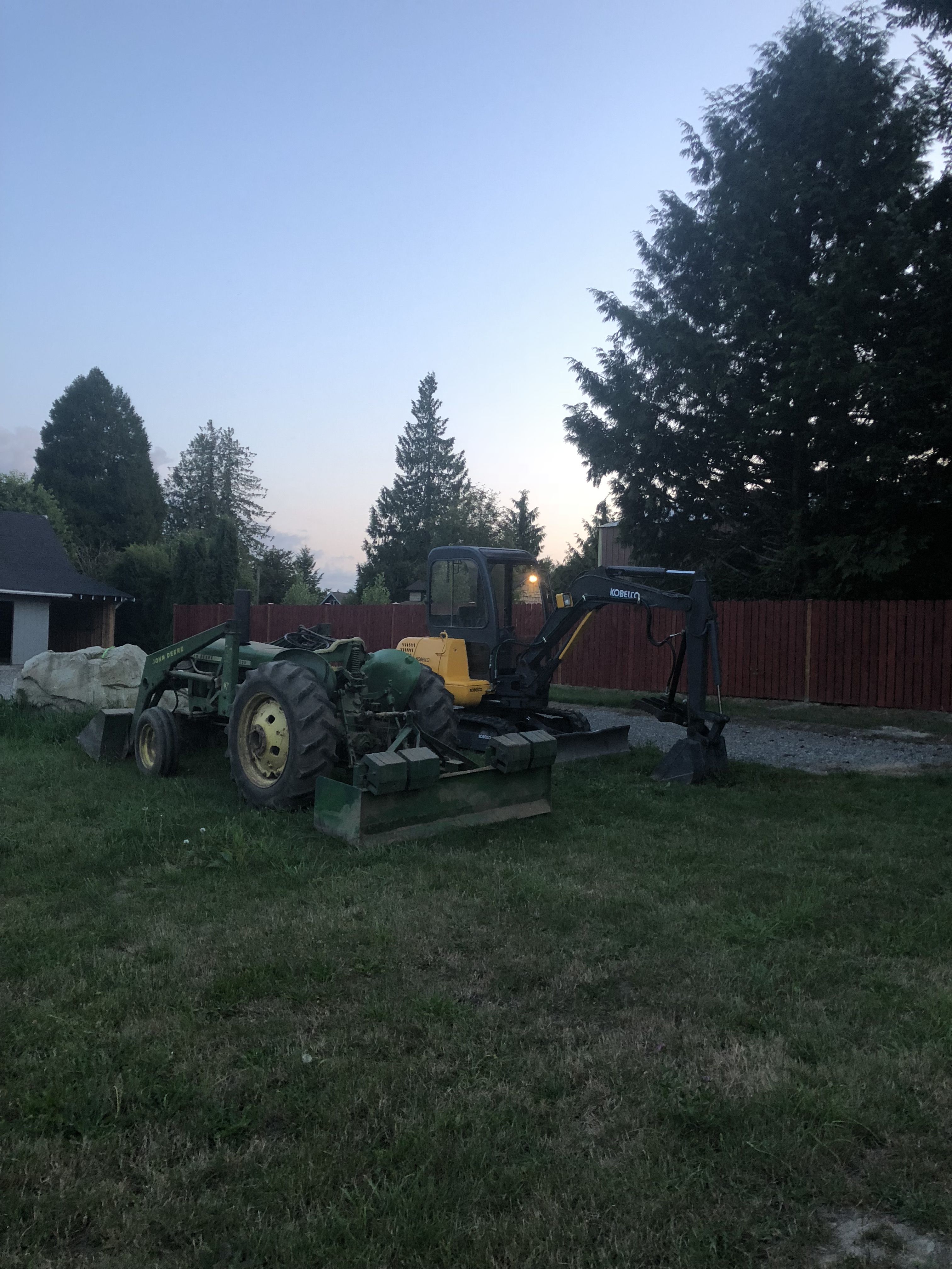

I just wanted to thank you for all your help with the Nortrack that I had. I did end up getting a roll back truck, and yanked it out of the pasture. Sold it to another fellow for 5k. Last I heard he was able to repair it, and uses it today.
I went another route, Kobelco mini.
