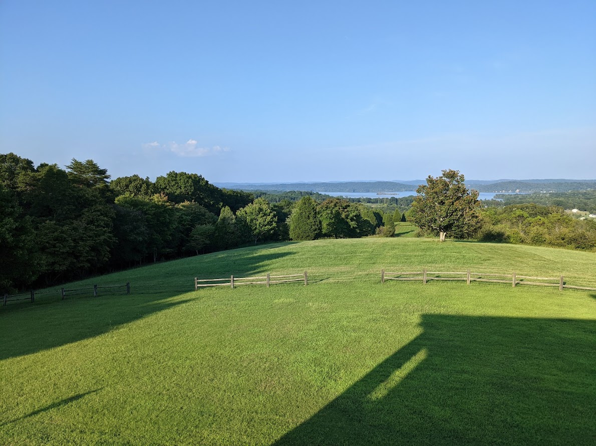

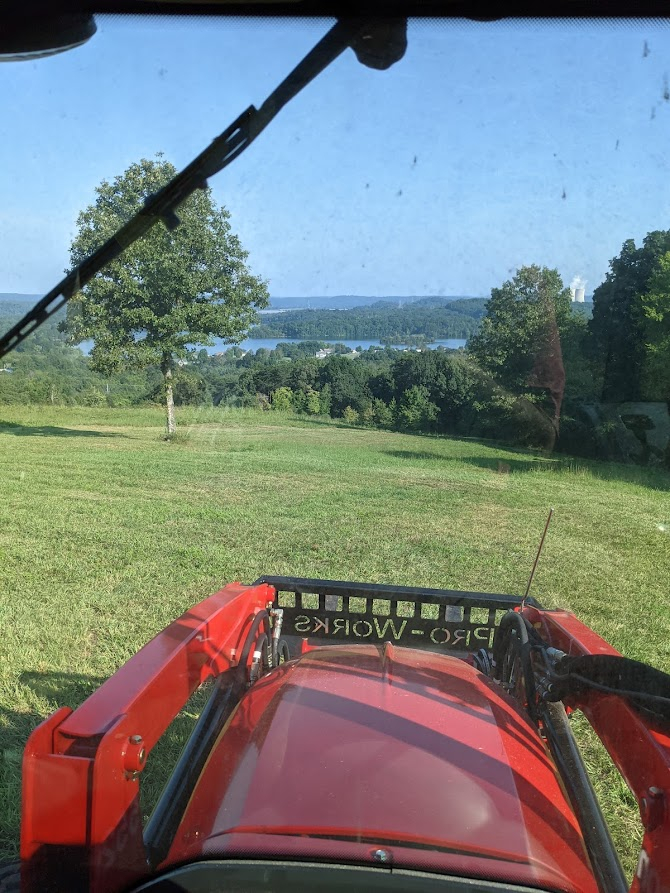

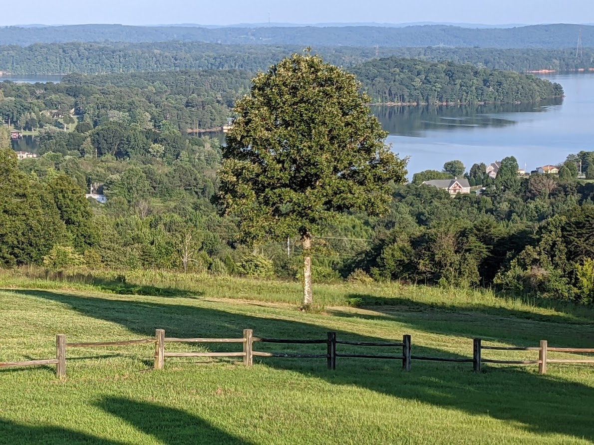

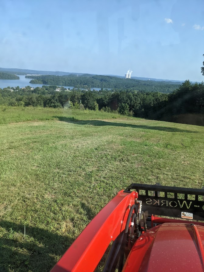

I have a big field I want to keep mowed. Not feeling super good on the tractor doing it. It is rutted and wavy and has some pretty severe slopes. I feel nervous on the tractor at times as I go 20 degrees sometimes more. A good bit of it is at 15 degrees. But it is the ruts and wavyness that makes it scary.
I would like to smooth it out. I know getting it level is a dream that won't be realized, but if I can get it less bumpy I think I can handle it. Sometimes I feel like the tractor is the wrong tool for the job, but it's what I have.
I am willing to spend money to get it done. I am willing to truck in dirt if I have to. I might even get a professional, but I prefer to do it myself.
Pictures are hard to see the issues but here are some, it's the area past the fence

That is a large area. Trucking in dirt to fill ruts not practical Need a large drag / disc box blade etc to scrape and fill

It is easy to create erosion with that much slope. I get the the feeling you should hire a pro to smooth and terrace the field.

I’d start out spending the money for a six foot box blade then try doing one acre at a time. The technique is to drive figure-eights within the chosen acre, pivoting the figure-eight about the center of acre. If u feel you’re making progress and get the hang of it; continue on to the next acre. If u can’t quite grasp the skills, sell the box blade and call in a professional.

1. Mow field as short as possible. Scalp.
2. When soil is moist, use a Tandem Disc Harrow with 22" diameter pans, 72" wide, set aggressively, to till soil to the bottom of ruts/holes. Repeat in different directions at least twice.
3. Adjust Disc Harrow to less aggressive set. Till once.
4. Adjust Disc Harrow to less aggressive set. Till one or two final times.
5. Drag if you want the field smoother. I recommend a Chain Harrow to drag 60 acres, not an improvised drag.
Grass may regenerate. You may need to overseed.

So, this is just my 2 cents as a professional finish grader and i cant get the whole scope of the job from a picture but i wouldnt till any more of the existing ground than you have to. if you break that ground up you may end up in a world of problems if you get much rainfall. i'd first cut it as short as possible and bag the clippings if you can. then I would use a harley rake or preferably an ATI preseeder (if you can find one and have 2 rear remotes) set very shallow to just skim coat clean soil over the surface without uprooting too much of the existing grass. I guess the biggest determining factors are what kind of soil you're dealing with, how much rock is in it, and how easy and expensive would it be to get your hands on that type of implement. its important to note that if you did go this route that the pitch and depth setting of the harley rake/preseeder is incredibly important and even 1/4" makes a huge difference. If done right, the root systems of the grass wont be too badly damaged and most will grow back quickly except where ruts and low areas were filled.
