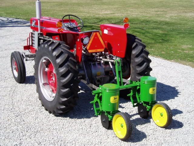

Whatta you wanna know about Massey Ferguson 150's?!?!?!? They're my choice as the best tractor ever built. They combine the best features of the classic MF135 with more heft, better steering, heavier front axle, better cooling system, slightly longer wheelbase, and were standard with most of the options available on the 135. The pictures are my 150. I've owned it since new, in 1971. I wouldn't trade it for 10 NEW tractors.
The 150 was built from 1964 until 1975. They sold ONLY in the North American market. (The balance of the 100 series sold in HUGE numbers worldwide) In "average" condition, they'll bring $4500 to $6000 here. $4500 for a very nice one would constitute a bargain in my eyes. Toss in a mower and it becomes a REAL bargain.
Post or PM me with a serial # and I'll tell you what year and approx what month it was built.
Diesels are worth a little more than gassers, but the gas version is a great tractor too. They were offered at various times with either the Continental Z145 4-cylinder gas, or a Perkins AG3-152 3-cylinder gasser, in addition to the Perkins diesel.
If you decide to pull the trigger and buy it, I'll walk you through every step of the way to learning your tractor front to rear. I've got several binders full of manuals, tech "updates" for the manuals, and even the entire set of MF sales literature from the days when the 150 was new.
