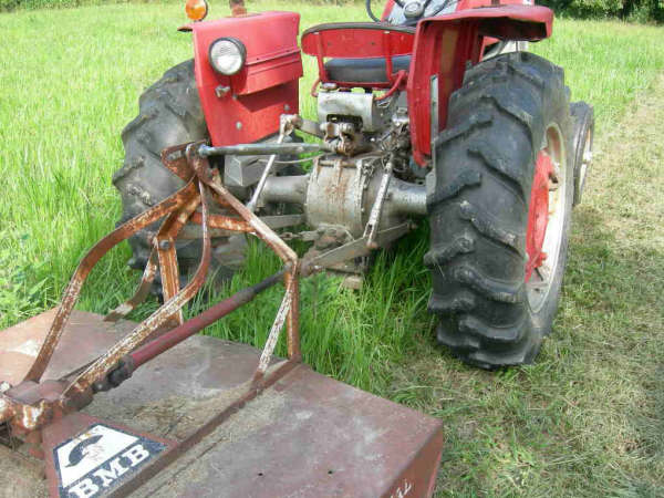

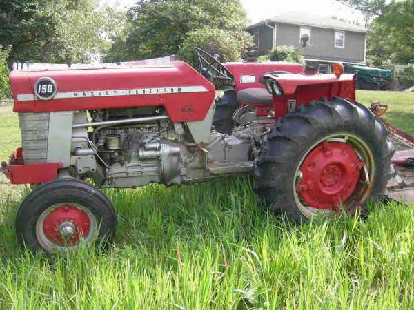

These are pictures that the seller sent me. I called the owner and left a message to say i wanted to see it. I hope he hasn't sold it, it is a continental gas engine and I also asked for the serial number. It's a little bit of a drive and I really appreciate all your help to determine that it is worth the time. FWJ I will definitely take you up on the offer to tell me how to run it if I get it.
Thanks
   / Advice on Tractors for a City Girl #33
It looks intact. It's been repainted at some point. If it was repainted as it was originally, it's 72 or older. Battery cover was 2-toned until 73, then solid red, 74/75 models didn't have silver rims on front wheels. (Both "cost reduction measures" from factory) Most repaints end up with silver rims. Very seldom do I see repaints with battery cover 2-toned, even on older models. All mechanical items appear to be original. Sheet metal still straight. Lots of small details still there. (correct rear light, remote flasher light socket under rear light, all original gauges, OEM top link, original Float-Ride seat, OEM fender mounted toolbox, ect) Looks like a 35 (+ or -) year old tractor, but not one that's been abused.
Serial # should be on a small metal plate, in front of the shifter levers, attached to the lower part of the dash.

That's a clean looking tractor. Engine, tranny and rear end look pretty leak-free.
My 1964 MF-135 diesel was in pretty shabby condition when I bought it in July06.
I'd verify that all the gauges work OK. Oil pressure and temperature are the two that need to work.
That mower probably has seen better days, but you won't know until you take a look at the blades or give it a try.

S/N says it was manufactured in late 1966. Looks pretty good for a 42-year-old tractor.

I don't believe in owning a tractor that DOESN'T earn its keep. The 150 spends 200+ hours a year bush hogging, plus mowing, raking and baling hay off of 45 acres. It plows the garden and usually a 5+ acre patch of corn for a corn maize our church puts on. MOST of the pictures were taken just after I finished the restoration, but I've kept it clean since.
Twofoolsmet, Serial# indicates mid to late '66. Standard chassis, Gas, multiple disc clutch. ('67 and later had "9A" prefix on serial#'s)
