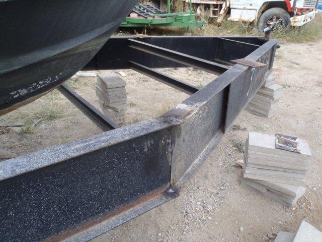

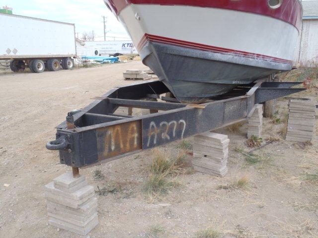

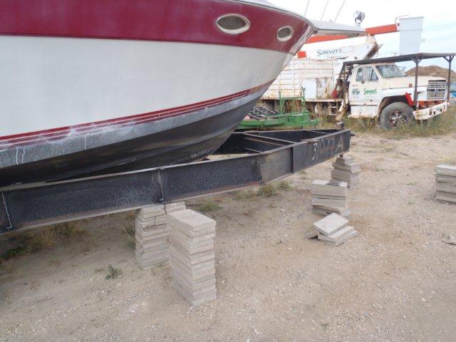

here is where I am thus far, I will get some 6011 tomorrow

I sure hope you're planning on welding in some good solid patches over those high stress areas.
Maybe adding some grade 5 or 8 bolts to it as well. :thumbsup:

That's exactly what I was thinking/ would do. Overlapping plate each side of those butted joints. That is a nice big main frame to work with.

I am just a farm welder but have to agree about "fish plating" all of the butt joints. There is going to be a tremendous amount of stress on the entire trailer with all that weight, especially in turns. Even a once a year trip to the lake will be a disaster if one of the welds fail.
My original thought when the post was first put up was that "if you have to ask what rod you probably shouldn't be doing it". Not meant as an insult just as a precaution. Maybe I've been reading Welding Web too much.
Speaking of that, try posting the project over on Welding Web and see what they say.:confused:

Thanks for the comments, I do lots of mig welding but I know the welds look good but the penetration is the pits, I have got a couple boxes of 6011s today, played a bit vertical welding on scrap and figure its not that bad.
Now regards the fish plates, I have several plates in 3/16 steel sheared to put on the flange where it is butt welded, also got several pieces to weld in place over axles like the original see the front side.
also got some lazer cut gusset plates to weld on the top and bottom flange and will be adding several braces between the rails to replace the light angle they used originally.
Today also cut out the front axle and moved the outer 2 closer to the middle one, this will give a better turning action, tomorrow will see what weight is on the hitch, want around 750 pounds, this should be fine.
